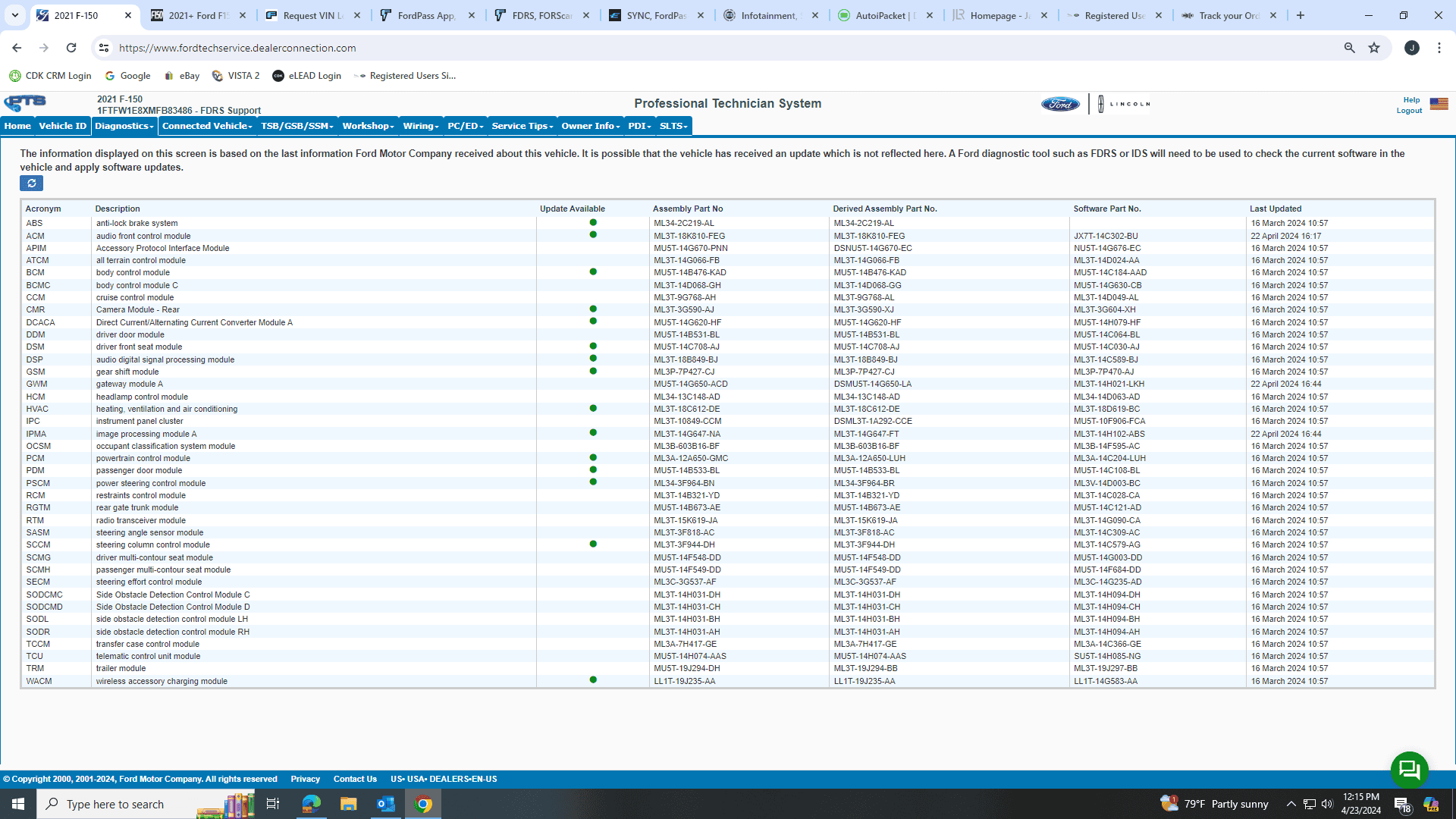

If there is no active OTA trigger pending for the vehicle, it will always say it is up to date (or show the info of the last update it got if it got one). You can't guide yourself by that. This pdf from Ford shows what each vehicle's latest Sync version should be based on year and platform and is mostly accurate.It's never gotten an update released to it, I've found a few others online with similar vins and being on the same sync 4a 4.0.22277 and no updates. Sync indicates it's "up to date"
