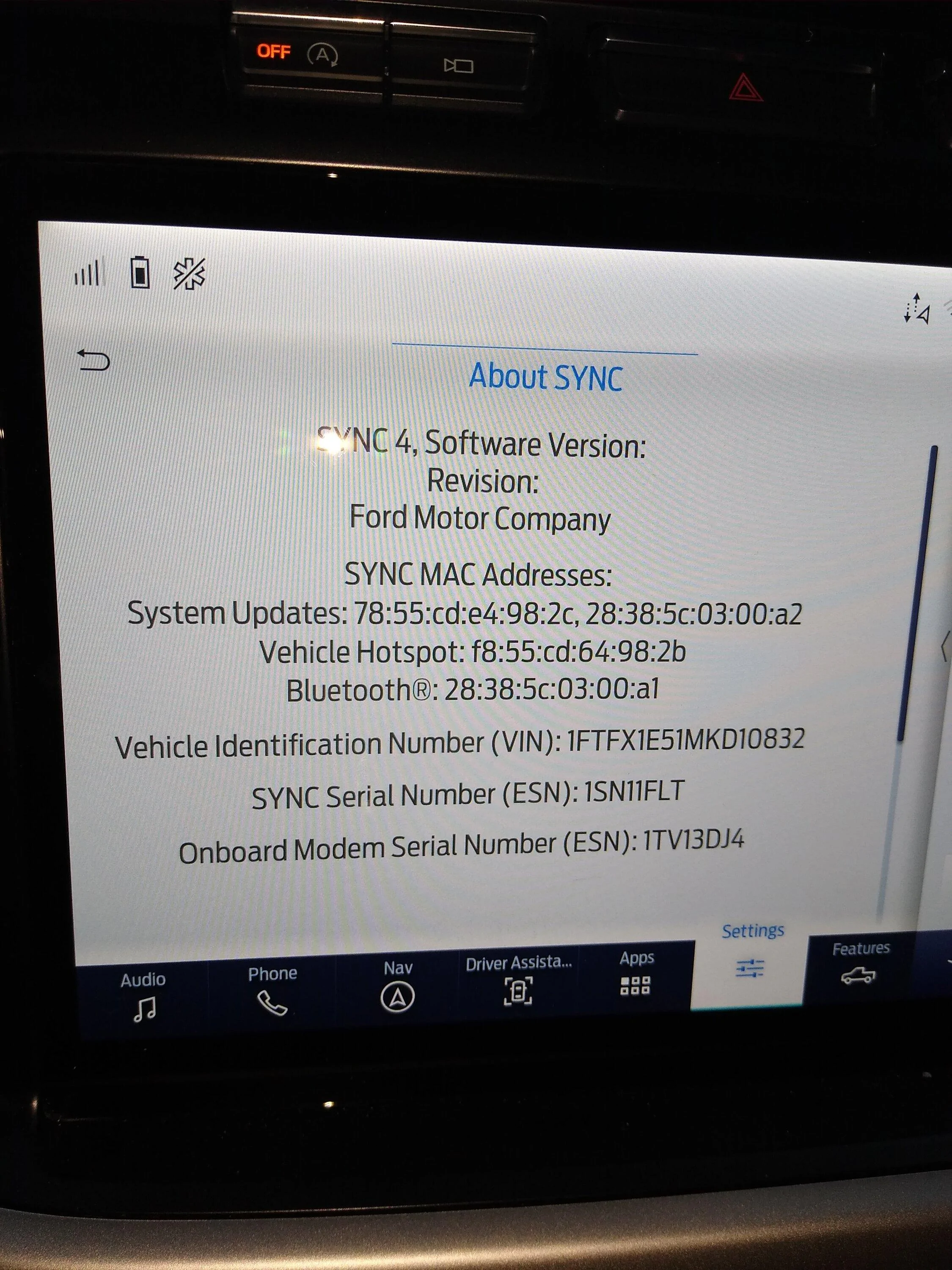

@rugedraw can you check and respond to @DansFord here. He needs a fdrs check I'm sure! stuck on 1 7.1 vin in picture below.
@DansFord Your truck is on Sync 20301 which is old software from 2020 known to break the OTA process. Your dealer needs to manually update your APIM or diagnose it as faulty and replace it with a new one. Otherwise, your truck will never get any updates.
