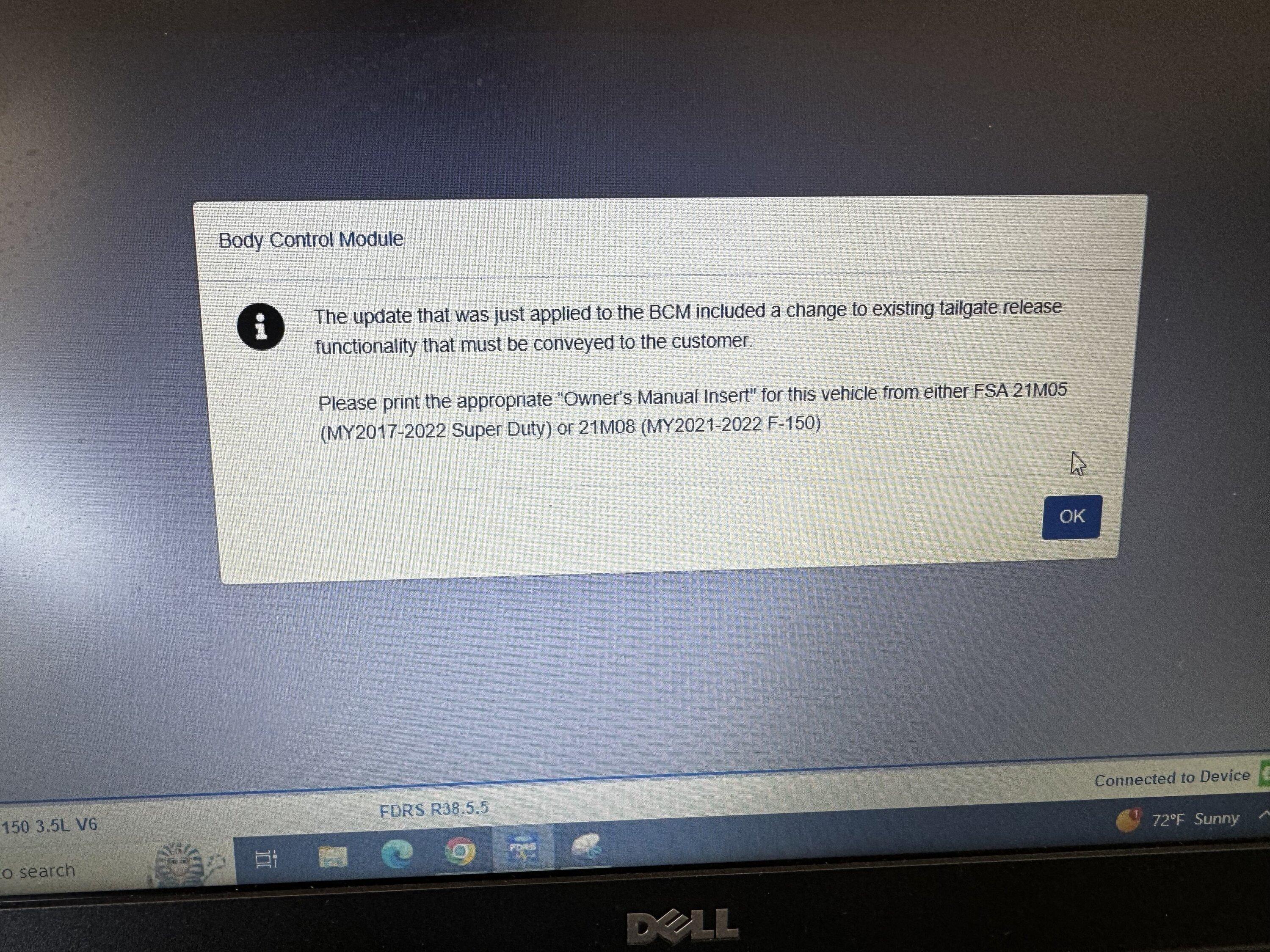

I borrowed a mongoose cable and I’ve been updating all pending modules but APIM is throwing an error Could you please take a look how?
And thanks for all your help.
Not an error.
Now you must push tailgate release button two times inside cab or at tailgate.

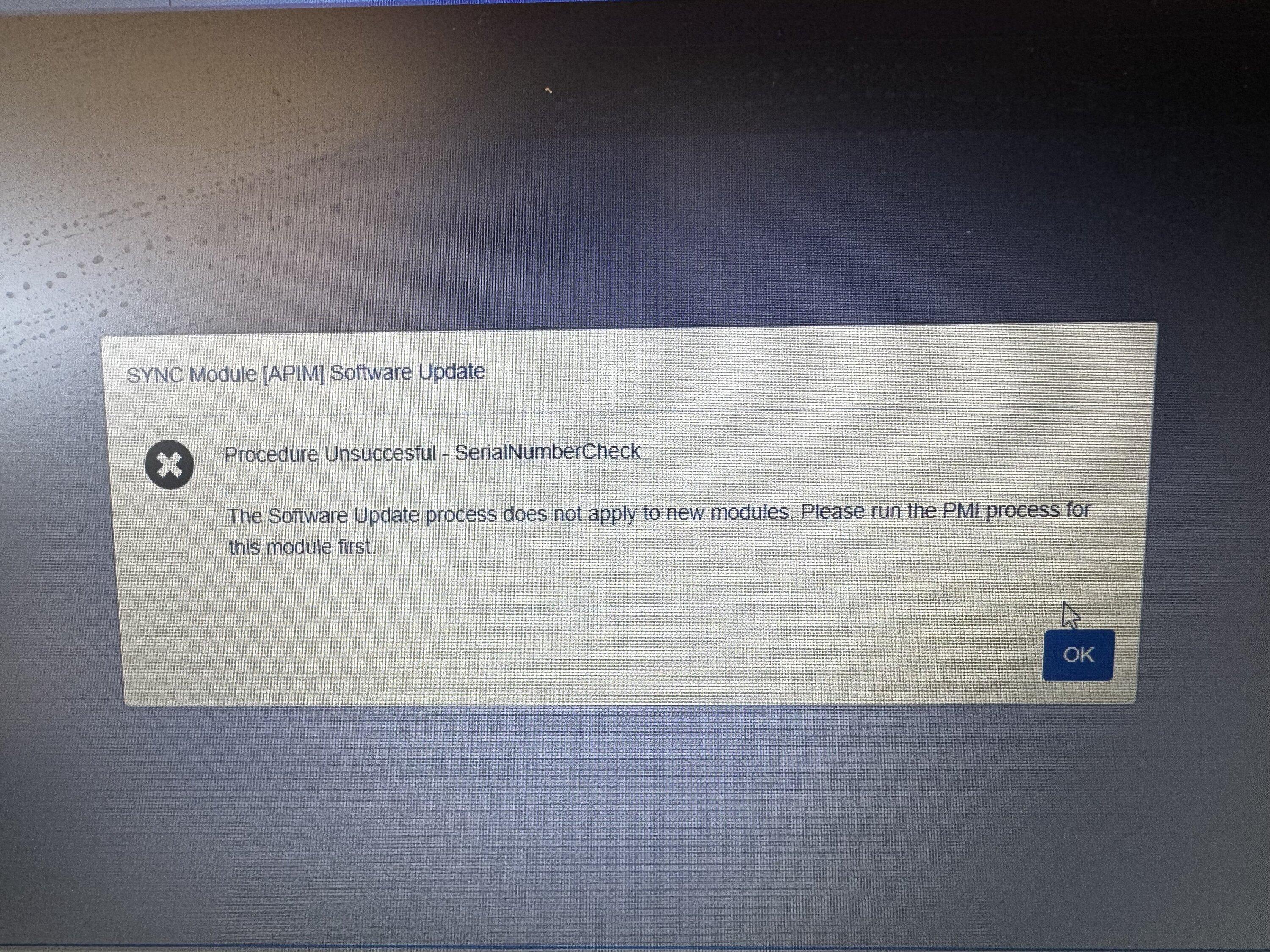

My apologies this is the right screenshot with the APIM error during the update
I'm not an expert, but I would try doing PMI as it is telling you to do.
I really don't know what that does, but I don't think it is harmful.
My guess is it might help get Ford updated with what software version you have installed? I know it's supposed to be done for any new modules to get asbuilt data downloaded etc.
