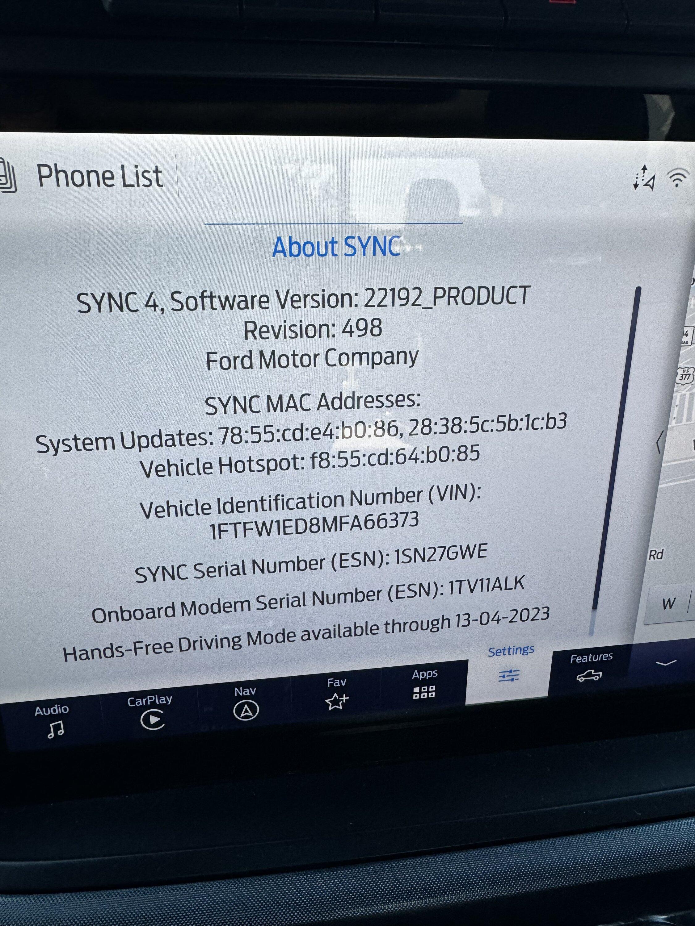

I see they replaced the APIM on 10/18 and performed the PMI, so I am inclined to say they did it correctly. However, it does seem like your truck has synced up with Ford since then and all your Sync data is blank on Ford's servers, so I am limited as to what I can see in your case. Post of a pic of your "about sync" screen. For some reason, your truck does not show the 21G01 campaign for bluecruise programming tied to its VIN.

Based on your Sync version, you should have bluecruise. Does your odometer show a decimal point in the mileage? Example 12345 miles or 12345.6 miles?
Did bluecruise work before and no it doesn't, or it has never worked?

@rugedraw Am I wrong thinking his BC expired on April 13, 2023 from what is on his screen.

lol I hadn't noticed that. It depends on his response. If he never had BC activated, the free trial should have started.

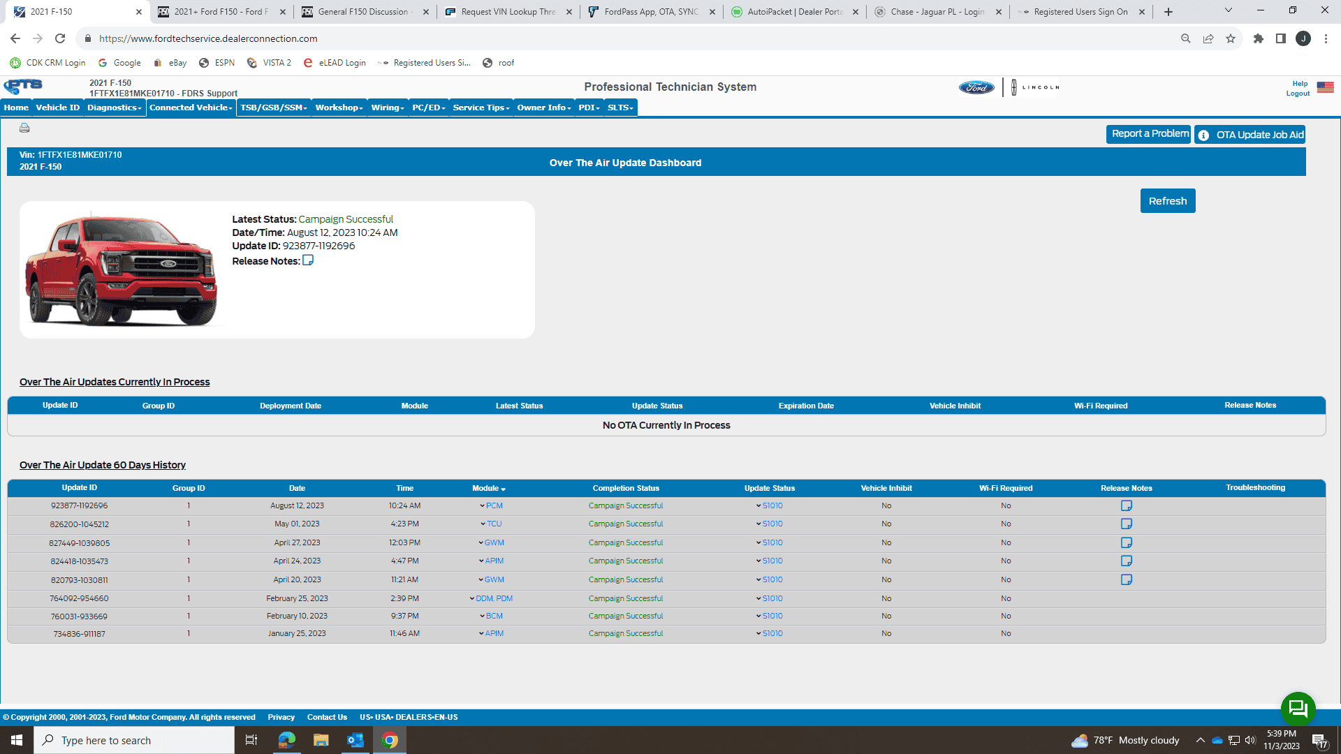

Side note ... my truck is still showing the last update failed...Does PTS still shows it passed?

Yup. Nothing but green.

@Kanuck My truck is doing the same as yours, but the opposite. My touchscreen says the PCM update went through, but PTS says it failed. Go figure.

Strange for sure... Would PTS not show updates that were done with FDRS? I have used FDRS on Sept 22nd to update my ABS and on Oct 13th I updated the APIM, GWM, IPMA and TCU with FDRS. These should show as completed? I wonder if because my truck said the OTA failed, it has stopped any OTA's being sent.

It would show it in vehicle history, but not in the OTA dashboard.
FDRS supersedes OTA. If you installed it via FDRS and the OTA trigger was created for your truck before your truck synced up with Ford, then the OTA will fail because your truck already has the update being sent to it.

Makes sense... but PTS doesn't show that it failed.

You can ignore that. Eventually, it will just say the truck is up to date. Just checked your truck in FDRS and it only shows an ACM update pending, so you're good.
my odometer shows decimals like 12345.6
Hands free blue cruise is being never worked.
do you think doing the investment with the cable and the FDRS license I’m be able to do some updates to make this work? Or I have no hope until find a dealer be able to do it?
