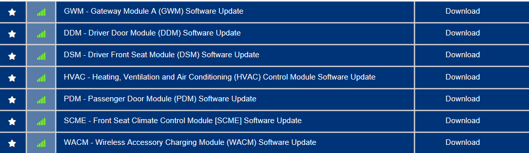

List of modules pending updates for your trucks is below:

THe WACM cannot be updated via OTA. The SCME is a module I have seen in the F150 trucks, so I am not sure about that one as far as whether is can be updated via OTA or not. I am also not sure if the HVAC module can be updated OTA.
There are three important modules that usually require their updates to be installed sequentially up to a certain extent. Those are the APIM, GWM and TCU. It is possible that if the GWM update is applied, that another update will pop up on the list for either the APIM, GWM or TCU. APIM updates are the ones that can get you a newer Sync version.
So you do have modules pending updates, but I am not sure if Ford has OTA packages to updates those module for your trucks.
Edit: A member of the Mach E forums noticed a new GSM Ford released that shows the latest Sync version for all Ford vehicles. None of your trucks are on the latest Sync. You guys are on 22026.
