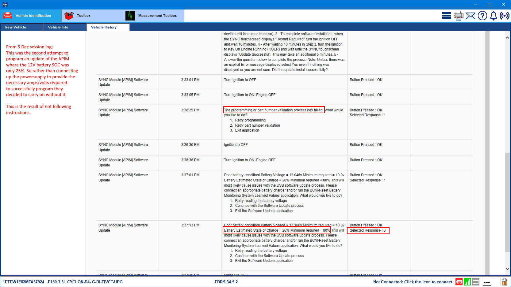

Unsure. When I drove it this weekend, it auto displayed that BlueCruise was not available. Per the map, it should have worked on the Freeway I was on.Here's the list of available updates this morning:
None of these would keep BC from working. They are unrelated AFAIK.
Here's some clues from the 5th of Dec though....
It does appear that they did manage to successfully update the APIM on the 9th of Dec.
