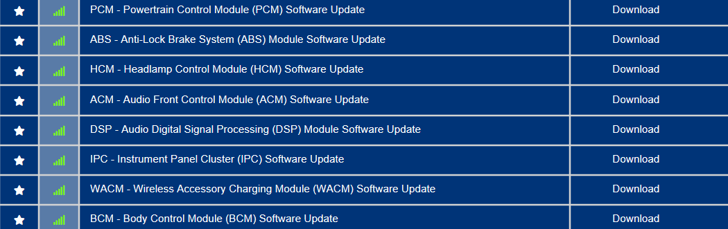

Well, that's frustrating.
Before I reach back out to them, is there any chance this takes a day or 2 to update what you see?
Trying to give them the benefit of the doubt, but I assume this is up to date.
Thanks.
The DSP update was not done. They tried, but it failed 6 times due to a miscommunication error with the VCM tool and the module. List of pending updates for your truck is below including the DSP:
Before you call your service advisor guns blazing, please note that it could the tech who lied to him/her and said the update was done and your advisor does not know any better. The ACM and DSP update are related to the sound system, so those may help with your issue.

With the exception on the IPMA that will take 4 hours, the other updates are quick. Not sure if the CCM is quick or not.....I don't remember when I did mine how long it took.
However, they are not going to perform all the updates because Ford doesn't pay them to do so unless there is s problem associated with your truck that a module update fixes.

Understood. Didn't expect them to update them all, but at least the ones they said were updated.
I guess I mainly wanted to confirm that what you see is current, and doesn't have a time delay to show what's been updated. Hate to call them out and find out that it was actually done. Ha ha
Sounds like it is, so I guess I'll send them a message and see what they say.
Thanks.

No, what I can see is in real time. In this case, I feel comfortable saying that the list of updates I provided are 100% accurate because FDRS history clearly shows the DSP update failed every time they tried it and it does not show any attempts to update anything else.

The last update you got was the one that brings you up to the latest SYnc 23159. It updates the digital owner's manual. Ypu're still missing some preparatory updates, but nothing that gives you anything new. The DSP update you want is in your list of available updates below:
However, at least one member here who got this update reported the same thing happening again after the update.
