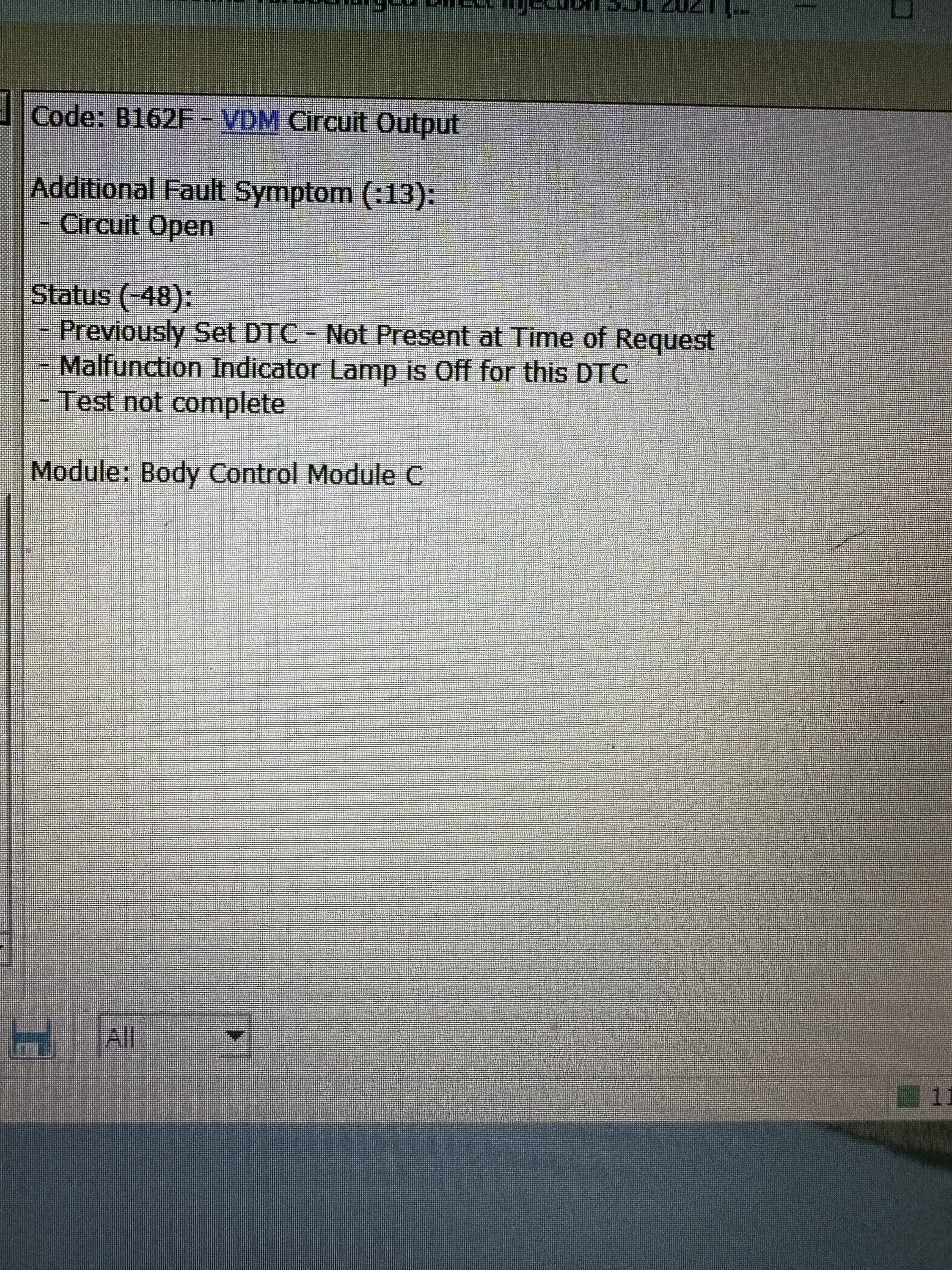

if I could bug you once more, can I ask about any active DTCs? I had an SSM done a week ago for my truck for B162F code and they said they finished it after maybe 5-10 minutes. I still see the same DTC on my forscan as “not present at time of request” Today. I’ve driven it quite a few times in the last week so I’d figure it would have cleared in its own by now. If I clear it myself it just comes back.

Ok thank you very much. If I still keep getting that Vdm open circuit DTC should I take it back to the dealer? There was an SSM they completed to remedy that DTC so I’d figure that would go away afterwards.
The DTC your truck is recording is the one that SSM 51160 is supposed to fix. FDRS vehicle history shows they performed the correct procedure as per the SSM's instruction to correct it. You can take it back if you want, but I wouldn't. Again: If your truck is running fine and you have no lights on your dash, then enjoy your truck and don't worry about it.
No sir no issues other than second guessing myself if i do or do not feel a difference in damper mode settings which is apparently a symptom of that B162F code. As always, thank you! I’m assuming none of those lingering DTCs would prohibit a sync update?

I could reset VDM via forscan, think it’s worth a shot?
I can't find that DTC (B162F:13) in an 18,000 page manual. You have me really curious.
I have monkeyed with my VDM AsBuilt a bit and never even gotten a code related. (messing with CCD damping)
The good news is that DTC isn't a live condition. It was momentary and historical, if I understand it correctly.

I reset the VDM and did a reset all DTCs. Everything’s beautiful green checkmarks now but time will tell. Either way it is what it is truck is just fine. Wouldn’t even know about these DTCs if I wasn’t digging
