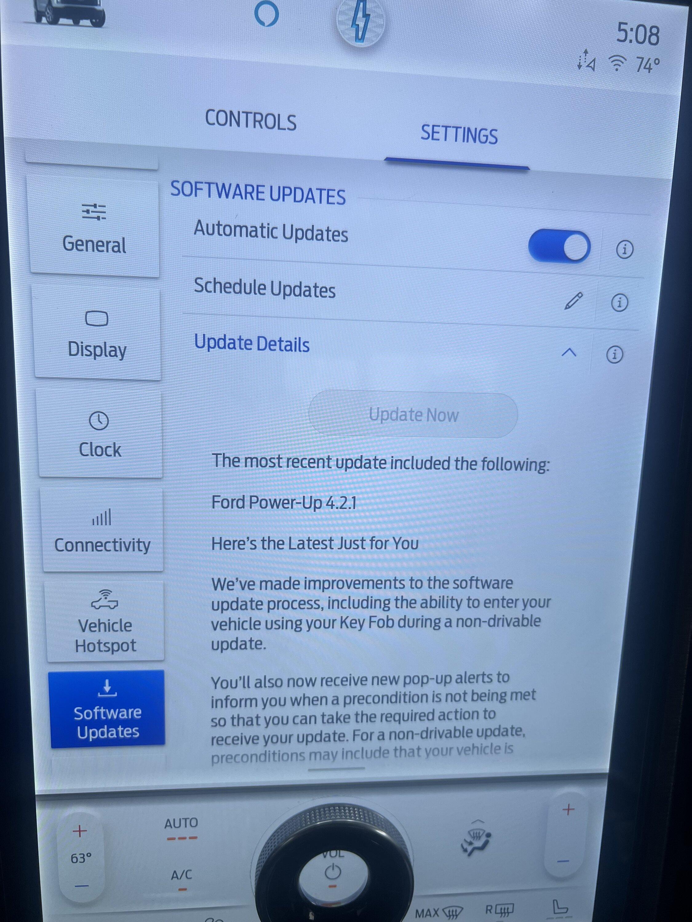

Hoping for some help. Picked up a used 2022 Lightning Lariat and it appears to be way behind on updates. Would anyone be able to run my vin and offer some guidance on what to do?
VIN: 1FT6W1EV2NWG04401
Attached pics showing current Power up and Sync.
I am not familiar with the Lightning updates as I am with the ICE F150's. I am not sure what the latest Sync version is for your truck. Sync 22228 is about a year old software, but 4.2.1 is a relatively new OTA that was first pushed out to the ICE F150's six months ago. On the ICE trucks, 4.2.1 was followed by a few other OTA's that did give our trucks a newer version of Sync, so maybe the same is true for your truck.
I can tell you the following update has been sent to your truck 4 times between February and August. PTS says it failed due to low battery SOC:
Ford Power-Up We’ve been busy working to make your experience the best it can be. Distance-to-Empty Improvement We updated the software on your truck to improve the accuracy of distance-to-empty measurement. Ongoing updates like this help you enjoy the best possible version of your F-150® Lightning™ truck. Priority Update 22-PU1009-MIL-DTE
The OTA trigger is expired now, so you have to wait for it to be resent again. There is no way to trigger an OTA being sent to your truck from Ford.
