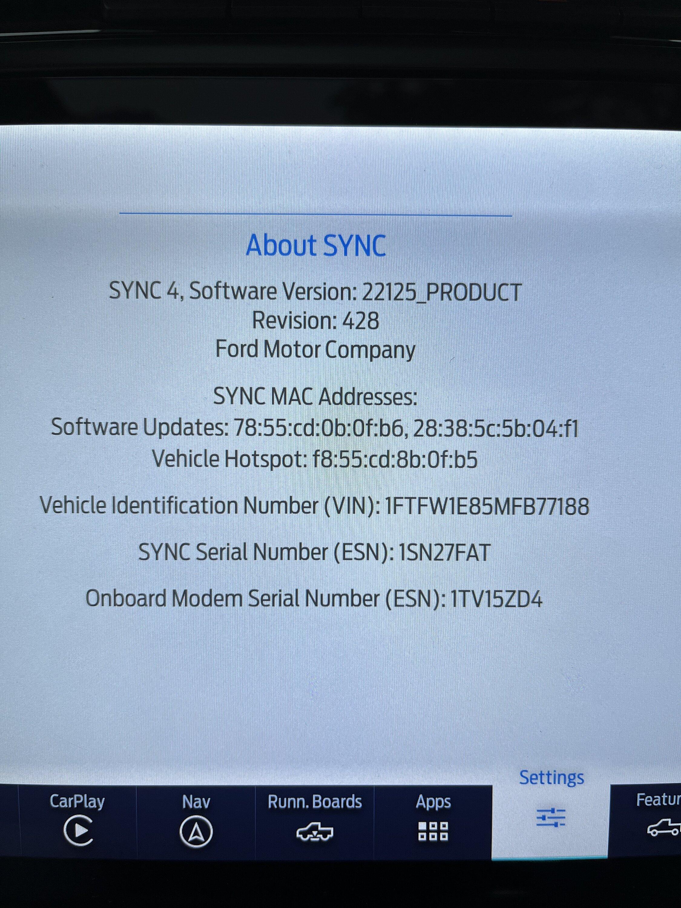

Hi and thanks in advance for any help/information. My truck recently had what the dealership called a "corrupted APIM." It would not load correctly into the truck and was locked out of OTA. When I got the truck back from the dealership I got a FDRS license and tried updating modules. I spent about 9 hours updating different things- but could not get anywhere with the APIM.
Yesterday the dealership installed the long awaited third APIM, said congratulations, and gave it back to me. But it seems to be behind still as far as sync versions/ updates go.
Software Version: 22125_PRODUCT
Revision: 248
VIN: 1FTFW1E85MFB77188
Could anyone offer me some insight into if there is any update waiting for me if I were to get another 2-day license to try and update?
Can you post a pic of the ABOUT sync screen.. what I see shows you are at 21146 which would be correct.
If you are at 22125 then you have a ig problem

I am going to send you an update. You need to install it ASAP.. If you leave it at that youll be screwed indefinitely

Thanks to both of you. I got the files downloaded to a usb formatted exfat and started the process as directed. It detected the update and then said "updating" for awhile. I walked away while it ran and checked in a little later. Notice said "3 update failed."
I'll take the advice to leave the usb in for an extended period of time. I am also downloading the zip file again to make sure it all downloaded correctly.

Yeah If you got that then you have an issue. That is probably why the dealer gave up.
If you wanted to I could swap the APIM out for you to one that is at t he current level that you need it at. Otherwise youll have to fight with the dealer..

See attached. On the third line where it says CIP, the software on your truck is from 3/18/2021 which is the same date your truck was built at the factory. Your truck has never recorded an OTA and is on Sync 20301 which is faulty software from 2020 known to break the OTA process.
