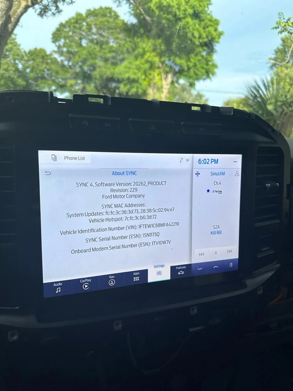

I just purchased a 2021 3.5 EB and have found that it has never received an update. I just did a 12 inch screen upgrade and retained my original APIM. Can you show me what modules it says for my vin? Thanks!
vin:1FTEW1C88MFA42219

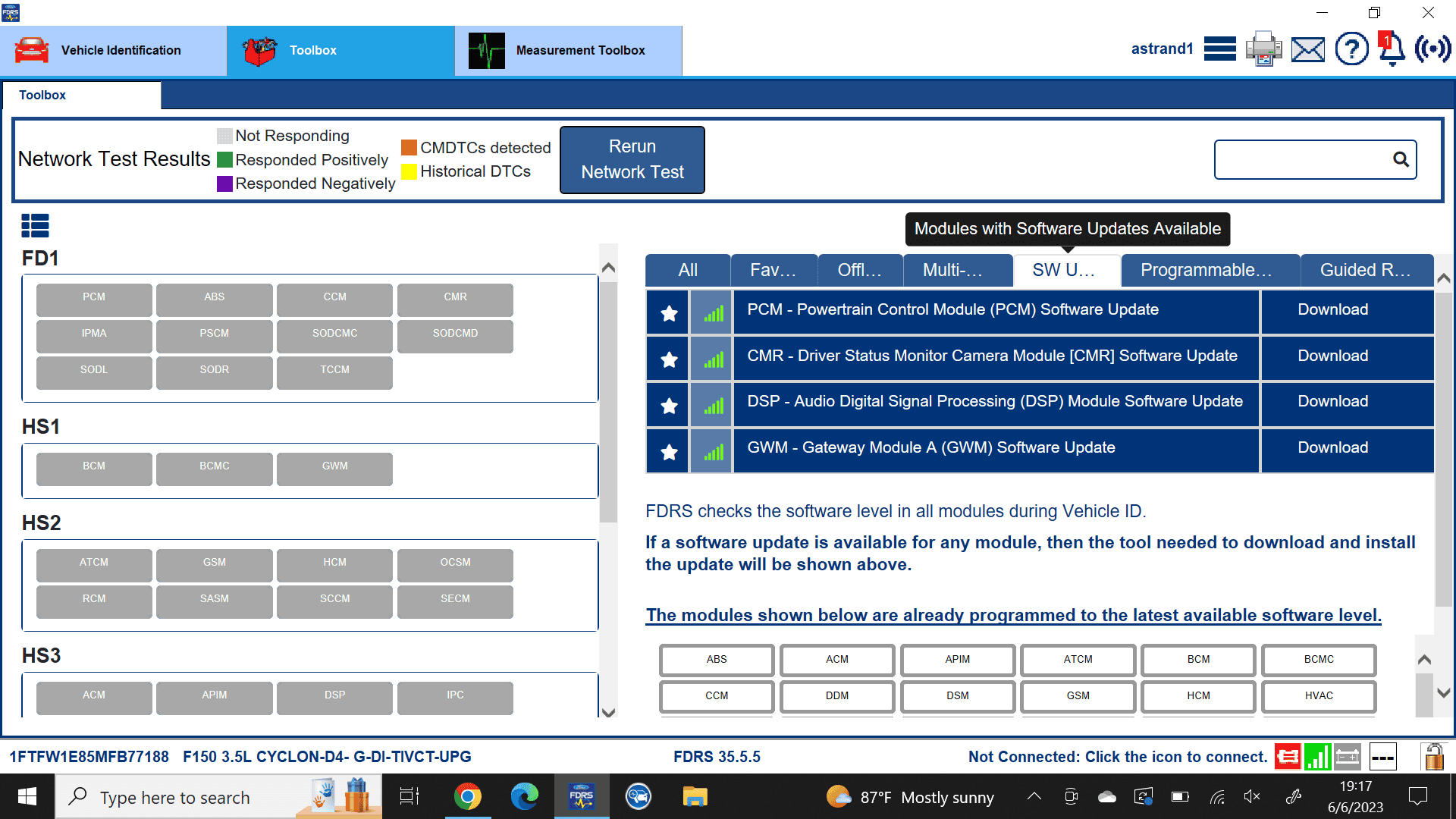

Thanks! Could you scroll down by chance to see what the others are? Do you think I could knock this out in 2 days with a mongoose?
I’ll check yours again but I’m pretty sure that’s all of them. I usually size it to show all updates.
Just checked. That’s all of them. What’s below is all the other modules that are up to date already. And yes I think a 2 day pass will get all those done. You don’t have any big as in long time ones showing. But having said that sometimes when you do updates on FDRS others will pop up but 2 days should get it done.

I wonder why it’s not showing an APIM update because I’m still in the factory sync version.
20262_229
