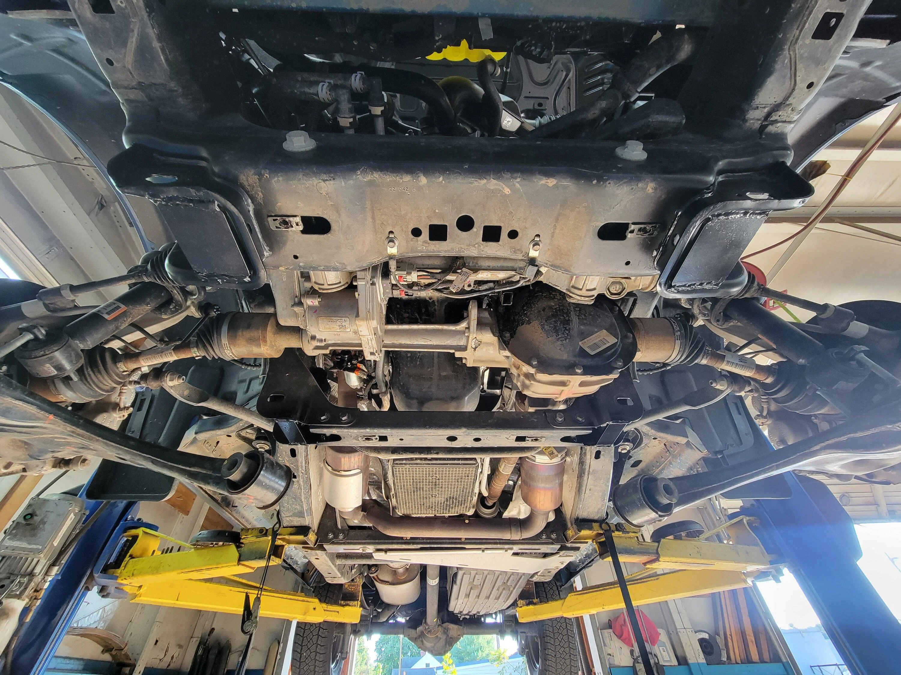

That last wheeling trip left some damage!
Ford F-150 Regular Cab SWB build 20220914_083801
No problem
Ford F-150 Regular Cab SWB build 20220914_174758
I spent about an hour carefully straightening the lower part while keeping the upper half straight, made 4 gussets, pulled both control arms loose, welded, and painted.

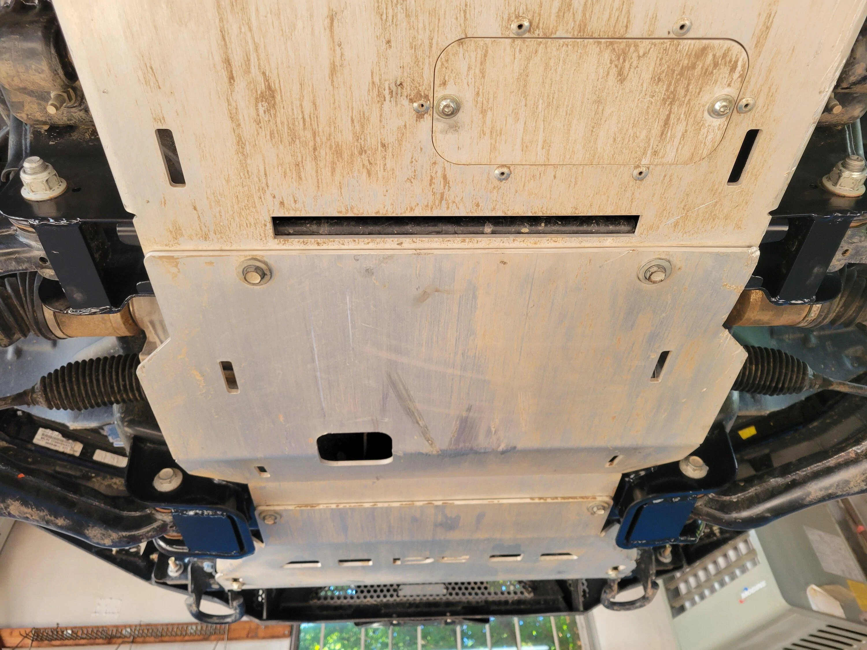

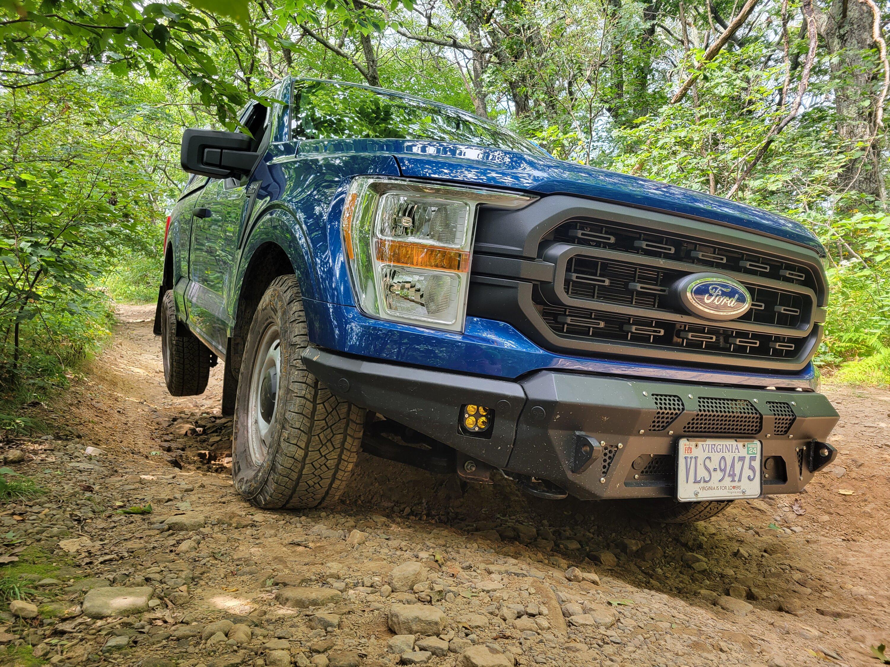

Still liking the bumper? Can we get some more pics? Thanks
Still Loving the bumper! I'm still thinking at some point to fabricate a winch mount to bolt between the bumper and frame. So much open room in there. This pic was posted previously here but I'll be running more trails before the Overland Expo East and a week after leading the Off-Camber Crawlers Annual Fall Foliage Trail Ride. I should have more pics after that.

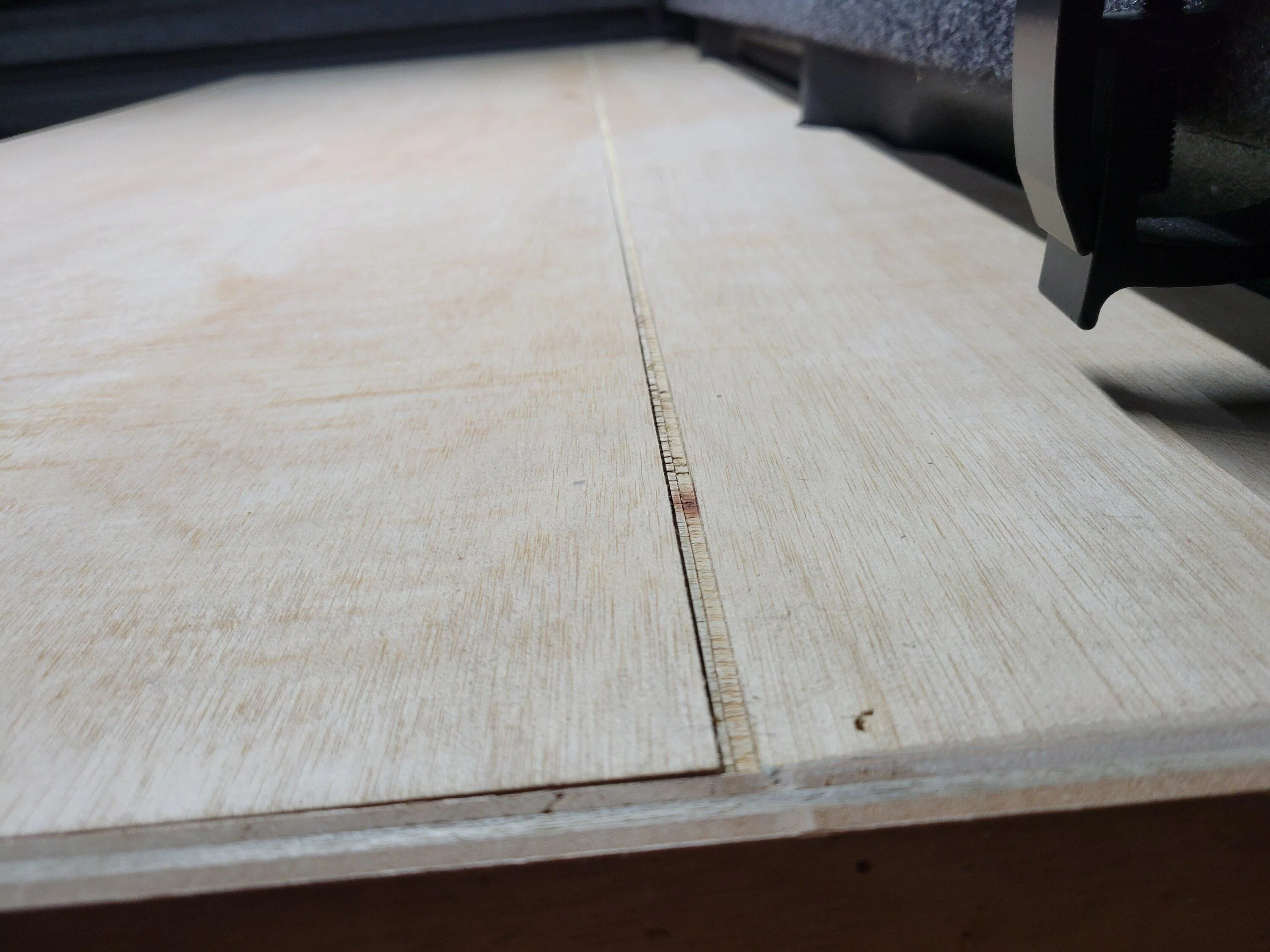

I started on the bed box this evening. Made good progress.
Two sheets of 1/2" sanded ply

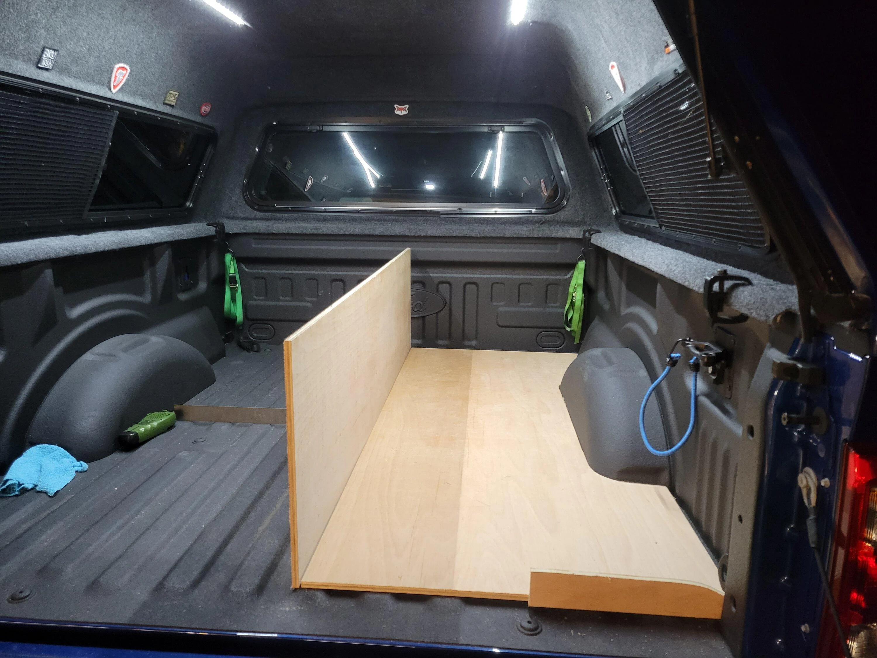

Bottom and using the piece to be cut into the ends to size up space used.

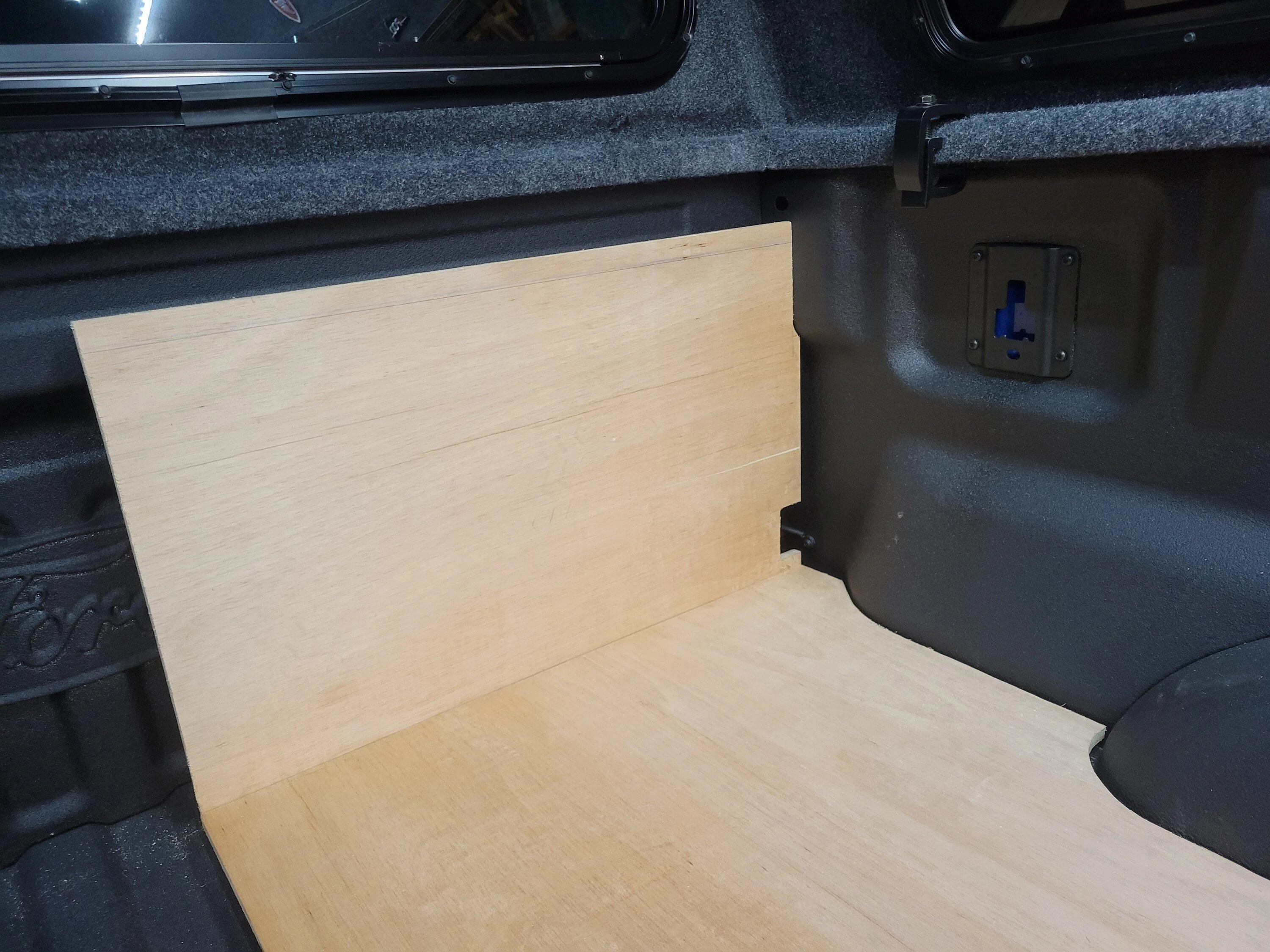

End pieces cut and trimmed to fit the sides and clear the tie down points.

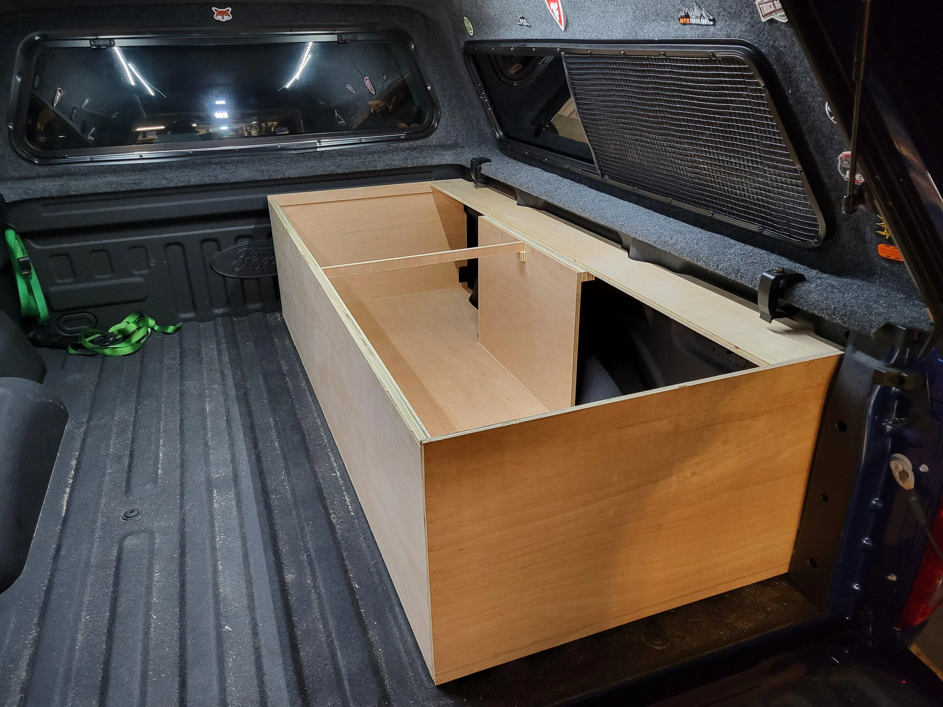

All the main boards are cut nailed and glued. The narrow top piece needs to be shaped to the bed side, nailed and glued to the main body, and piano hinged to the larger top piece. Also inside trim and support bits need to be cut and installed. Then paint and carpet.
