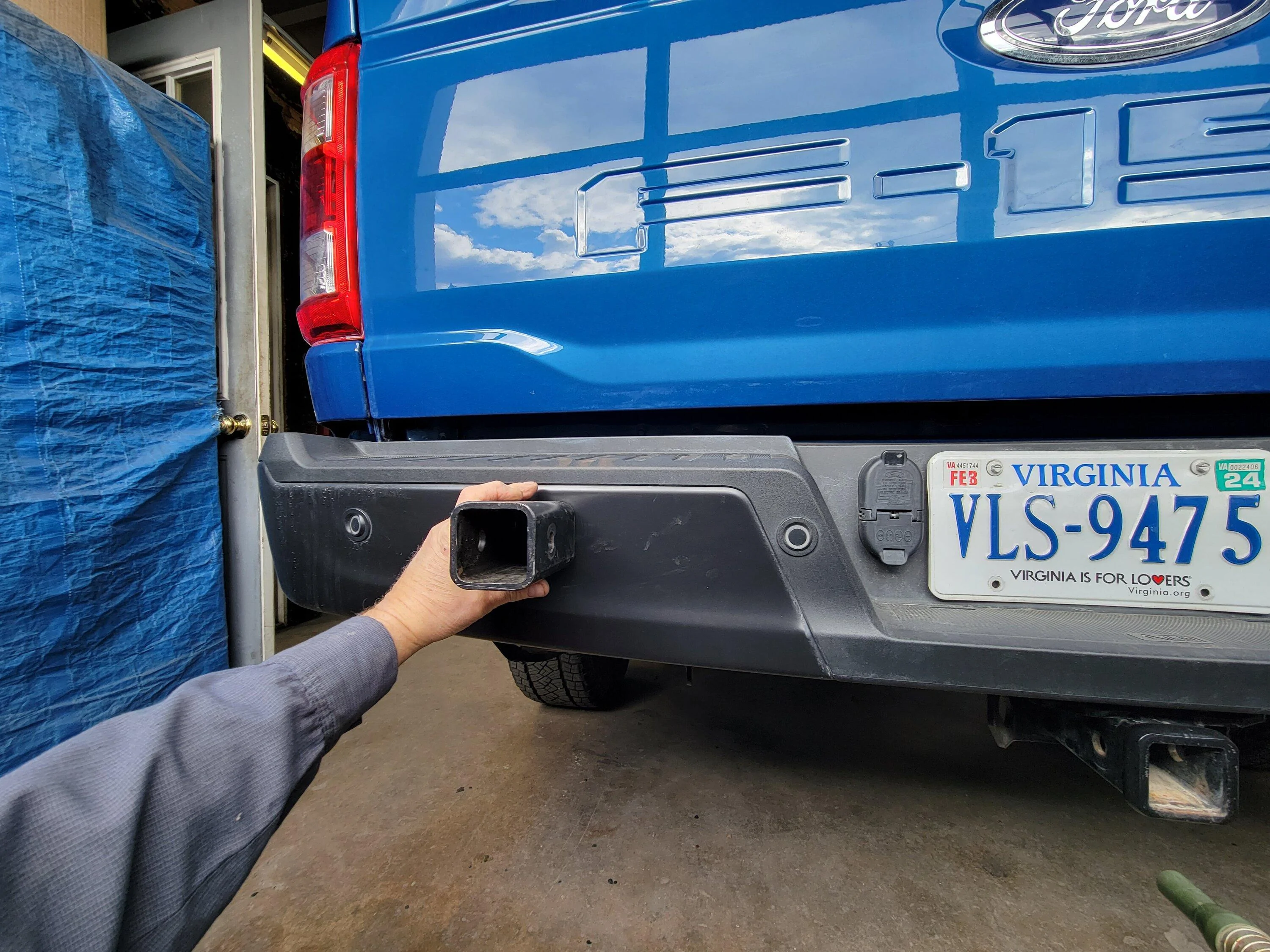

Weld a receiver tube to the factory receiver bar behind the bumper and cut a square hole in the bumper.
Ford F-150 Regular Cab SWB build 20230106_124554
This tube would be behind the bumper.
Ford F-150 Regular Cab SWB build 20230106_124637
And the mount would go into the bumper.

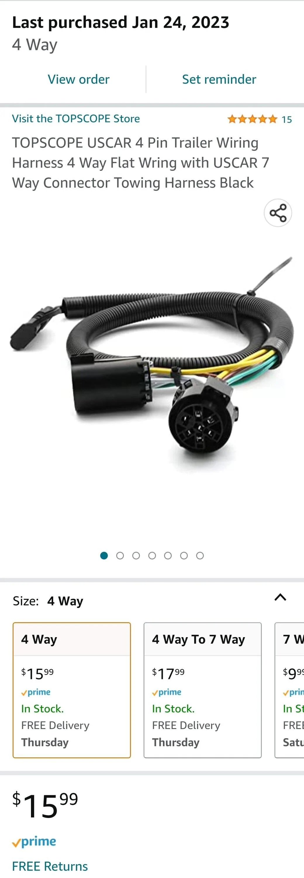

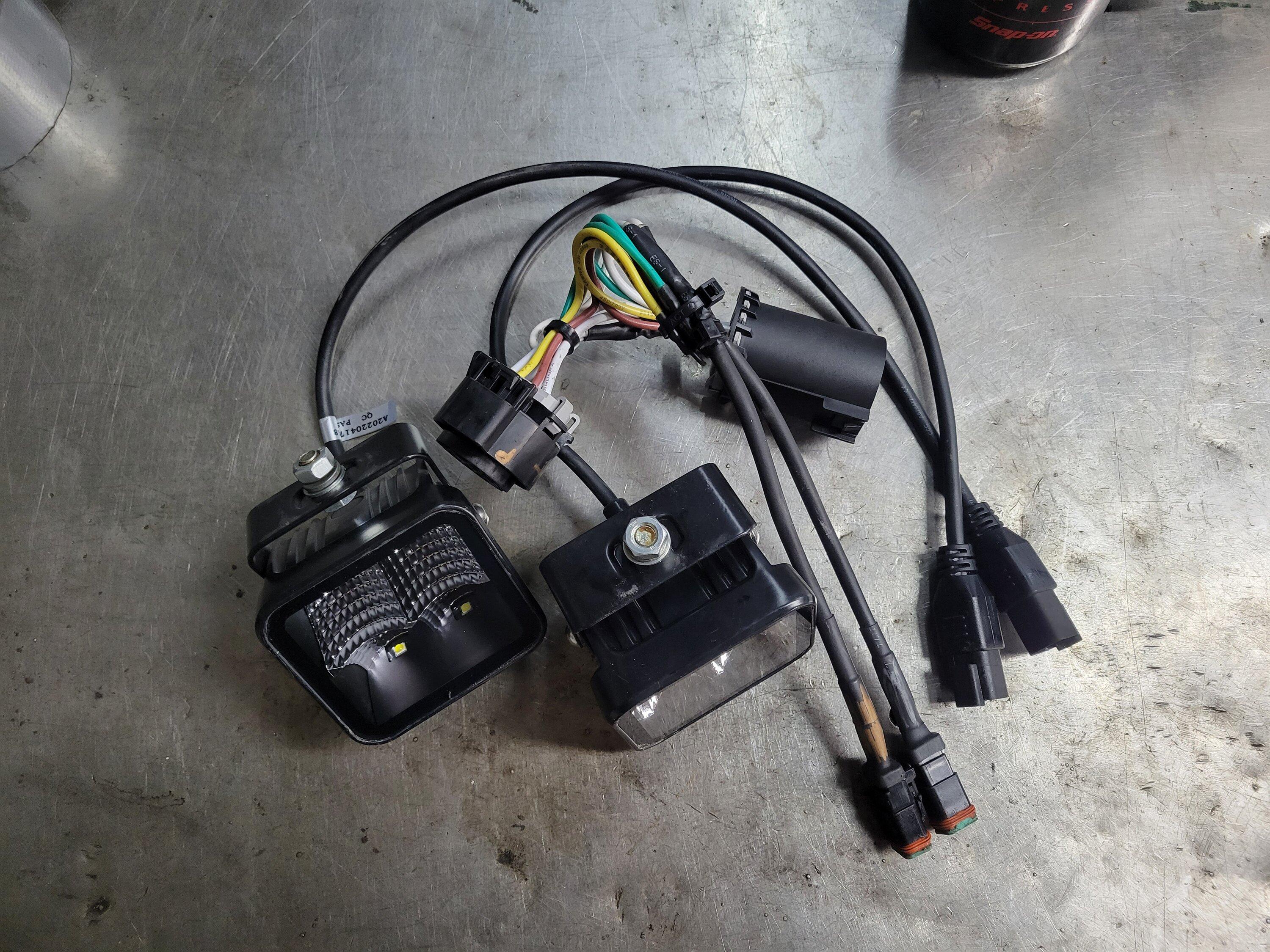

Along with the jerry can racks I will also use the mounts for auxiliary backup lamps. I made a backup lamp adapter from a $16 USCAR 7 pin harness.
Ford F-150 Regular Cab SWB build 20230131_181722
Ford F-150 Regular Cab SWB build 20230131_181749
Ford F-150 Regular Cab SWB build Screenshot_20230131_182751_Brav
Plugged in and tested. Works great!

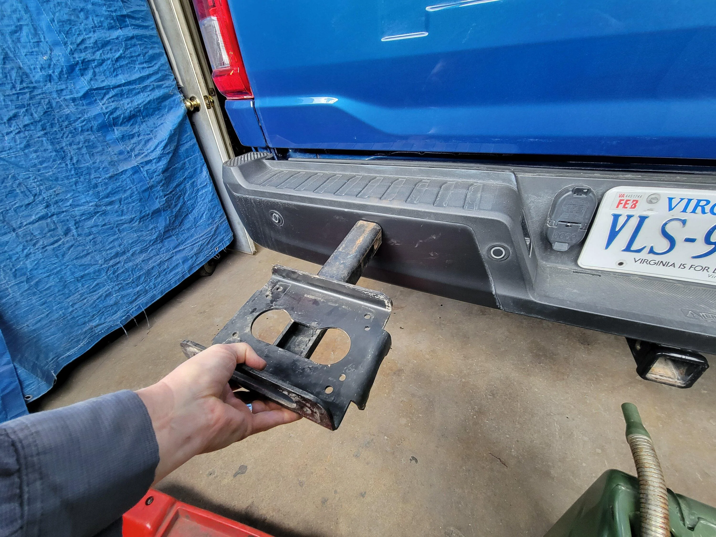

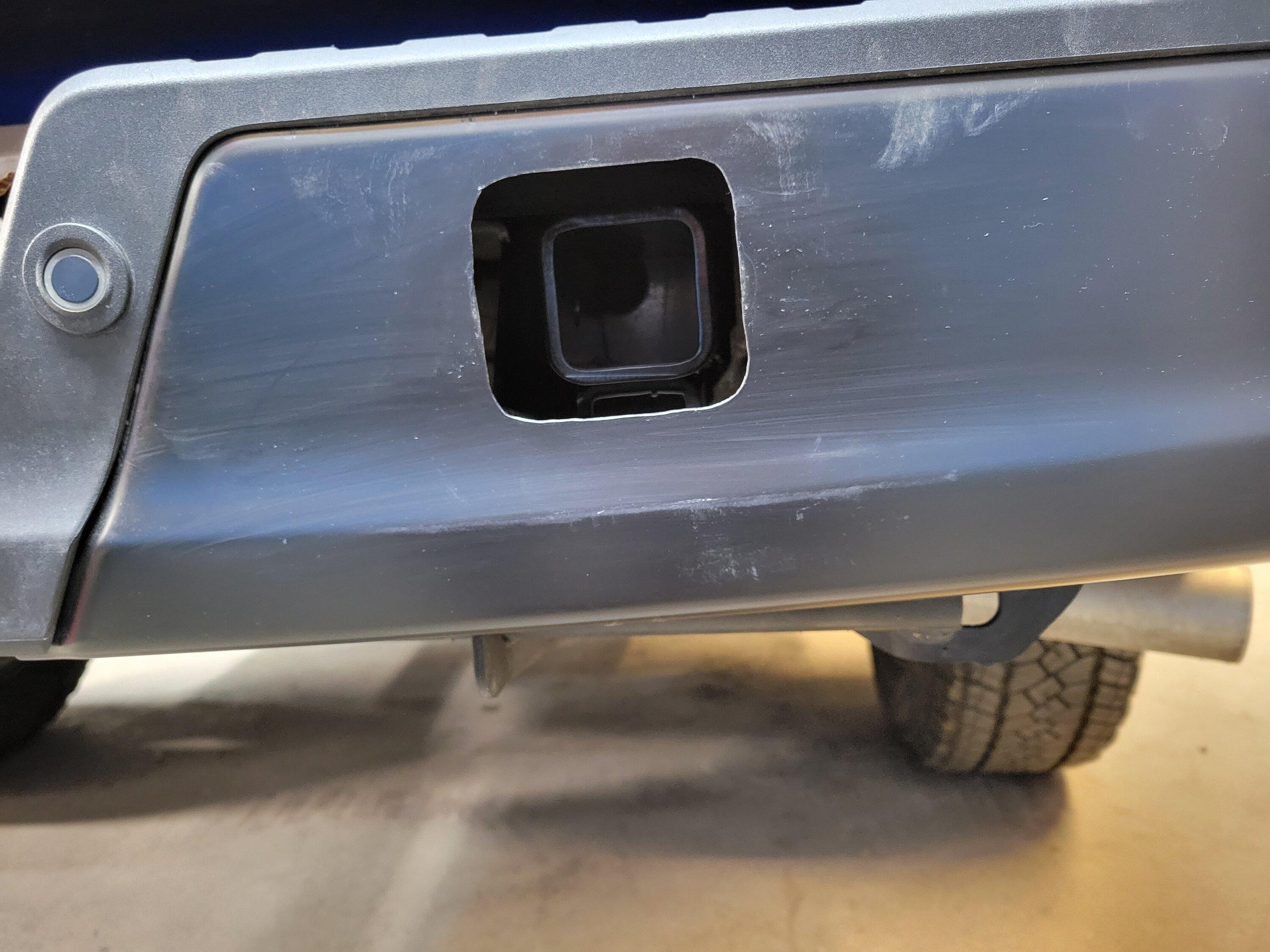

I pulled the bumper/receiver assembly off today. That was easy! Unplug one connector and remove 6 nuts.
Ford F-150 Regular Cab SWB build 20230207_184332
Getting the receiver stripped of the bumper parts was a bit of a PITA. Getting all the retainers squeezed to remove the plastic cover was the worst part.
Ford F-150 Regular Cab SWB build 20230207_182056

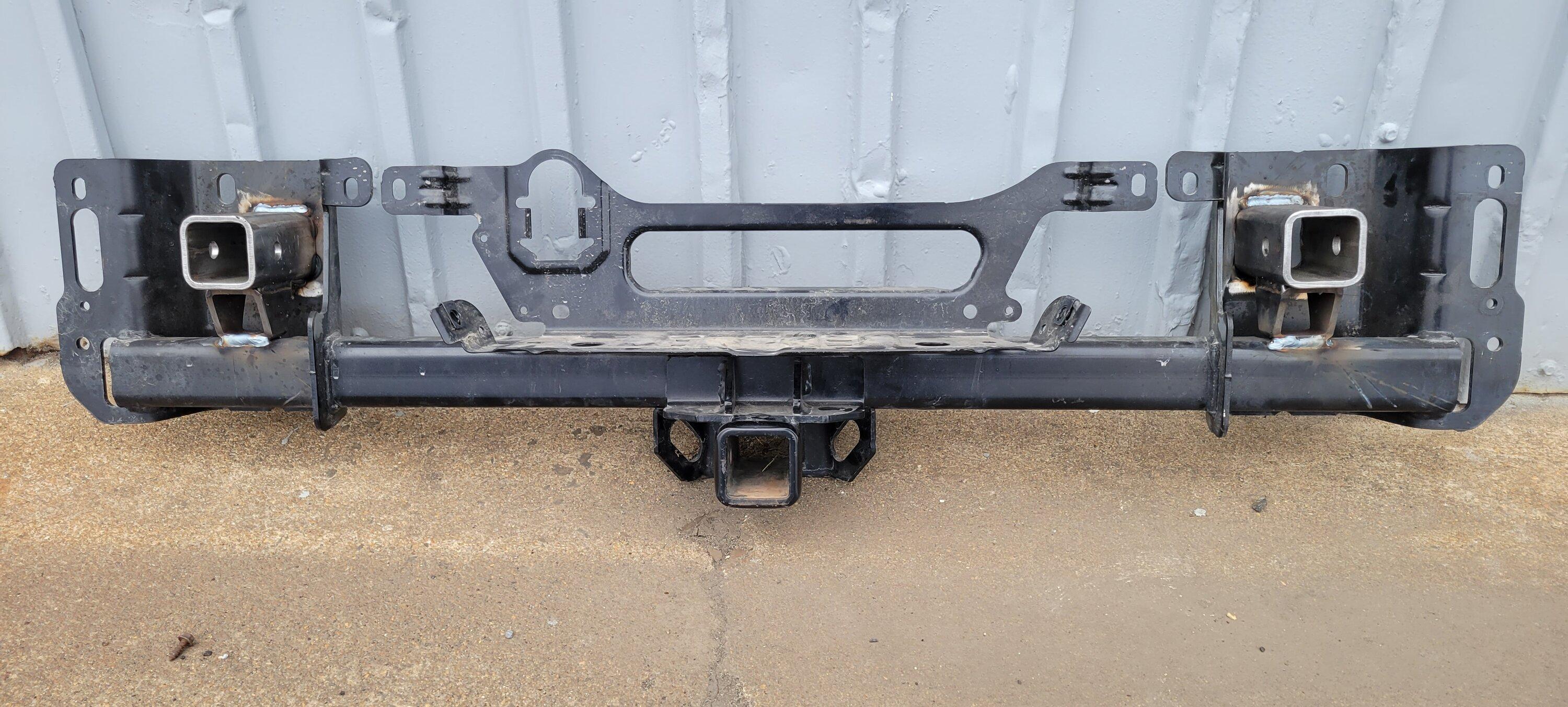

Receiver
Ford F-150 Regular Cab SWB build 20230207_184137
Bracket/2" receiver tubes placement
Ford F-150 Regular Cab SWB build 20230207_181901
Ford F-150 Regular Cab SWB build 20230207_181931
Ford F-150 Regular Cab SWB build 20230207_184054
Approximate location of 3" square hole in the bumper, one each side.
Ford F-150 Regular Cab SWB build 20230207_182013
Gotta make some holes and weld some steel next.

I have two holes in my bumper now.
Ford F-150 Regular Cab SWB build 20230209_201413
hidden 2" receiver tubes
Ford F-150 Regular Cab SWB build 20230209_200923
Ford F-150 Regular Cab SWB build 20230209_200846
Bare receiver after welding the tubes and brackets
Ford F-150 Regular Cab SWB build 20230209_162229
Next to fabricate light pod mounts and Jerry can holders.
