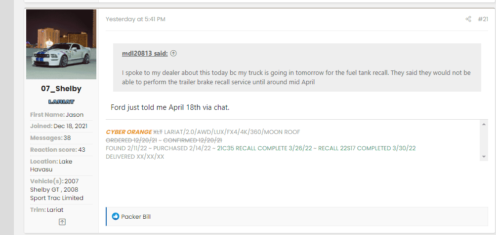

Interesting. I just called my dealer this morning and they scheduled me for 2 weeks from now, but included this recall in the order:
Ford F-150 Recall: REPROGRAM INTEGRATED TRAILER RELAY MODULE (Campaign/NHTSA#
22S17/22v193) 1648830660050
I’m not surprised the software isn’t available now. I would not be surprised if we saw the software within the next two weeks. Both what you and @DT400 are hearing could be true.
