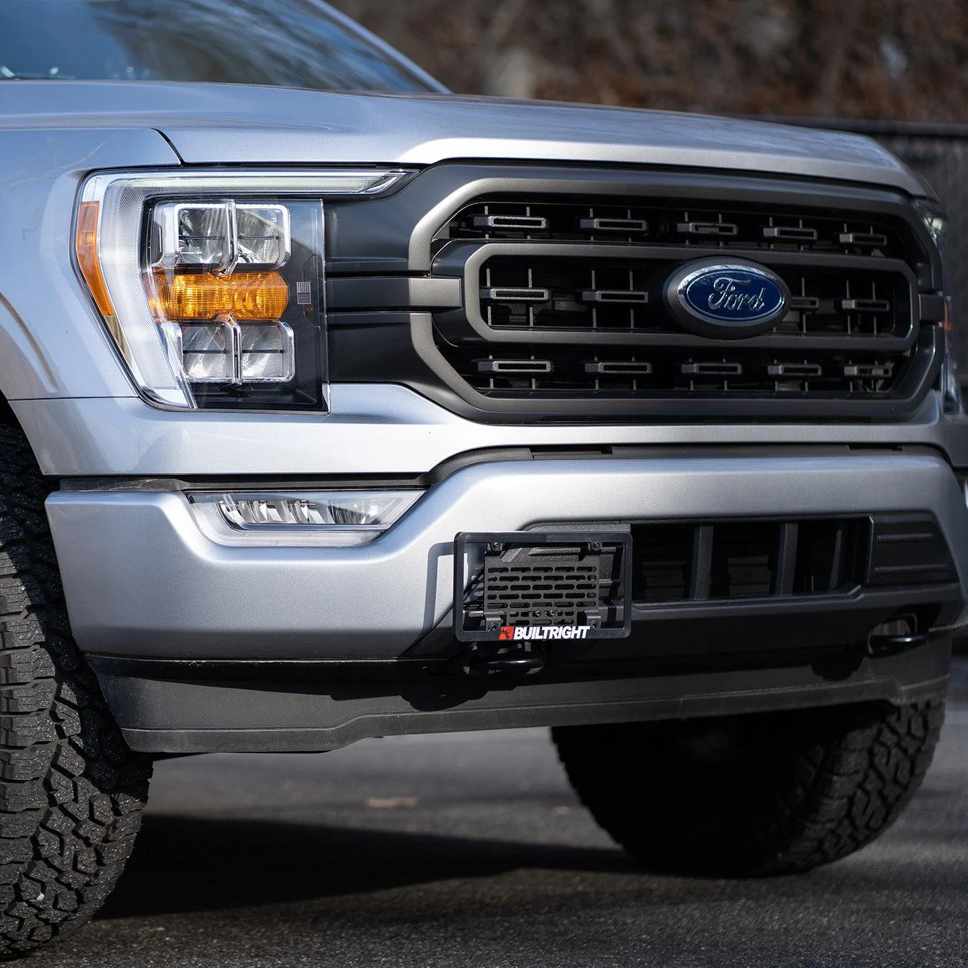

Built right also sells a relocation bracket, but its a bit more expensive than the DIY amazon version:
https://builtrightind.com/products/ford-license-plate-mount-ford-f-150-2021
