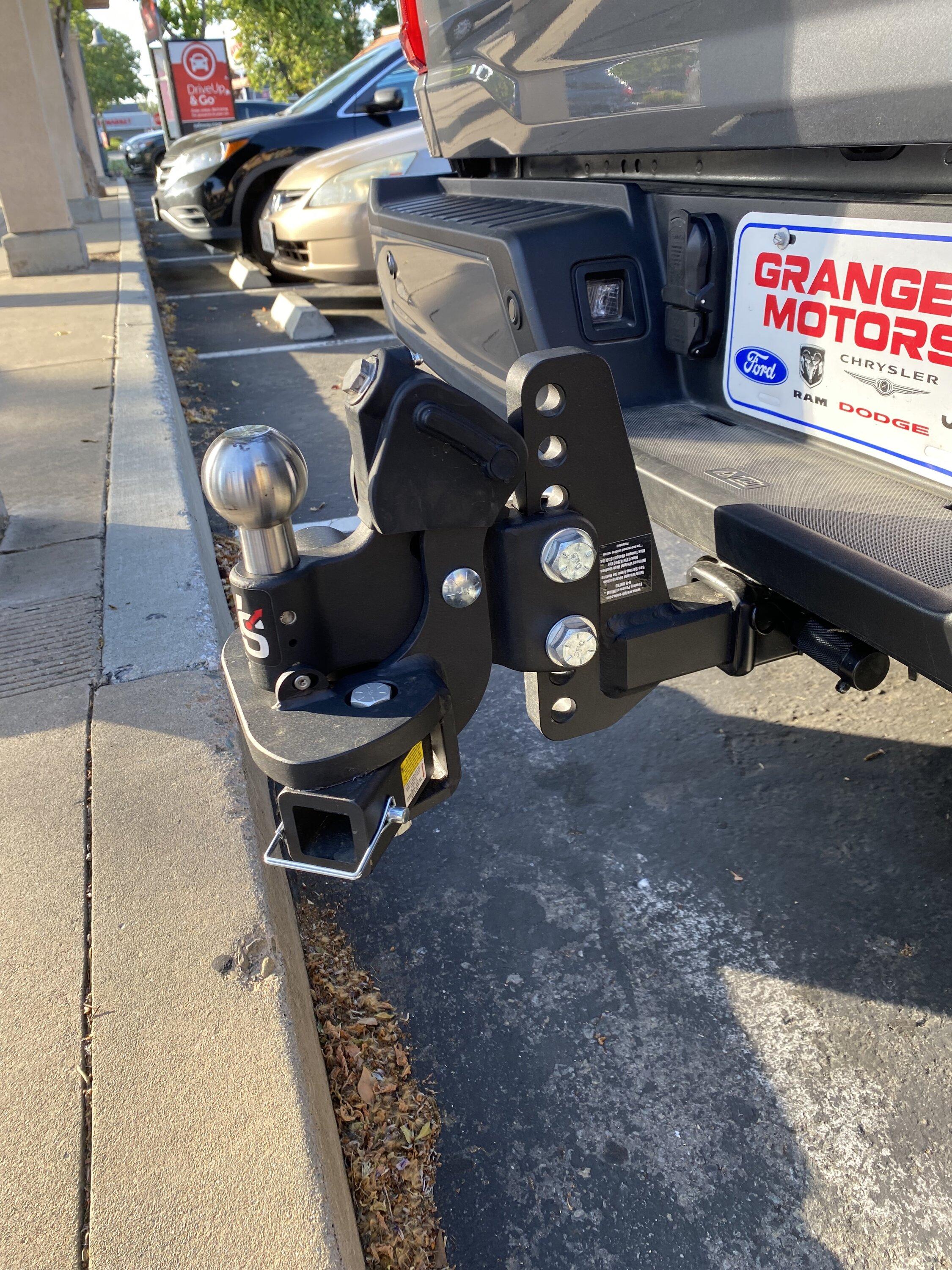

Hi folks,
I'm having an issue with getting the Pro Trailer Hitch Assist to work with my weight distribution hitch. I use WeighSafe True Tow Middleweight weight distribution hitch. It is a bit more sticking out in the back of the truck than a normal hitch. I'm guessing this is why the Pro Trailer Hitch Assist is not working. The truck thinks there is an object in the way blocking.
Has anyone worked around this issue when using your Pro Trailer Hitch Assist?
Ford F-150 Question about Pro Trailer Hitch Assist IMG_6368
Ford F-150 Question about Pro Trailer Hitch Assist IMG_6367
Looks like the ultrasonic sensors are seeing it and detecting it as an object. It is quite large. The 45 degree sides are perfect to reflect back a lot of signal. I've never used it to back into a trailer myself, the camera makes it easy.
I agree. I've never used the assist feature to hook up. When I get close to the trailer, I hit the zoom button and I line it up first try 90%+ of the time.

Best guess is that you''re right - the truck can't find the hitch ball using the tailgate camera. I have no real-world experience but wonder if there's a second hole the square tube that slides into the receiver, that you could run the hitch pin through instead. Maybe a different angle presented to the tailgate camera would help.
For whatever it is worth, I am using an Andersen WDH and the feature works every time. However I'm using it with a short rise and the design of the WDH then puts nothing in between the camera and the ball - the hitch-ball is super-obvious to the tailgate camera. Sometimes it is off by an inch or so, but always front-to-back, so easy to fix with an extra moment in Drive or Reverse.
