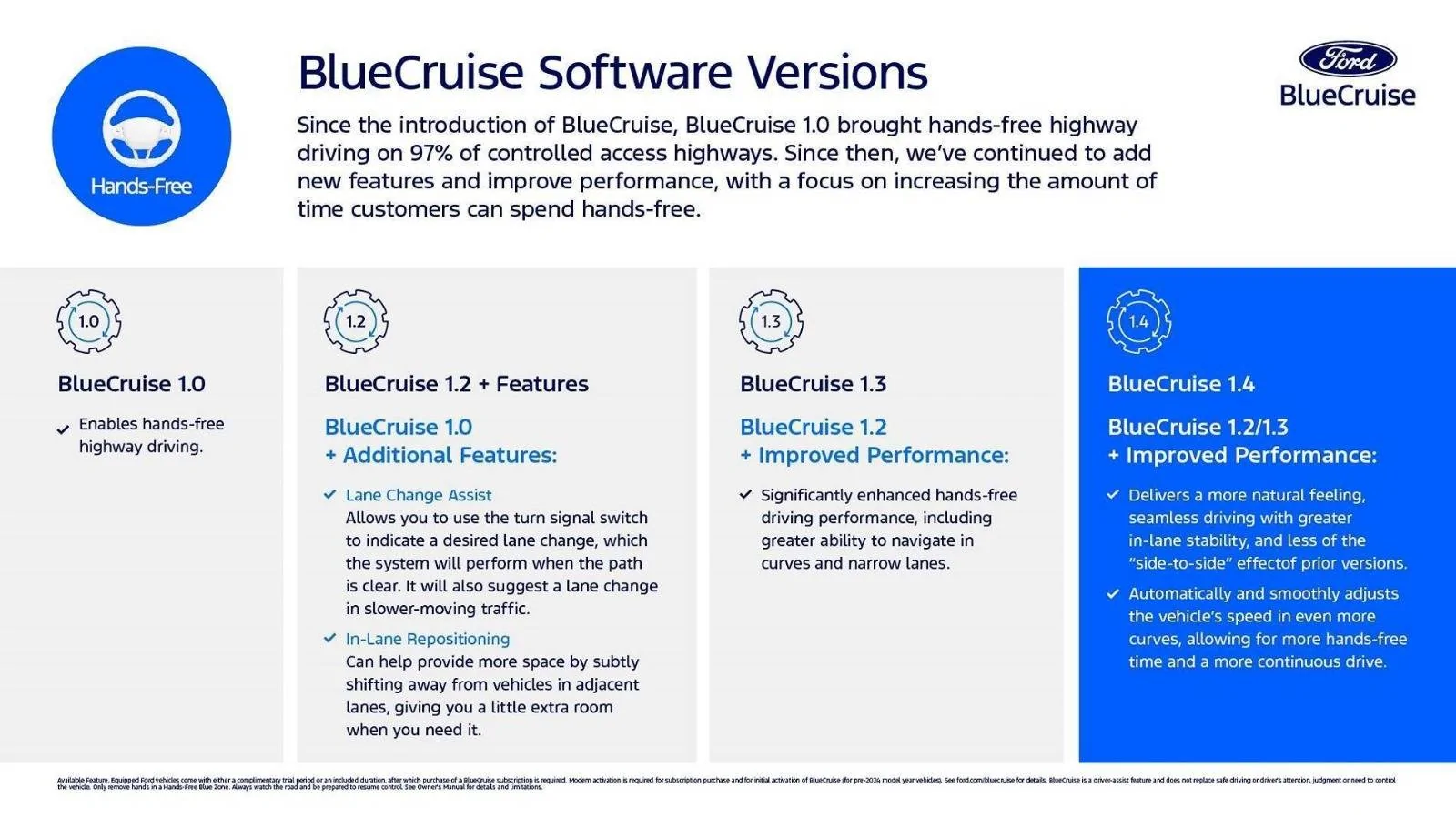

Guys sorry I haven't had a chance to take the big girl out on the highway yet to give 1.4 a spin and grab some footage.
What does 1.4 offer that 1.2 does not?
Here is what I could find on the topic:
Ford F-150 Quest for BlueCruise 1.4 on 2022 Powerboost 1729313797399-vd
How can I determine which version of BC I actually have? Using FDRS or FORScan or ??
This is a lovely question. I have no idea. I just updated to what I think is 1.4 but I have no visual cue to tell me that for sure. We will need the seniors to kick in on this one.
What general steps would I take to upgrade BC to 1.4?
FDRS and update each and every module - I think you only need 2 or 3 of them for bluecruise but I don't see any harm in getting everything updated. Once the modules are updated, you have to flip a few registers using Forscan. You are right, it is under wraps but rugedraw will gladly help you out with that. He is incredible. We don't deserve him.

What version of BC you have is dependent and what IPMA software you have. In order to have lane change etc on a 21-23, you need to update the IPMA with FDRS to the latest version which is ACJ. We call it BC 1.4 because the ACJ software is the same software that was rolled out to Mach E's in early access last December and it was called BC 1.4 in the OTA that was sent out before Ford pulled it.
Now on the Mach E, there is a new IPMA software (BAE version) that Ford is calling BC 1.3 and that software is replacing the ACJ software that is available to us.
Because you truck already shipped with 1.2 and you have lane change etc enabled, you would not need to do anything with FORScan. If you truck has newer IPMA software available to install with FDRS, then all you would need to get the newer version of BC is install the newer software.
Rugedraw this is the best explanation I've seen here--many thanks!
