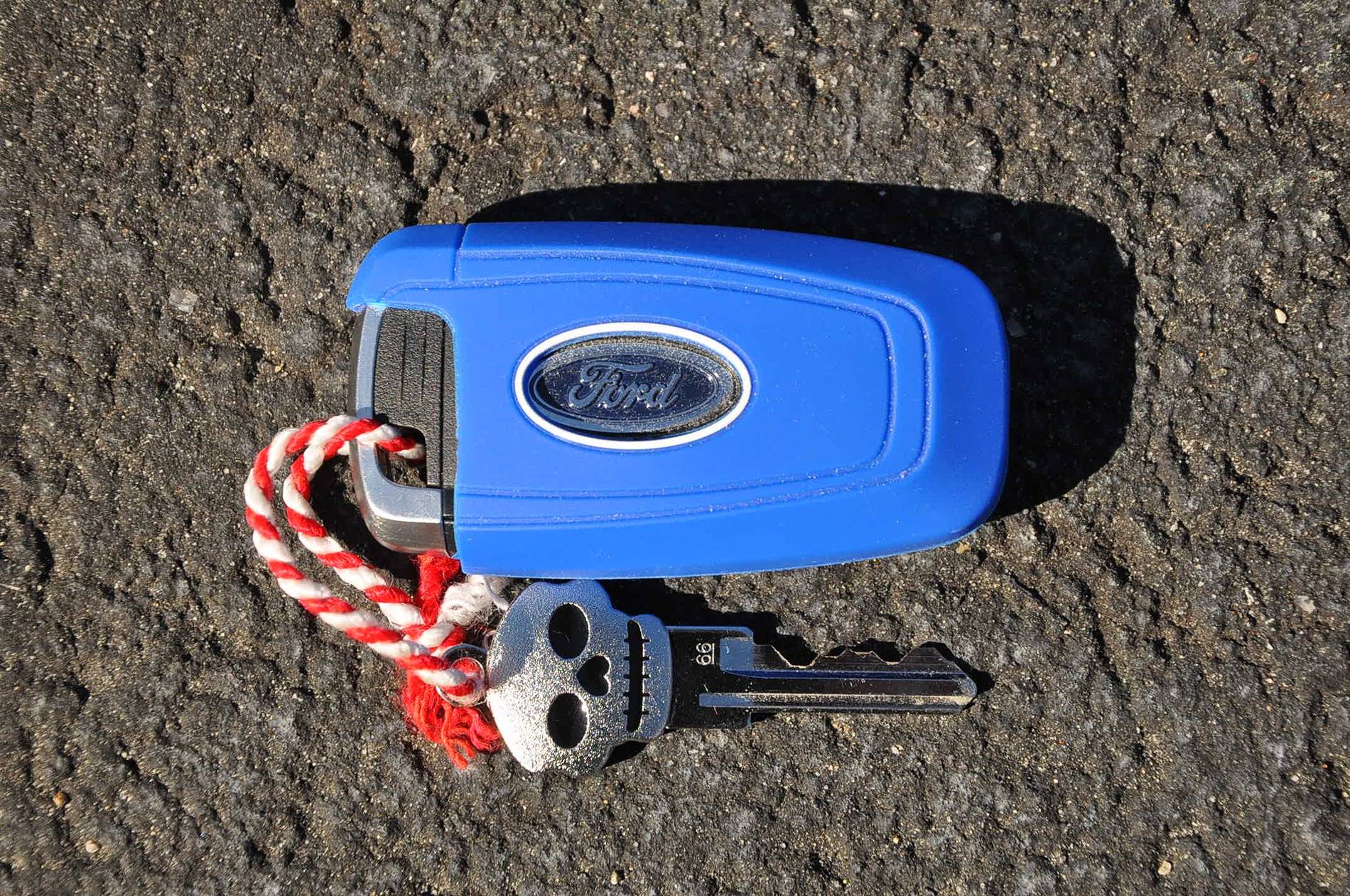

I used these guys and it works great. As others have stated the timing is critical. Have everything laid out for easy reach and memorize the steps. Speed is the key.
Discount Car Key Replacement – CarandTruckRemotes
I did not get my 3rd key cut and I only have it programed. I use this key to give to the shop for work.
They also make a nice rubber sleave with different colors for the fobs so I know what key is what.

I used these guys too and had good results with extra fobs for both my '21 F150 and '18 MKZ. I found a local locksmith to cut the entry key.
