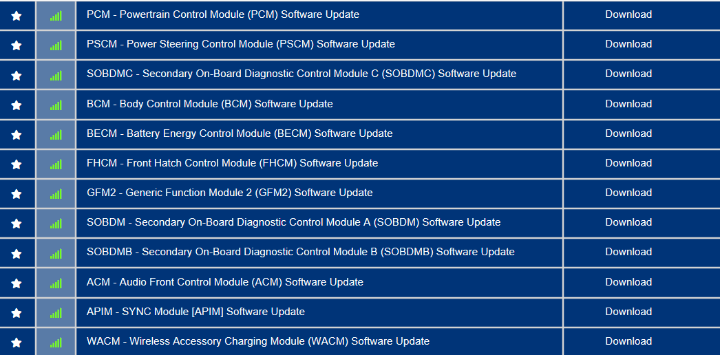

Even so, the list of available updates for your truck is long......and there's an APIM update there. If I was a betting man, I'd say 23159 is coming to you guys, too.
So a tad off topic for this thread, but since it was noted - I had the best Ford Service call ever - at my house. Tech has checked for the wiper motor recall and tailgate light bar (Lightning) and will be back to replace those in a week or two after ordering parts.
The rest of that is he applied the battery voltage check SW and I asked him if he would consider applying that WACM since it will never apply via an OTA update. He said sure - why not update them all. He proceeded to apply every update I had waiting.

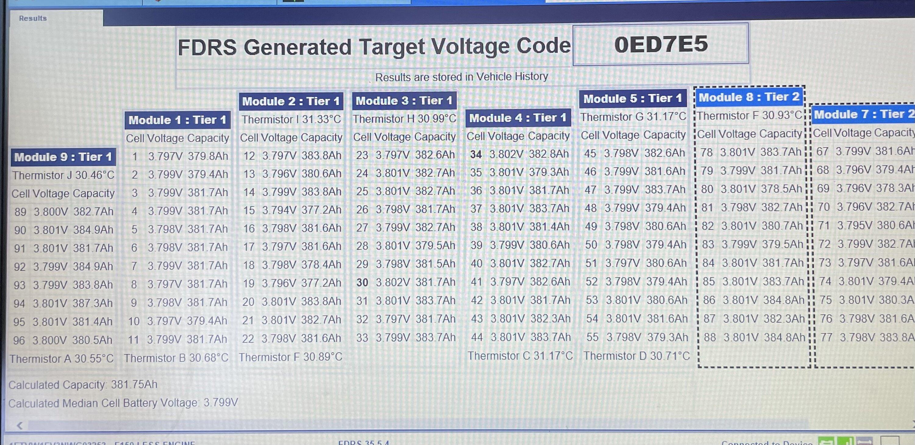

One other asked about the battery modules here too - here is my read out. I do realize module 6 isn't shown, I didn't realize we may need to scroll to see it.

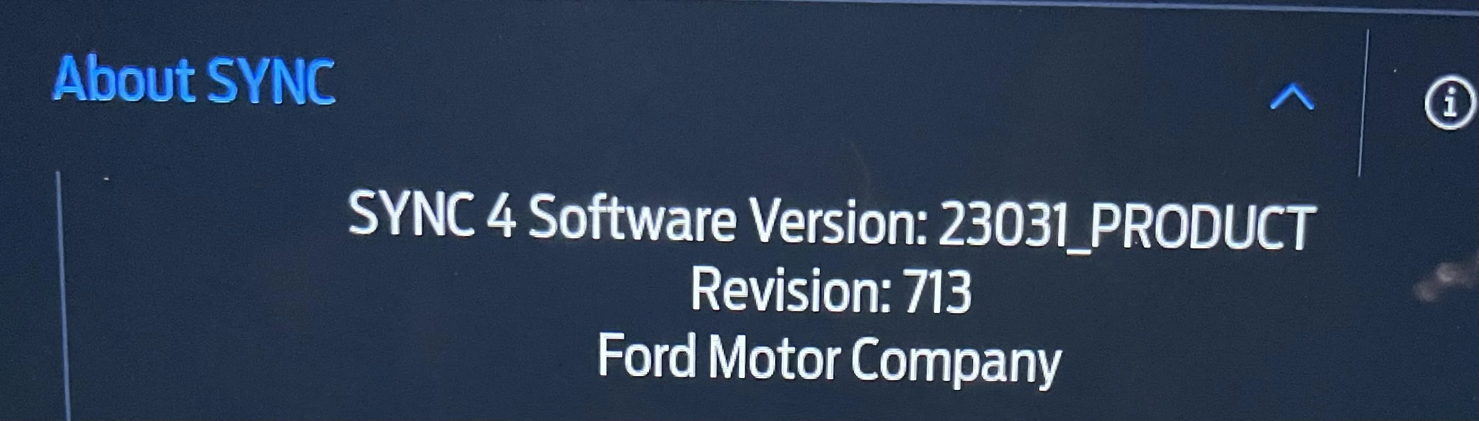

Wow...that was really nice of him to apply the updates. I'll check your VIN in FDRS again later to see if there's anything left. However, you did have an APIM update in the list I sent you. If he did them all, then you won't be getting this update because you already have it.
What Sync does your "about sync" screen say you have?
