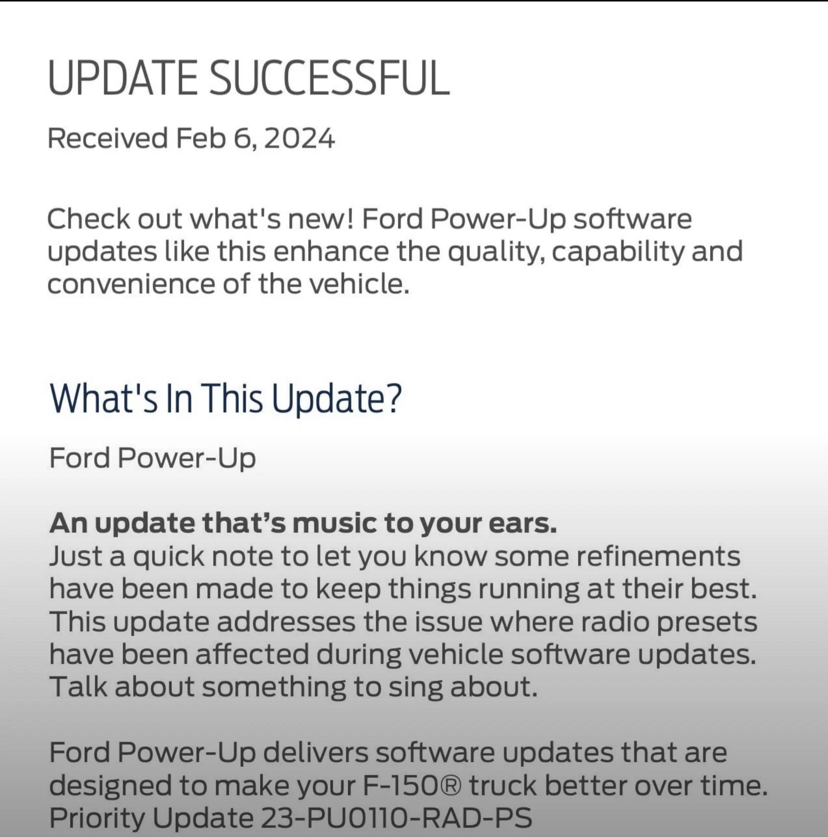

Ford Power-Up Priority Update 23-PU0110-RAD-PS

Recorded a quick video to better illustrate my issue. Is this happening to anyone else? Even with Fords latest update today it's still not working properly. I have stated in other posts that it has worked properly in the past from time to time. Properly to me means CarPlay NOT stopping the radio.
