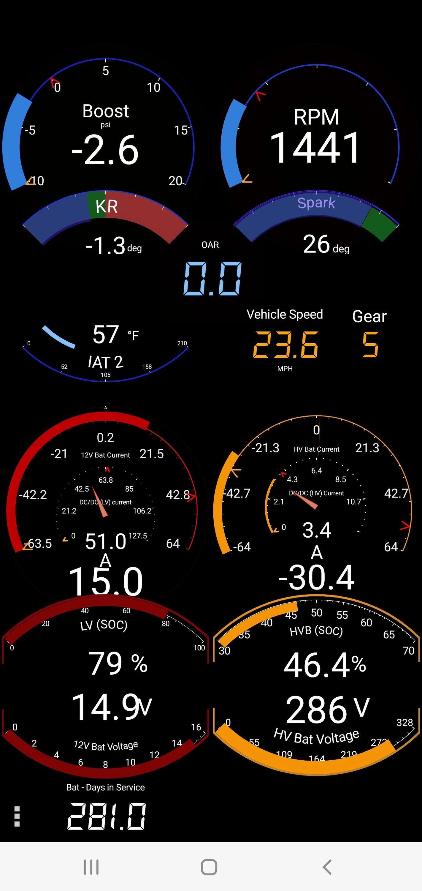

Ford F-150 Powerboost probably slower than Ecoboost Screenshot_20230327-083758
snakebitten I lucky got this dashboard when I imported your pid. It added the new pid to and older pid you sent without a single modification..
I don't understand a couple things.
12volt batt current vs dc/dc/lv.?
The same for HV batt current vs dc/dc/hv current.
What's the difference in these current measurements? What's dc/dc?
Also AOR. This pid never changes. Stays at 0.0

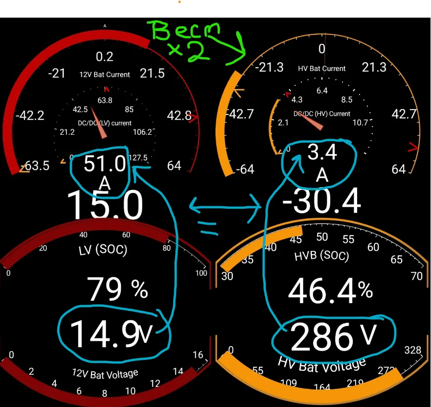

DC/DC is the powerboost's 12v power source. The LV amps = 12v, HV amps = what it's pulling from the high voltage side to make that 12v (15v in that screen shot)
The other HV amperage is what's going into or coming out of the HVB which is basically the DC/DC + AC compressor if running + (or minus) what's happening with the e-motor inverter....
Ford F-150 Powerboost probably slower than Ecoboost 1680038254315
The HV batt current on there looks to be 1/2 of what it should be as the peak amperage of the HVB is ~130 amps
35kW / 286v = 122a (motor peaks at 40kW though)
There's "2" batteries in the HVB so it can kinda throw some readings off.

Can this be explained in a additional way. I appreciate your explanation but I can't quite get my head wrapped around this. For example you circle both dc/dc high voltage and low voltage and placed an = sign. I'm not sure what your trying to explain. I'm sure it's my mind that's not getting it.
Also I'm still not getting a budge of change on the oar reading. I filled a 1/4 tank of 87 octain thinking I would get some reading.
