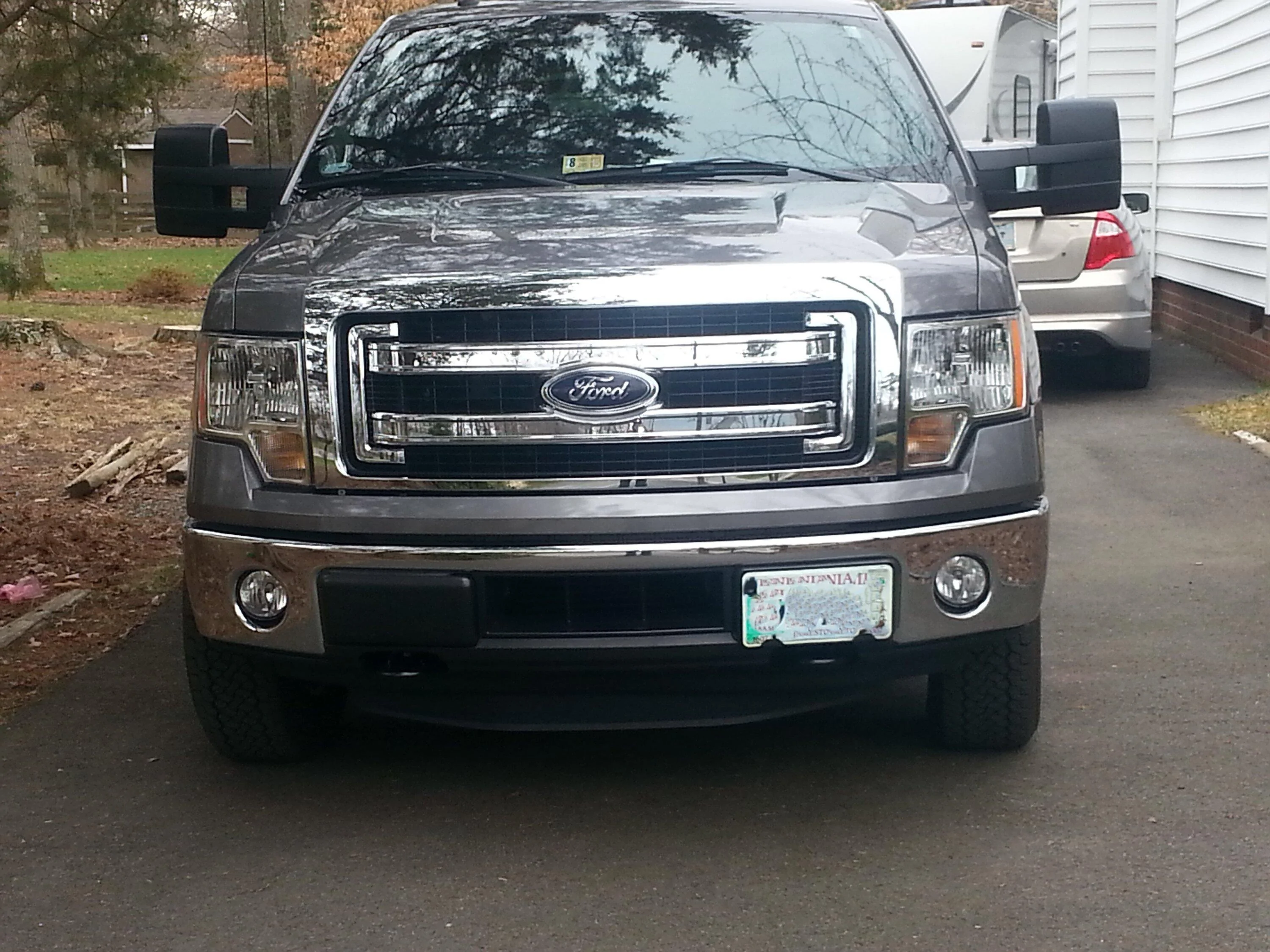

Happened to scroll through the thread and it stood out to me just how much that front plate obstructs the intercooler. Talk about shitty placement for the LP!
Wonder why Ford moved the plate there? When Ford first introduced the ecoboost engine, the front plate was attached to the side of the intercooler hole. This is my MY14 truck.
