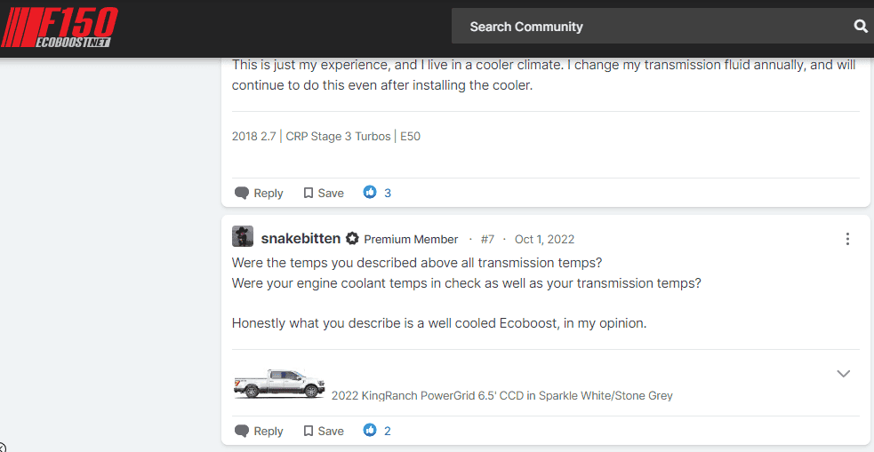

Then as I'm doing a little research I come across this lol
Ford F-150 Powerboost Overheated while Towing snake
For my needs and known future needs, I just don't like the trans temps. I'm fine with engine temp spikes up to 240 not wanting to down shift, it's just that ends up in the trans due to no direct air cooler. That should have been a given w/ the tow package IMO. Would have cost ford less than $100 for it.

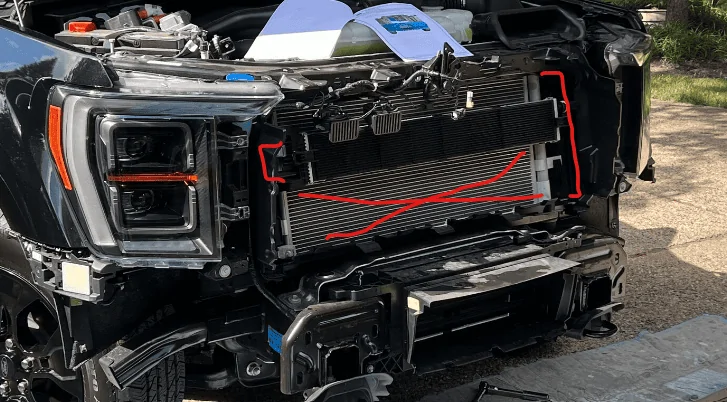

Is there space to add one that's thermostat controlled since the police and Raptor have them?
You'd replace / remove the water going to the trans as well as its heat exchanger. Haven't found a direct bolt-on t-stat box with hoses yet. Oil rads come in all shapes and sizes so that wouldn't be hard to source. Need to a do a little metal fab for brackets which is pretty easy with what I consider average tools.
This is a PB and that HV rad is where the raptor aux trans goes- room below it for a trans cooler.
Yeah, I would imagine a retrofit is going to be more complicated on a PB versus a non-PB 3.5EB.
