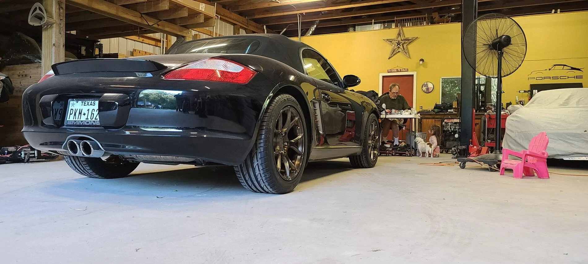

I swapped wheels on the toy a couple of days ago. NOT for looks, although they are nice enough. But they are incredibly light at ~17.5 lbs each. The car is happy. :)

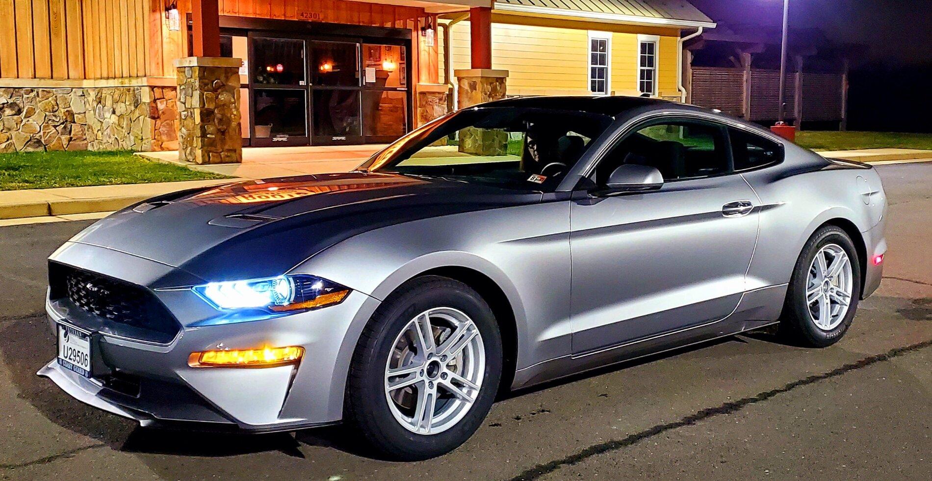

I swapped wheels on the 2020 mustang, measuring before and after with OBD reader numbers. A good amount of miles before and after each.
I took off the factory wheels and tires. Did a combo of lighter tire and wheels (from tire rack) hunter road force balanced.
I think the savings per wheel/tire was a good 10+ pounds.
I can't remember the load numbers, but the boost requirement that WAS typical was no longer... in order to request the same driving characteristics.
You're right about butt dyno, I felt it too. Just felt lighter, due to more free torque. I noticed highway get up and pass was easier. Less pavement contact...
More boost meant more fuel... so I naturally saw better mpgs too, like at least 2 or 3mpg better (diameters were the same as factory and on point.
So I had less resistant tires, lighter tires, a thinner and lighter wheel. Boom. And this was with winter gas!
Weight ans resistance at wheels is a HUGE factor. More than most ever think of first. And it should be where the mind goes first, beginning with psi.
Man, psi... there's another small thing that makes a huge difference in mpg, road imperfection feelings, etc.
