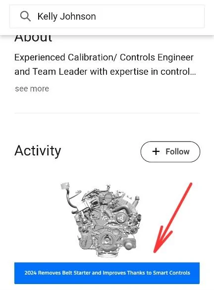

I would really enjoy reading what the engineer actually wrote on LinkedIn, but I don't have any social media accounts and don't plan to.
For those that are curious, this is the gentleman at Ford and his link to the article can be seen without logging in, but can't be read.
Kelly Johnson with Ford Motor Company will locate his LinkedIn profile easy enough.
In their defense, a lot of us got the information wrong including myself. It was a confusing LinkedIn post and Ford PR didn't bother to correct a lot of us. I rewrote mine and posted it after a clarification from Ford PR.
The headline was way too confusing with the BISG, so I dropped it and just said a starter was removed.
https://pickuptrucktalk.com/2024/06/2024-ford-f-150-hybrid-engine-starter-dropped/
