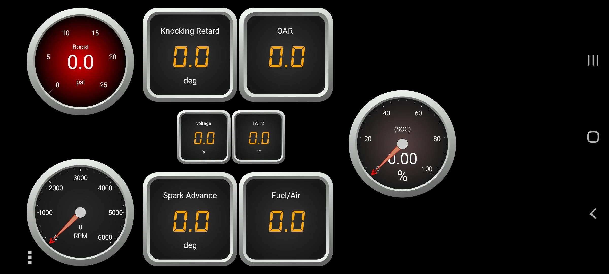

Just a test dashboard I have on an Android phone as I dig into replacing my Ngauge in my truck.
The gauge furthest to the right is SOC, state of charge for the Hybrid Battery.
When active in the truck it's VERY informative and you eventually discover the management strategy that Ford has regarding. I'm convinced that if Ford would simply make available on the instrument cluster some equivalent, the driver would be armed with the kind of feedback necessary to gain additional fuel economy.
