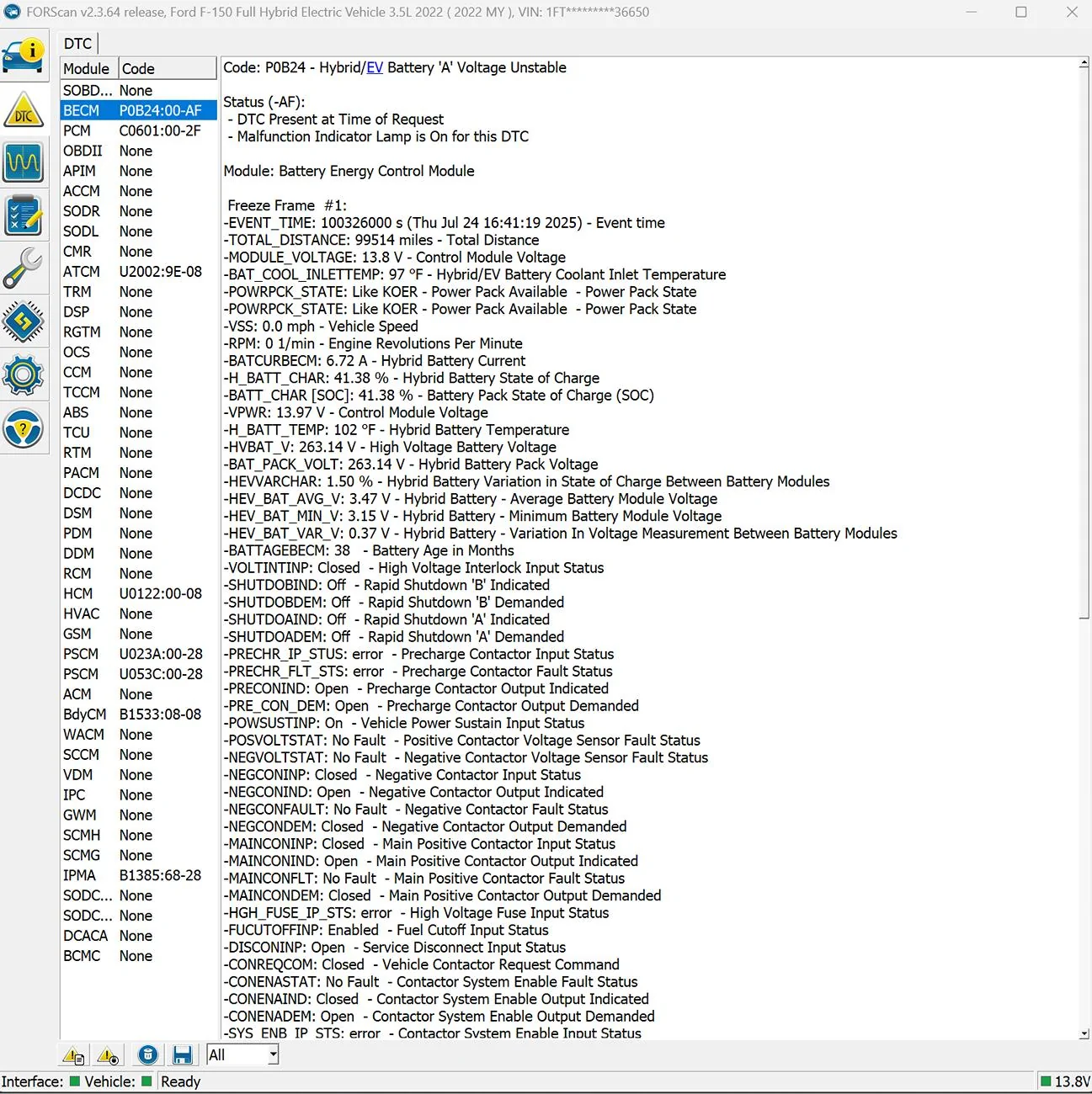

Hi all, I thought I would share my experience with this fault and see if it helps anyone.

All that led up to this code being thrown while my truck was in park on two occasions. the first time It cleared after full power off (open door, close door) the second time it was sitting in generator mode providing my hardworking ass some starlink internet so I can listen to tunes while I work in the field with no cell service. then it threw the same code. I power cycled to clear it and it came up again by the time I drove back to the house.
Time for ForScan.... I pulled the code and have attached the screenshot. With 500 miles left on my 100k warranty my next call was to the dealer, service advisor connected to my vehicle and saw the same thing I see I ForScan, his advice was park it and bring it in ASAP due to my warranty ending.
4 hours after dropping off at the dealer he calls me with approval from Ford to replace the entire battery under warranty, says the cost would have been ~ $7500.
