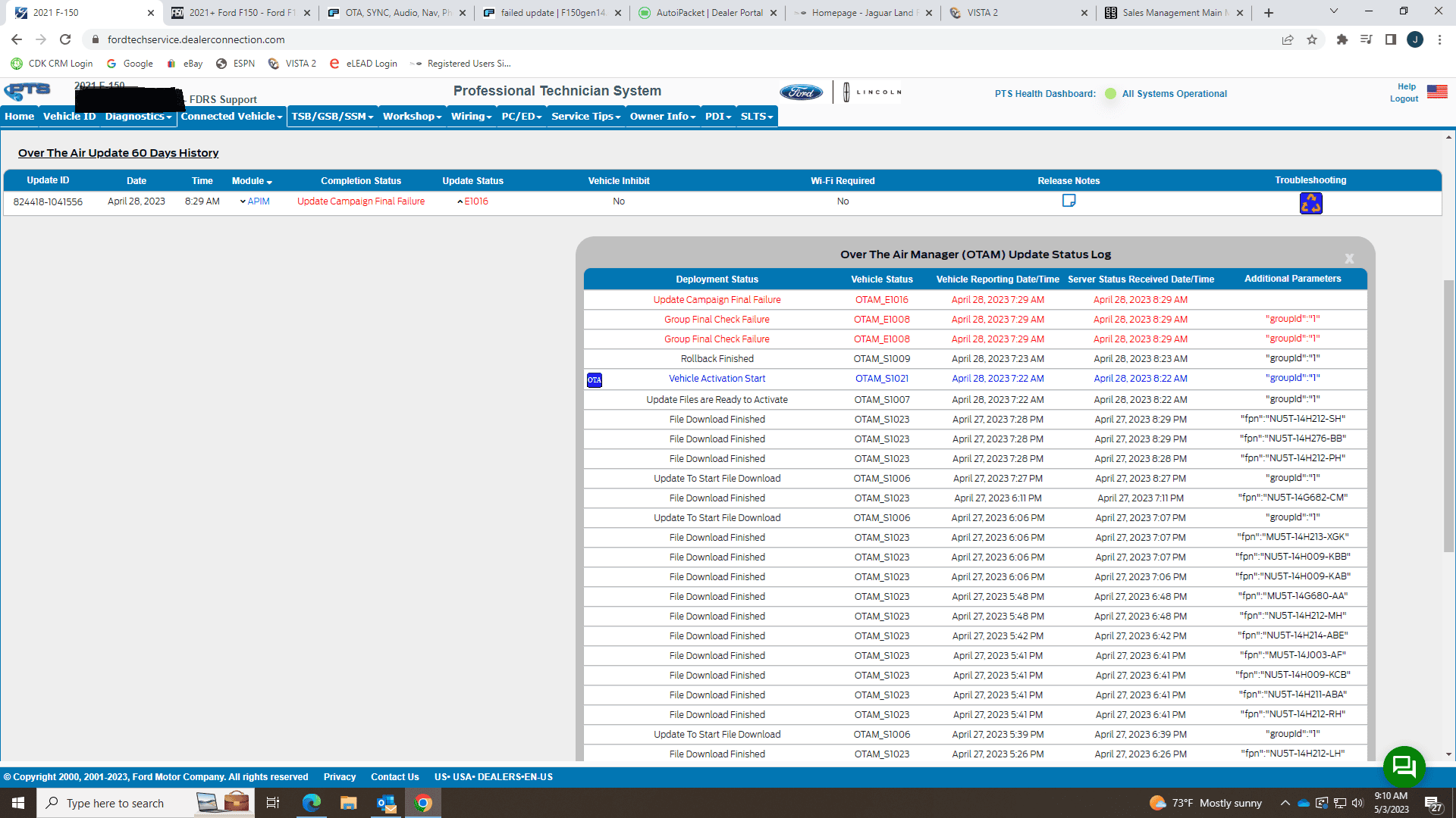

i had something happen during my 4.2.2 install too. lost XM and nav. OTA campaign shows as failed. took it to dealer yesterday to take a look. will likely regret that decision. ?

Yea, I just looked at his OTA dashboard and it seems it tried to roll back towards the end of the update process before the update failed. I have checked countless trucks and I have never seen that before. Very strange indeed.

His OTA dashboard shows the update tried to roll back before it failed. I have never seen that before in the countless trucks I have checked.
@"Steve" I blurred out your VIN in the screen shot posted.
Ford F-150 Power Up 4.2.2 WiFi Bug Picture14
