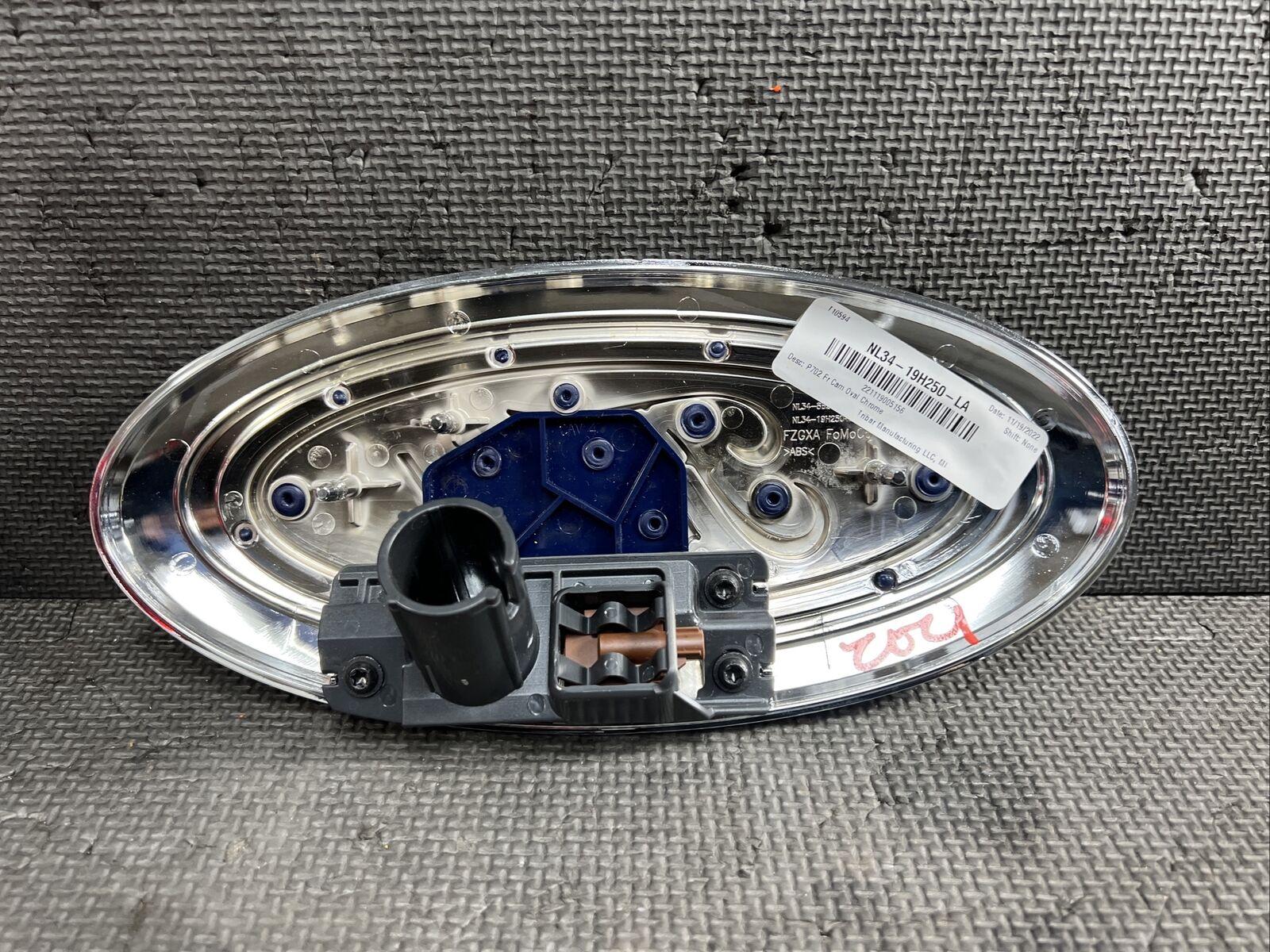

Update on my install, all wiring has been completed and front emblem and camera installed. I am waiting now on my mirrors and module and have tested the front camera using the existing back camera plug in pin #2 and camera functions and wiring is good.
I wanted to share some info with whoever is doing this to their truck. Ford has actually done away with the front camera washer system on the "23 trucks and gone with just a camera and emblem system. I was able to pick one up on eBay, part number NL34-19H350-LA, for $200. Attached are photos of what I got since my truck has the chrome grill. They also come in the black and chrome version but I don't know any part numbers. I like that you don't have to buy all the extra hardware to hook up a washer system that I suspect doesn't do a whole lot.

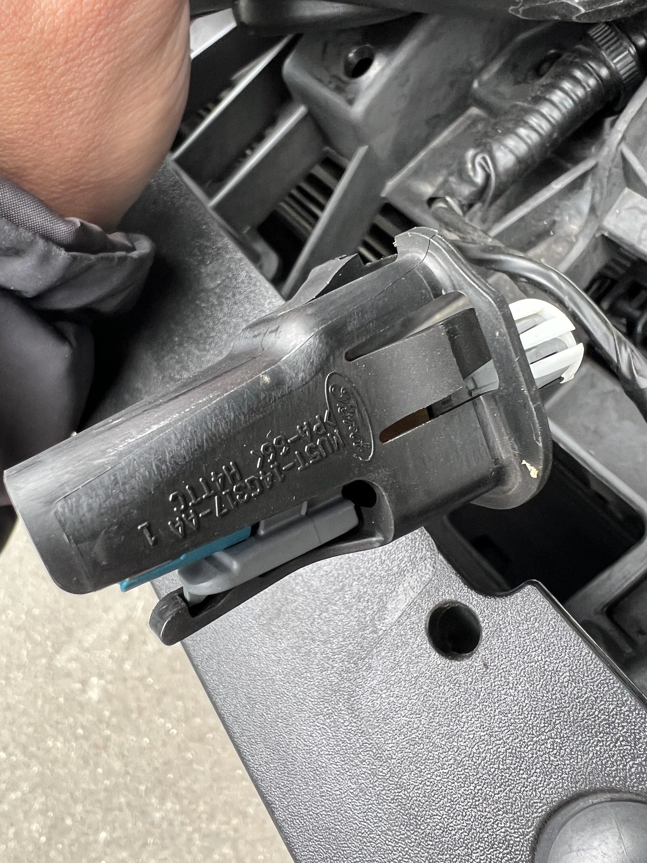

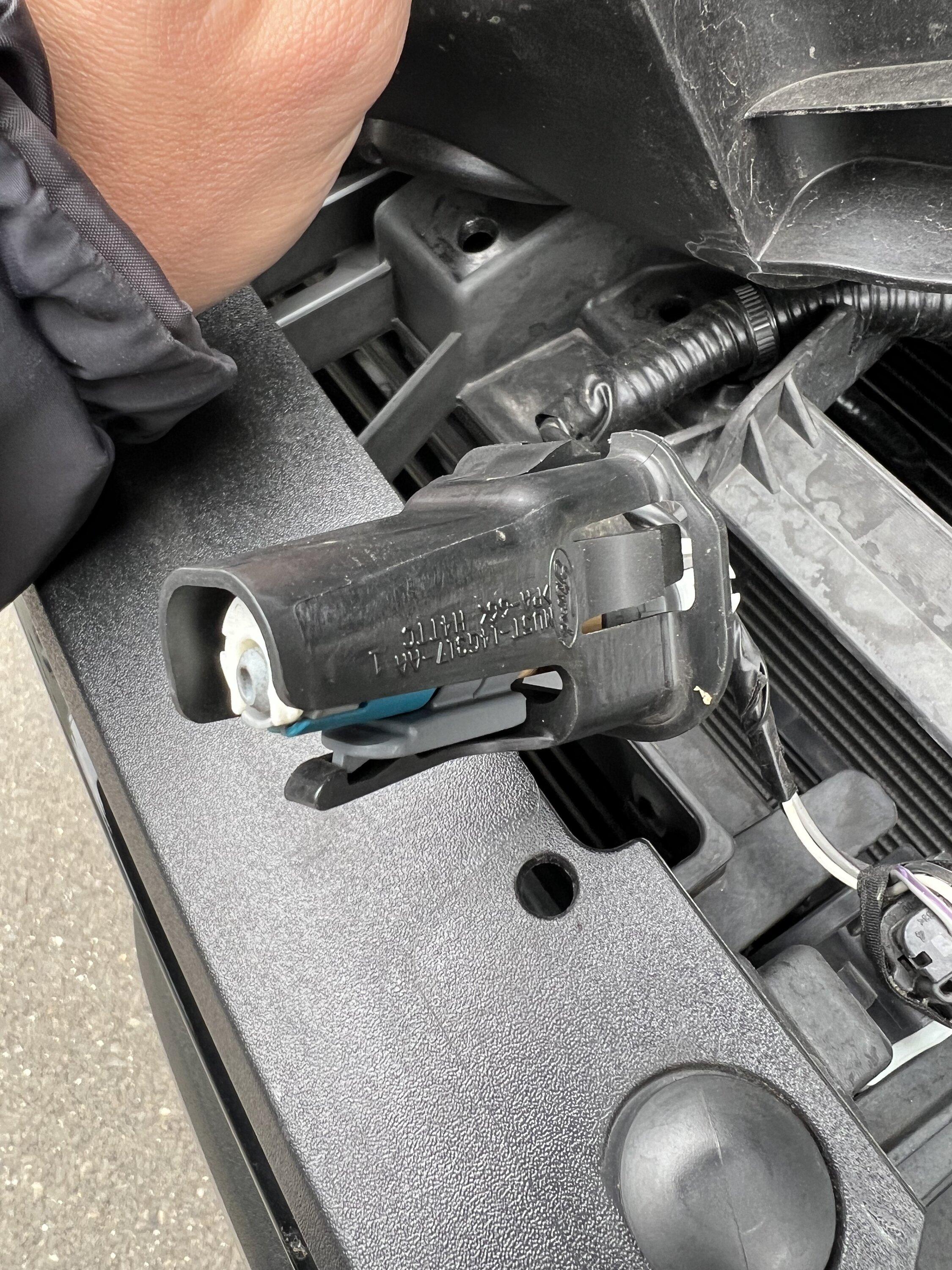

I am really late to the party here, but I have a 2022 Lariat with the package 502A, after opening the front of the truck I found this wire hanging out lonely. is this the wire for a front camera?
If it is, can anyone here who has accomplished this, help me accomplish this as well?
