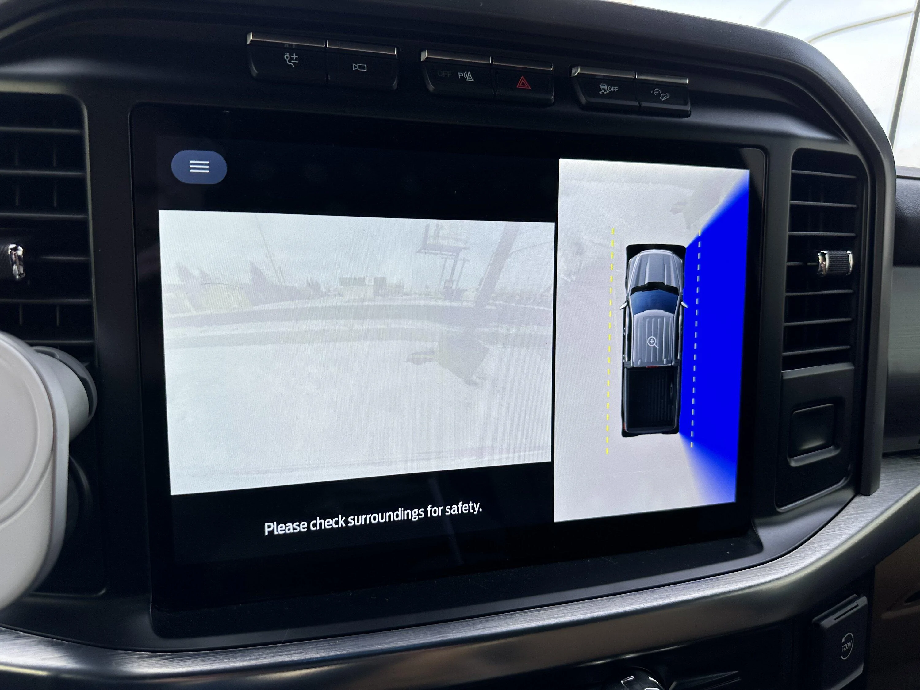

yeah i haven't looked too closely but i don't think its far enough off to care about. i do need to do the rear one though - its complaining every time i go in reverse now :)
What do you mean complaining? If you have 360, you dont need to do the rear. If you are talking about the reverse brake assist, You may have to drive the truck a little before that will go away.

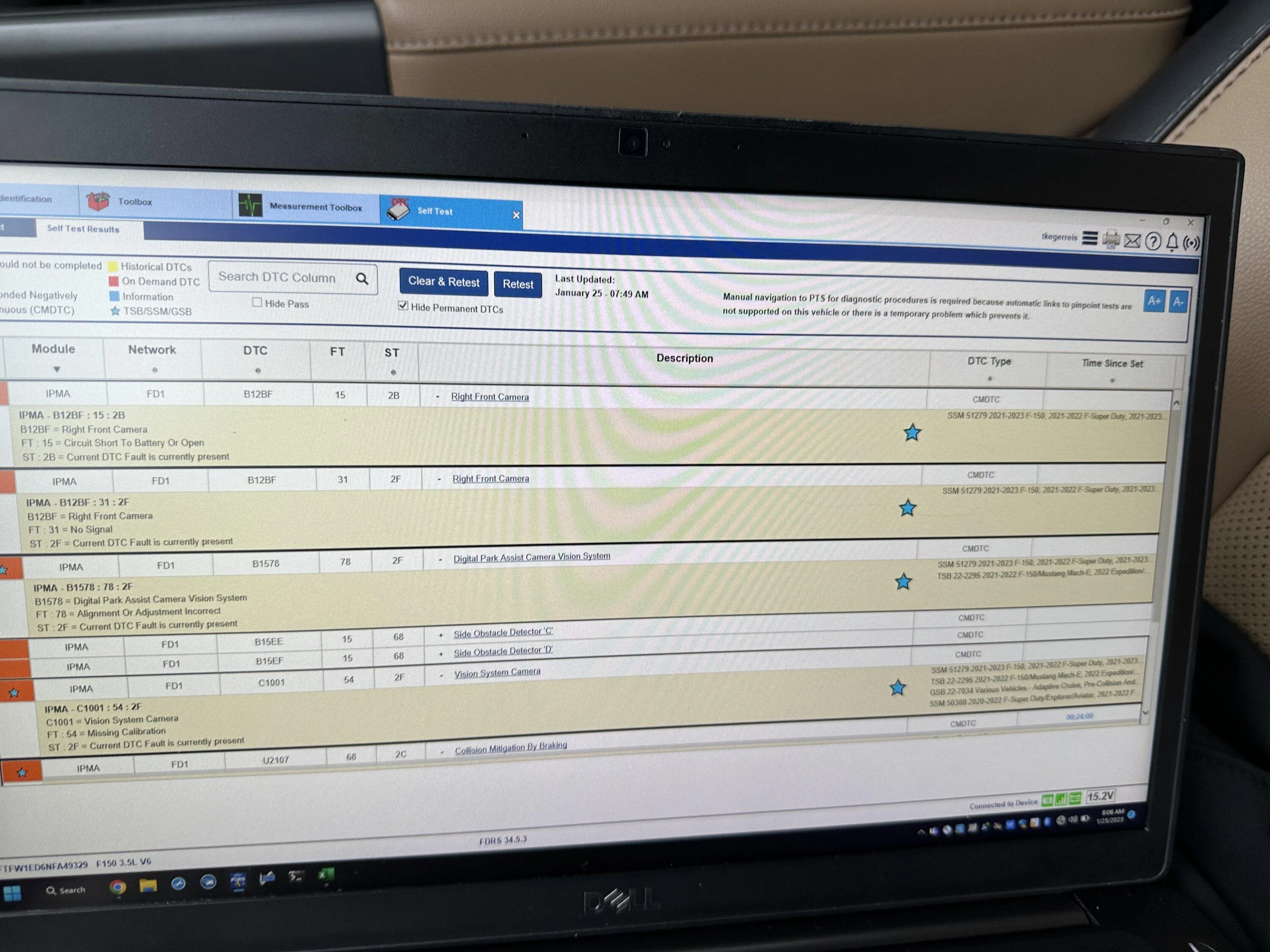

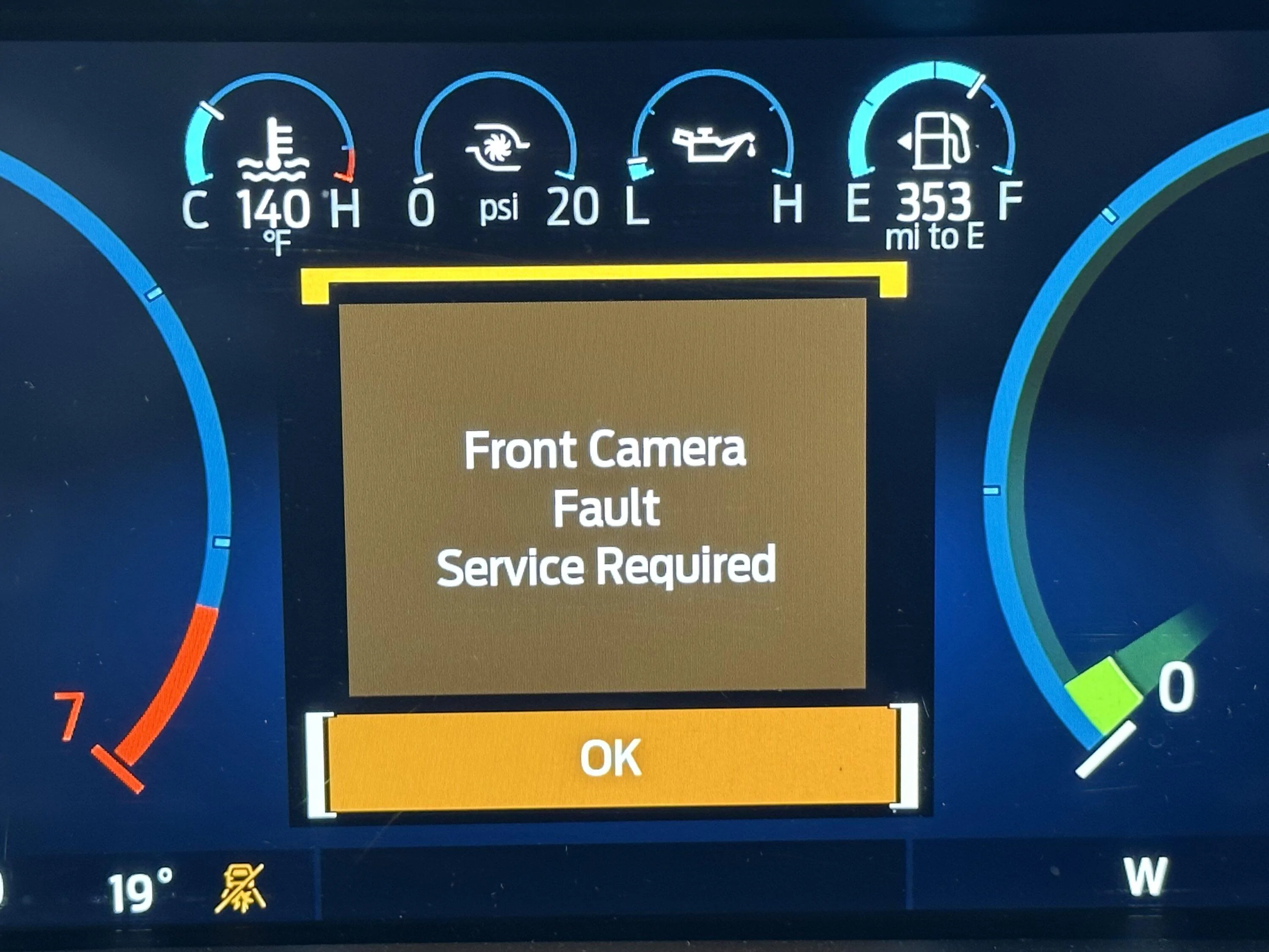

Ran the rear camera calibration but still getting a reverse brake assist error when going in reverse. Also these:
Ford F-150 360 camera alignment failed to start CB353FCA-EC35-4096-8F68-F6BC476814EC
Ford F-150 360 camera alignment failed to start 5460C780-AD2C-40FF-894C-2D510627B6C5

I ran the 360 camera alignment and now still seeing these DTCs
Ford F-150 360 camera alignment failed to start 27880A68-01A6-4EB7-91AA-FC1953962E55

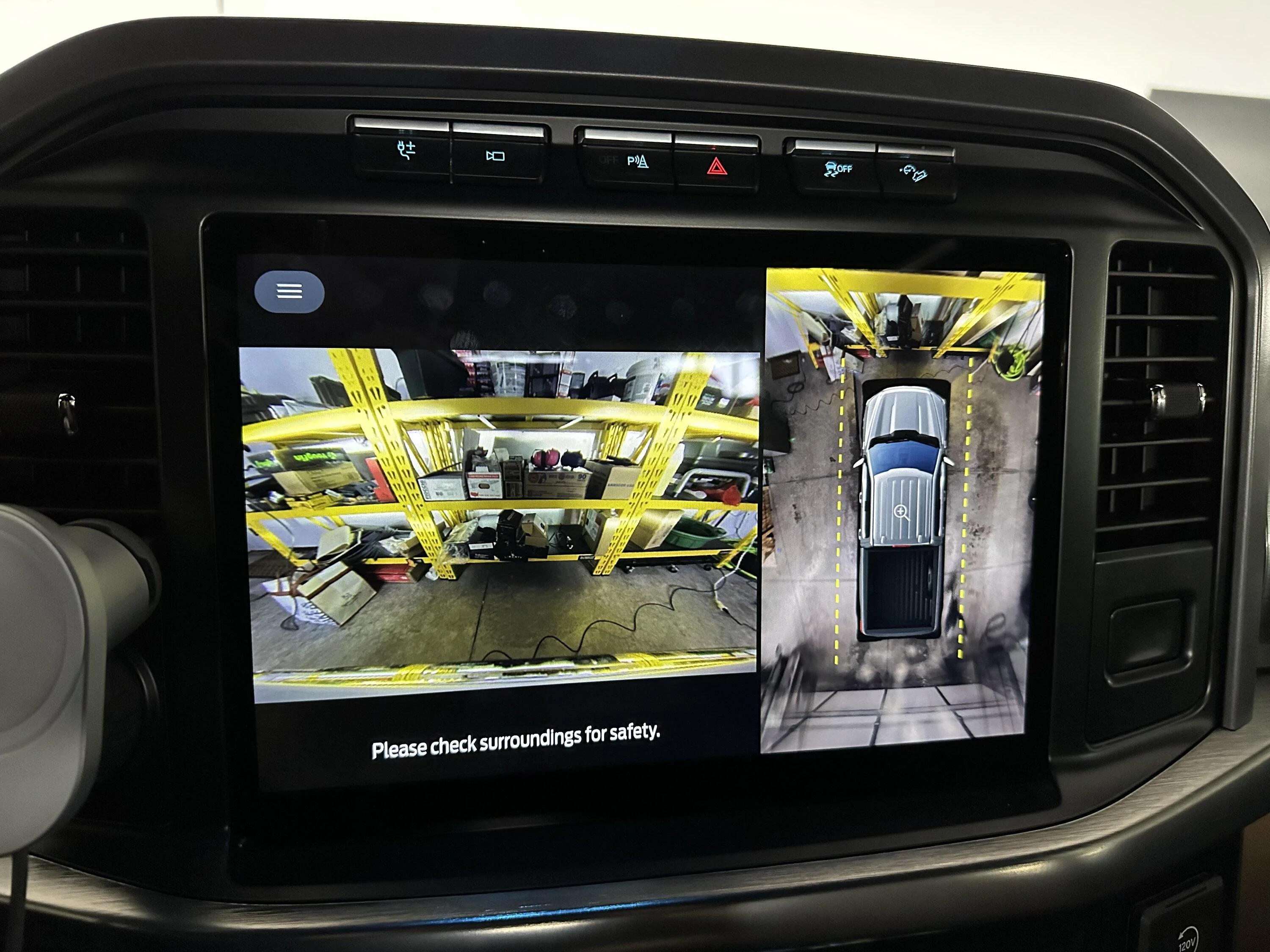

These codes are still present, but after running the IPC configuration routine in FDRS I am no longer getting the reverse brake assist fault message when going in reverse.
onodelta
Dec 31, 2022
62
United States
you just ran the instrument panel cluster configuration in FDRS and reverse brake assist started working?
