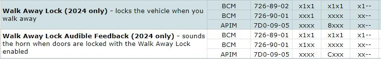

If you have a 2024, it can be done. It is on the common tab of the spreadsheet. It does not mention the software of the BCM needs to be at a certain level, so as long as all 2024's are built with an RFA module, this should work and can always be changed back to what was there before if it doesn't work.

this is walk away lock which is different than Phone as a key. Maybe someone smarter at all this than me will figure it out and I’ll copy them ?.

Oh shit. My bad. Yea i totally got this mixed up. Lol

So dumb the walkway lock isn't available until 2024
