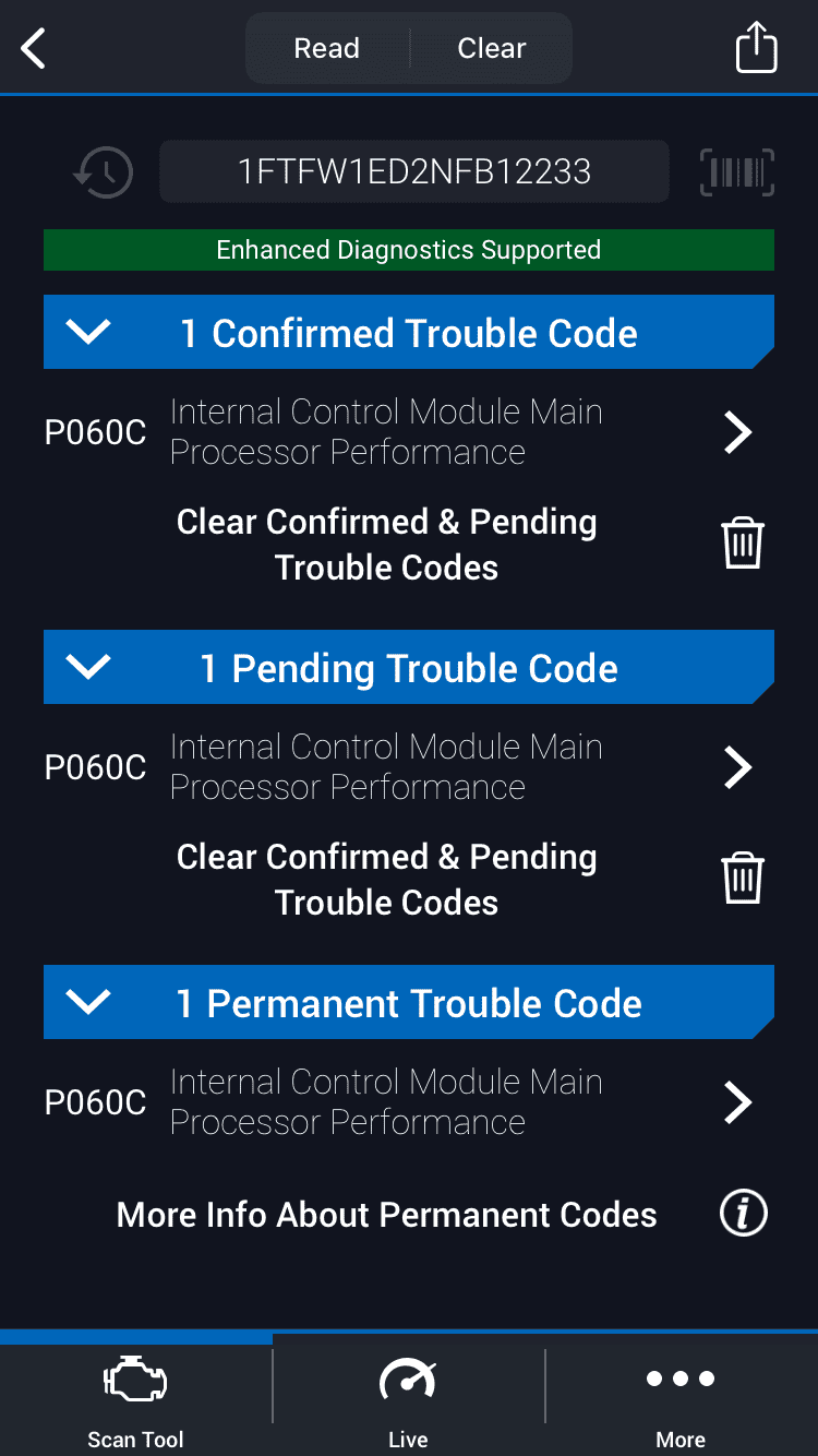

I got a CEL and the following fault after scanning my 22 powerboost. There was a software update yesterday, not sure if related. Anyone experience this? booked with dealer next week.

Having the same issue p060c was my code

My CEL came right after a OTA software update, it disappeared after the first drive, and has been off for the last week, driving fine. Dealer asked if i still want to bring the truck in, but truck would have to be there all day, I declined, they said likely software related.
