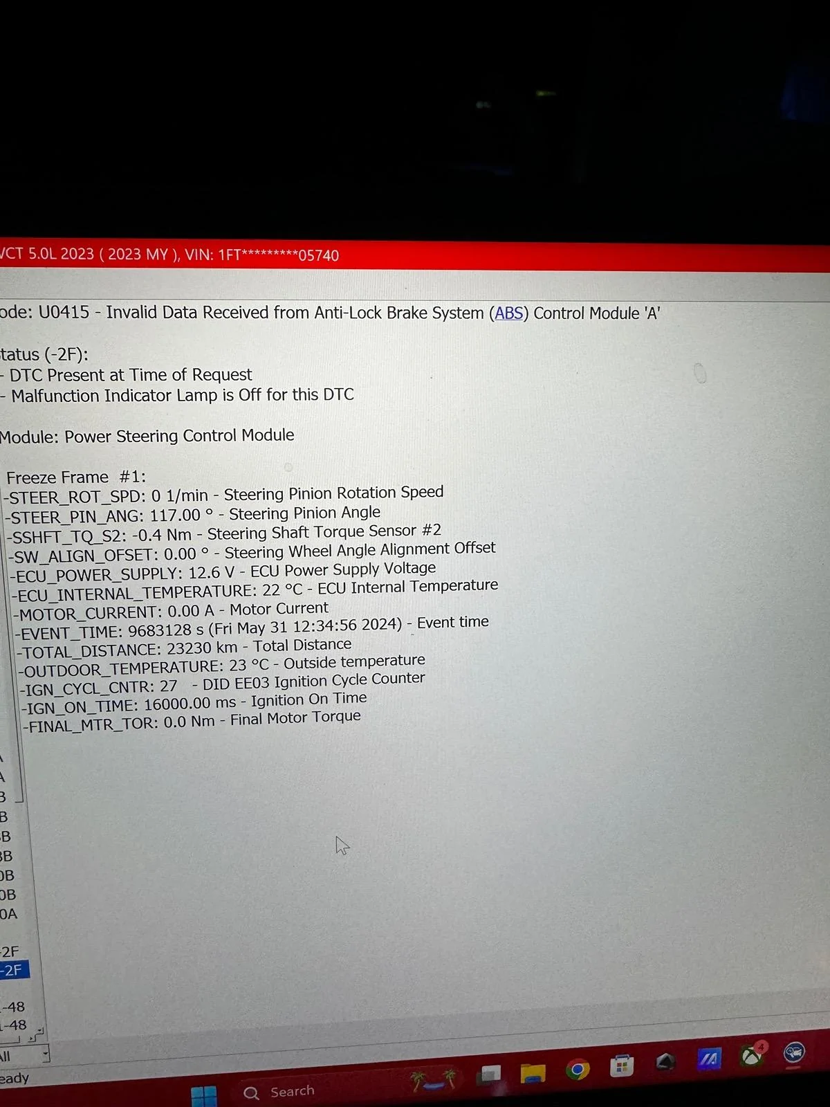

Was working on retrofitting a 360 camera IPMA and I got the ipma working right but afterwards my truck started giving me a pscm fault even though I haven’t messed with the as built in a couple months. Same with the abs module. Now the truck has no power steering and trying to figure out what should I try to get the steering working again. I’ve messed with the asbuilt to try and find anything that looks off but everything looks right to me.

I was using FDRS. But I solved the issue now! I checked the log when my brother ran my pmi for me and he did my pscm after instead of hitting no. Just had to put the right software back in
