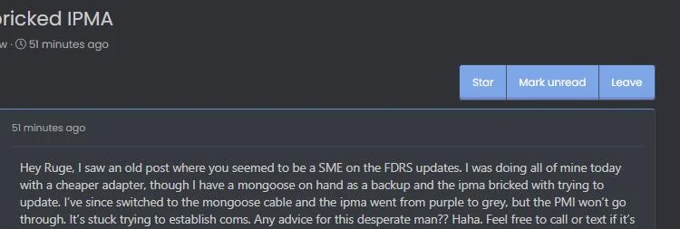

Case in point: Look at this message I got earlier today:
Ford F-150 OTA Update issues 2021 F150 Lariat 1740519554607-am
He had updated 20 modules with no issues until he got to the IPMA and it bricked it. Asked him which cable he was using and he sent me this link:

Btw: I am not singling or calling you out. Just putting the info out there.

I'm not going to defend it one way or another in terms of that link, but quite clearly we can see that link is for the old VCM2 device. I've had my VCM3 clone for many months and performed all sorts of updates including the IPMA.
Caveat emptor. I've tried everything under the sun to break my vehicles. The second I stop trying to break them, they'll break themselves. I've had this VCM3 clone for many many months have performed all sorts of things with them.
Don't install any software at all, this works under ford's VCM3 FDRS/IDS driver. Don't try and do wireless shit, use it with USB like you would a mongoose. I bought one from one particular seller, I see others that look the same and when it comes to chinese, assumptions will bite you in the ass. The link I've shared is from a particular seller, but that doesn't mean his supply hasn't changed. There are US companies selling these for $200 if you want one faster.

I don't take this as calling me out. I'm a tremendous fan of the Mongoose. I've been using it on my truck longer than you have. But it would be extremely myopic not to even consider new options that have emerged in the three years since the Mongoose took the place of the failed VCX Nano as the go-to for these trucks. There is no question that an OEM VCM3 absolutely blows away the Mongoose. It had better for $2,000. If this VCM3 clone has promise, it would be crazy not to at least look into it, particularly if you have a Mongoose in stand-by.
I'm not overly concerned about the horror anecdote you point to. It was for a VCMII clone, and the stories are legion about clones of that particular unit (and there are a lot of them out there) being unreliable. Russian roulette to play around with those. But that doesn't mean that every clone of every unit will always be a failure.
Don't get me wrong--I still retain a healthy skepticism for clones, generally, and I don't recommend just anyone running out and buying one. But this particular clone is intriguing--it uses Ford's own drivers and requires no third-party software--and at least one person has had success with it on this truck's most demanding modules.
