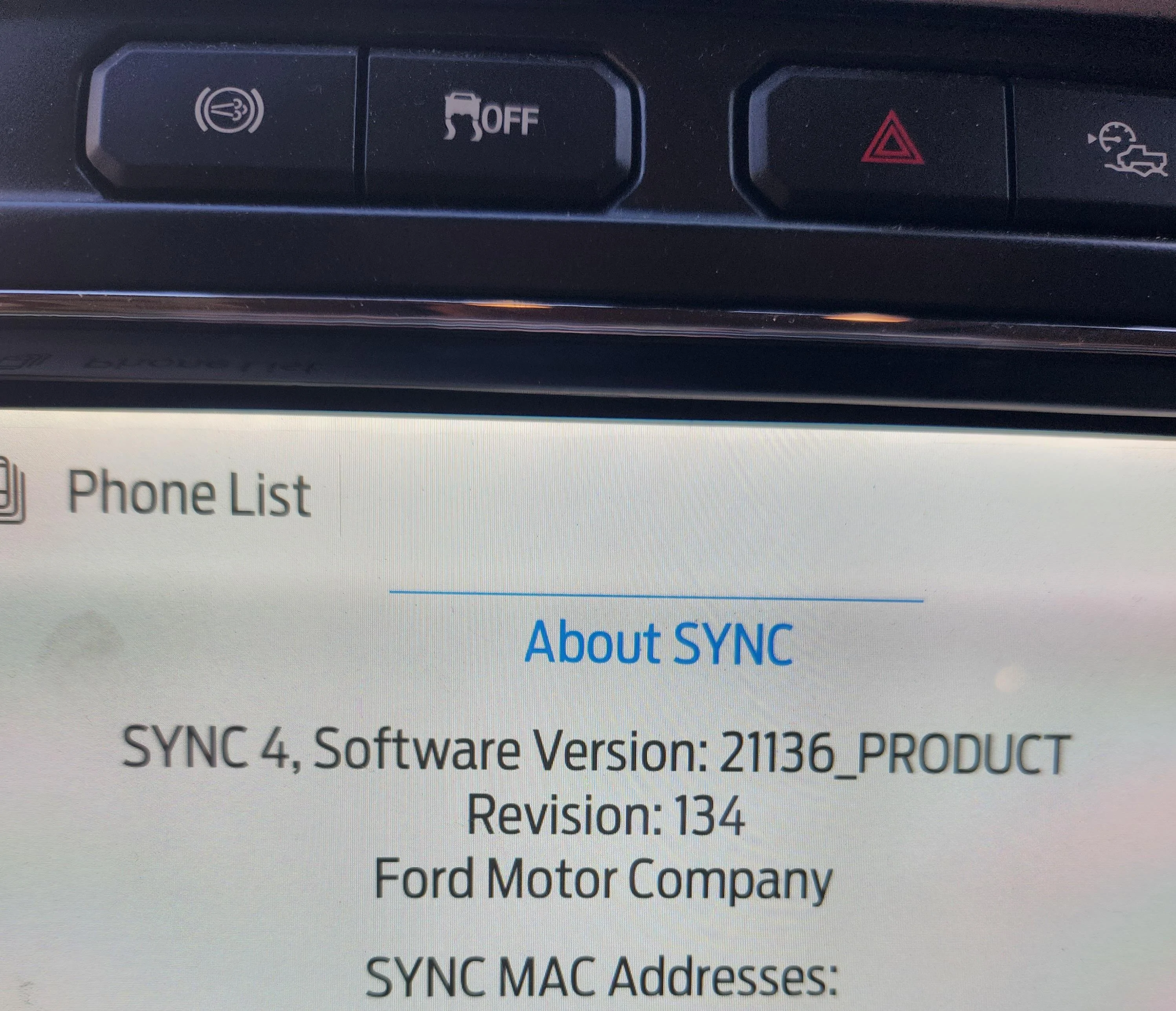

I think some of us 2022 Super Duty guys are in the same boat with not receiving OTA's either. I am stuck on revision 134. Some people have gotten 352 and 354 and are getting revision 610 now.
Can you look to see if we have the same problem? I know we have a slightly modified version of Sync 4 since Ford didn't update everything.
VIN: 1FT8W2BT5NED32076

I am not very familiar with the OTA process on the Super Duties, but I think they are very similar to the F150. All I can tell you is that your truck has not gotten an OTA since it was built.

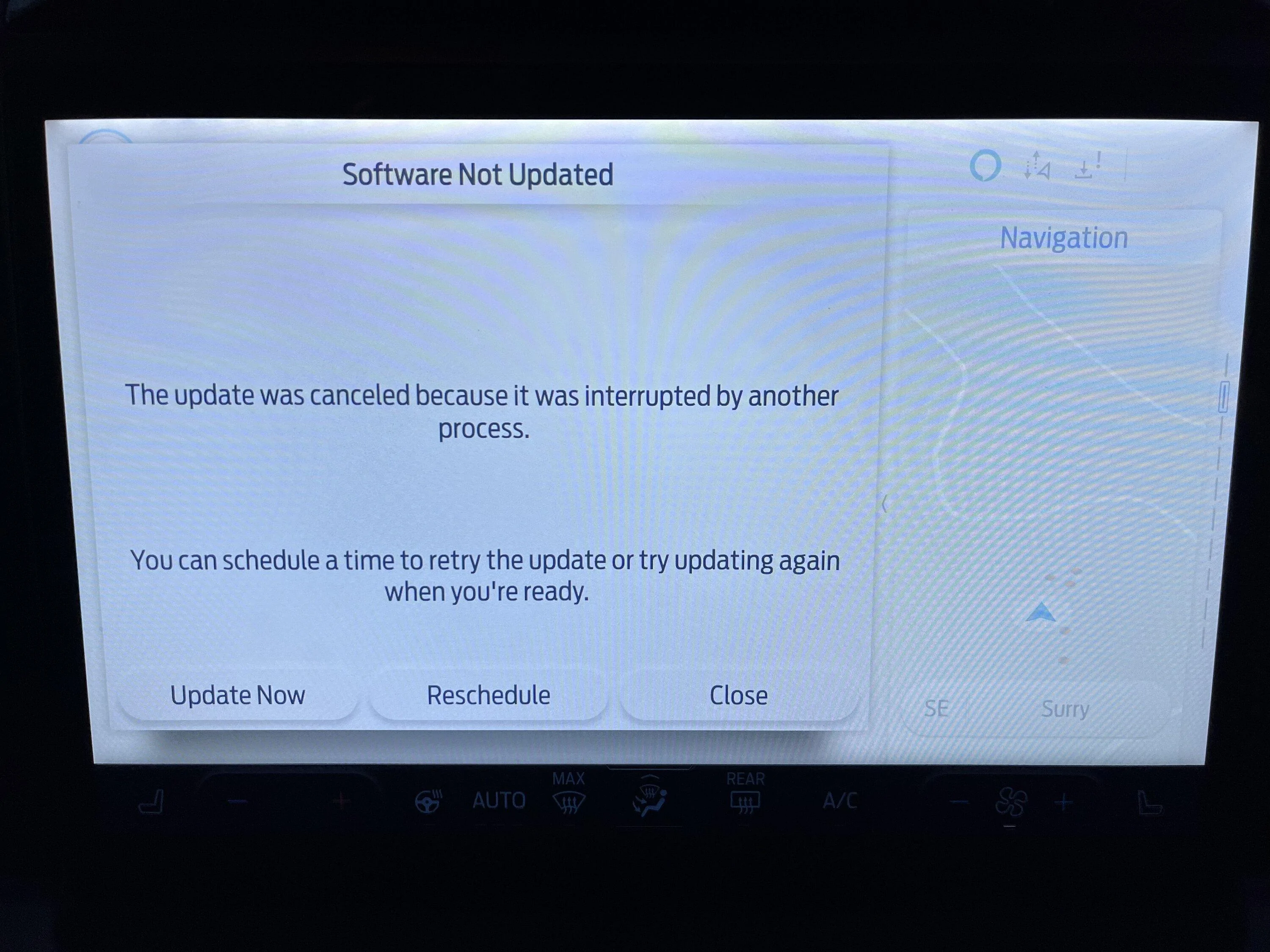

When you get a free chance, can you run my VIN please. No rush or anything. I'm sure i have some FDRS updates but i'm mainly concerned about an OTA that seems to be stuck or not happening.
i shows up on my Sync screen with an exclamation point. when i click it, it asked if i wanted to install now and a couple other options maybe schedule...when i click install now, nothing happens.

it says there was an interruption and action is needed and it ask if i want to "update now" or...there was another option or two. anyway, when i click update now, nothing happens.
its been there since 3/2. i figured maybe it was time to ask someone with better access than me haha

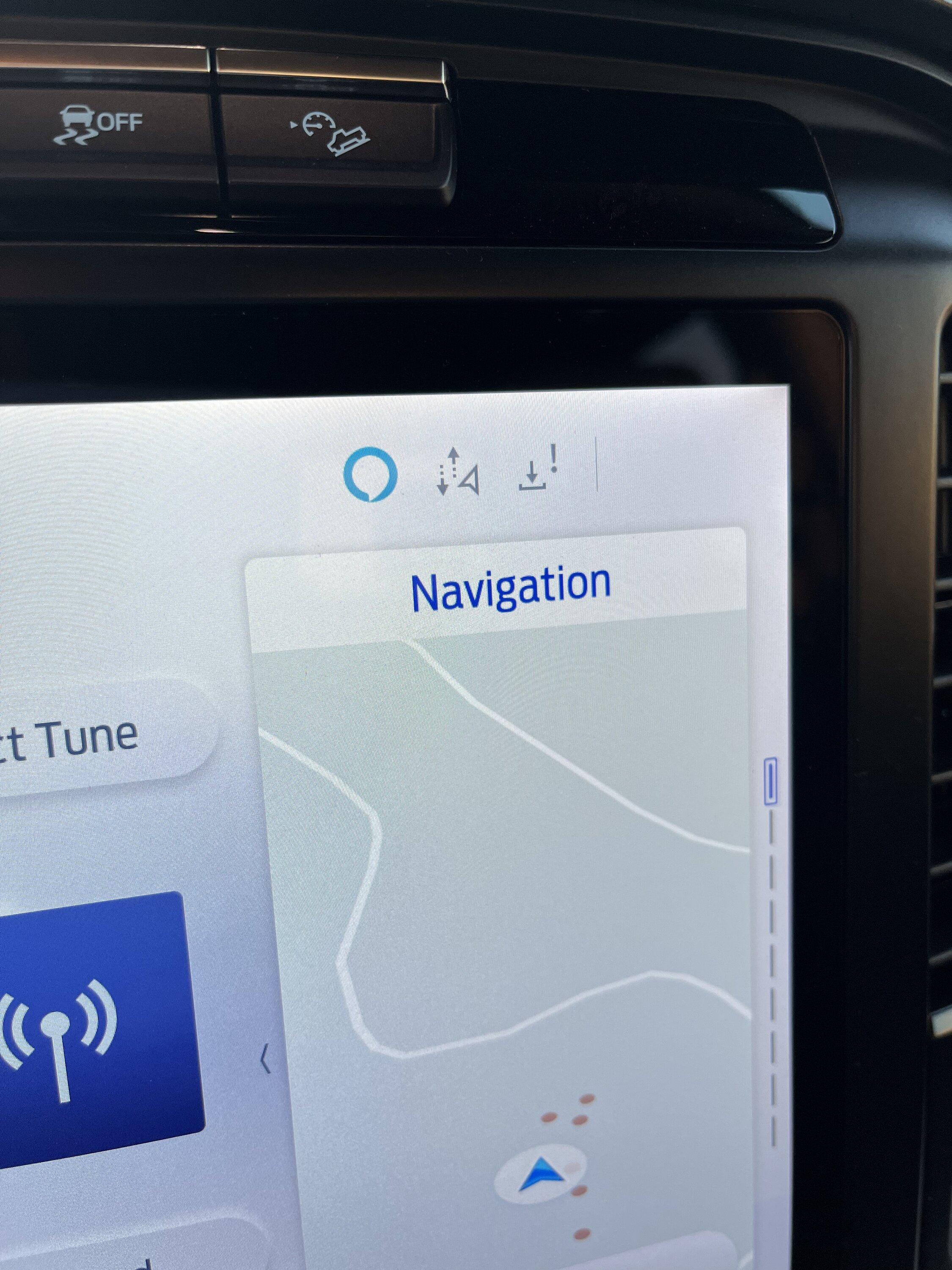

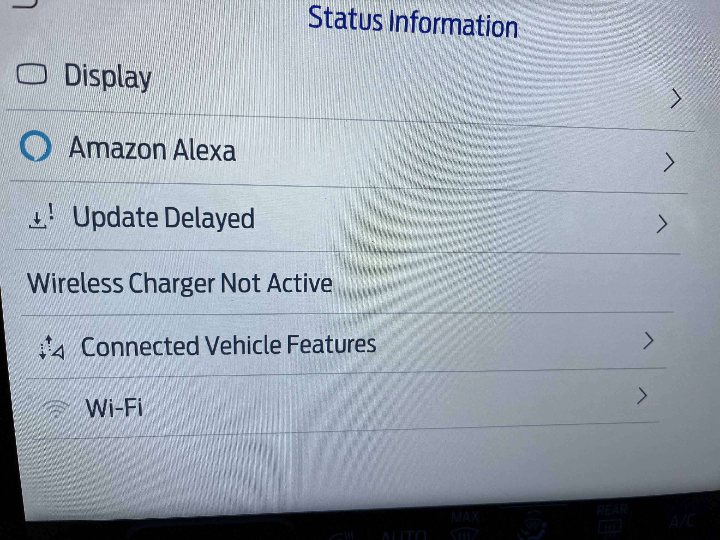

@rugedraw
This is what I’m showing still this morning…btw how to do reboot the radio without forscan?! Haha
Ford F-150 OTA Update Frustrations B339E1AA-E2AE-4BD4-A39E-506B31FC88AE
Ford F-150 OTA Update Frustrations 9CC426C2-9AE3-44ED-8542-D4B584FD7898
Ford F-150 OTA Update Frustrations DAAAF95A-714B-4967-AE9D-FE06087FB62D
