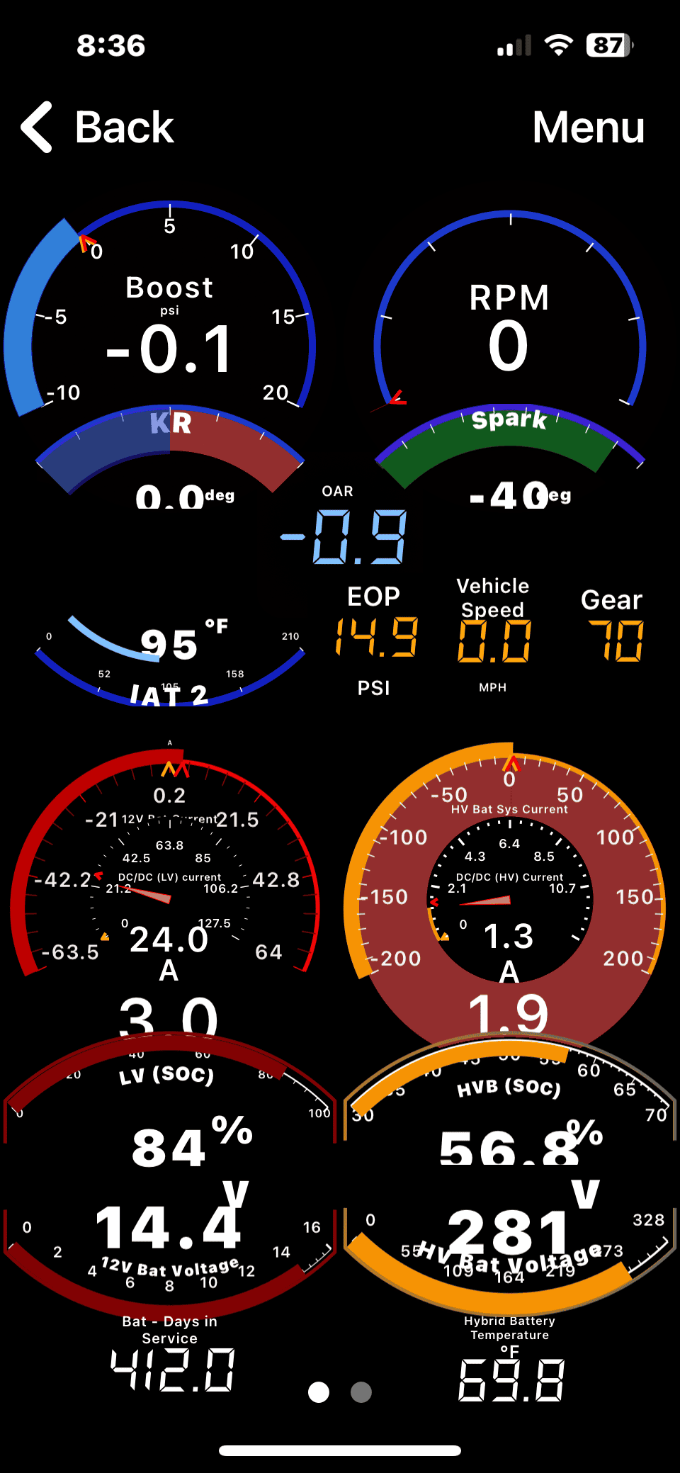

Well, I found some time and figured out how to import files from the forum, change the extension, and place them in the correct folder. Now I just need to move the “furniture” around to my liking.
Ford F-150 OBDLinkMX+ IMG_2208

Page 2
Ford F-150 OBDLinkMX+ IMG_2209
