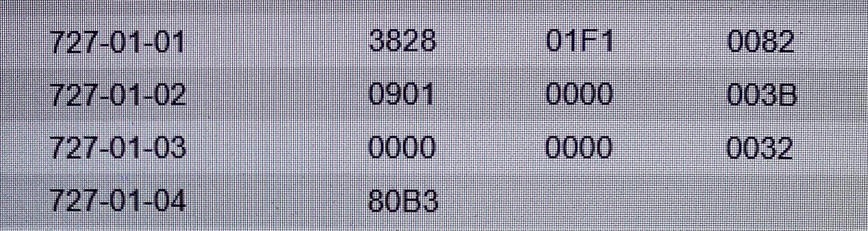

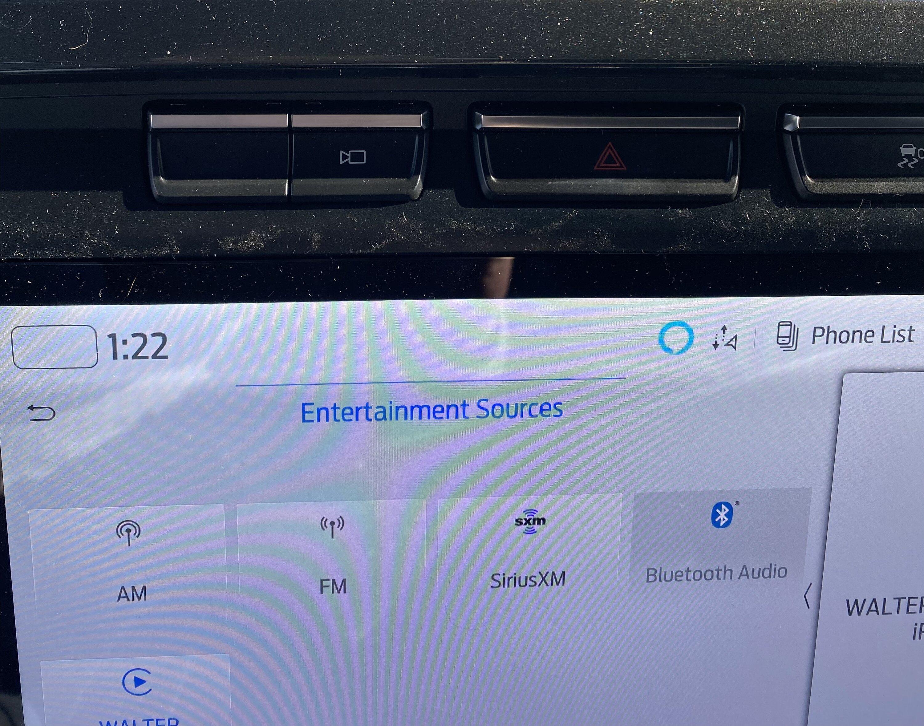

Maybe a dumb question but when I look at the antenna PN that looks just like the covers that are on the roof now on each side. Are the ones there now just dummy covers with nothing in them?You only need the splitter if you want nav and satellite radio. If only adding Sirius, you need the ACM, a female to female curry colored FAKRA (or one labeled universal) adapter at least 15” long, and antenna LC3Z-19A390-F for the passenger side.
