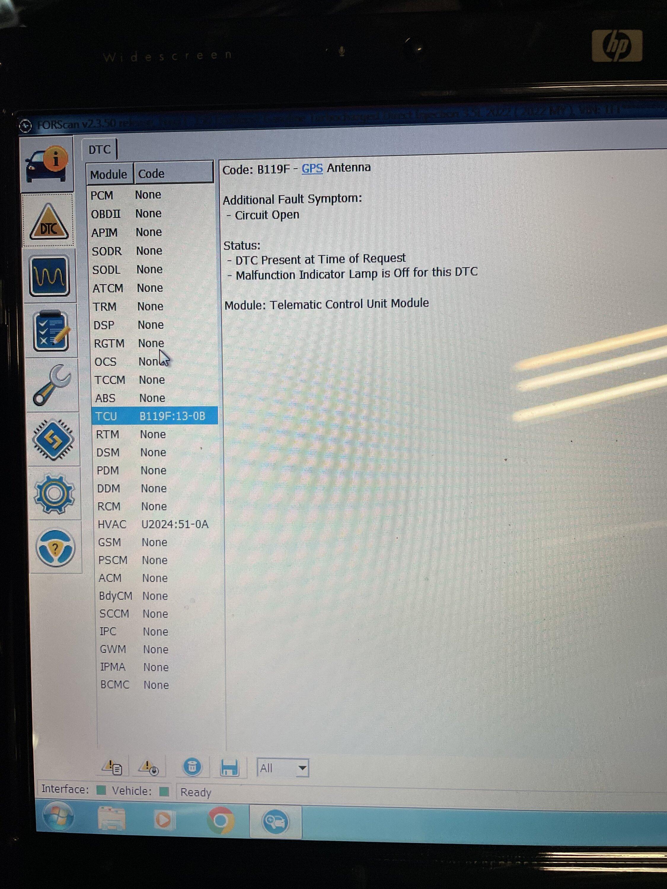

Have you checked to see if you have an open circuit silent DTC in the TCU? If so, that Forscan change above should fix that.

I was unable to write to my tcu, can you write to yours? I get a service error?? However even with the error my ford pass is working and updating.

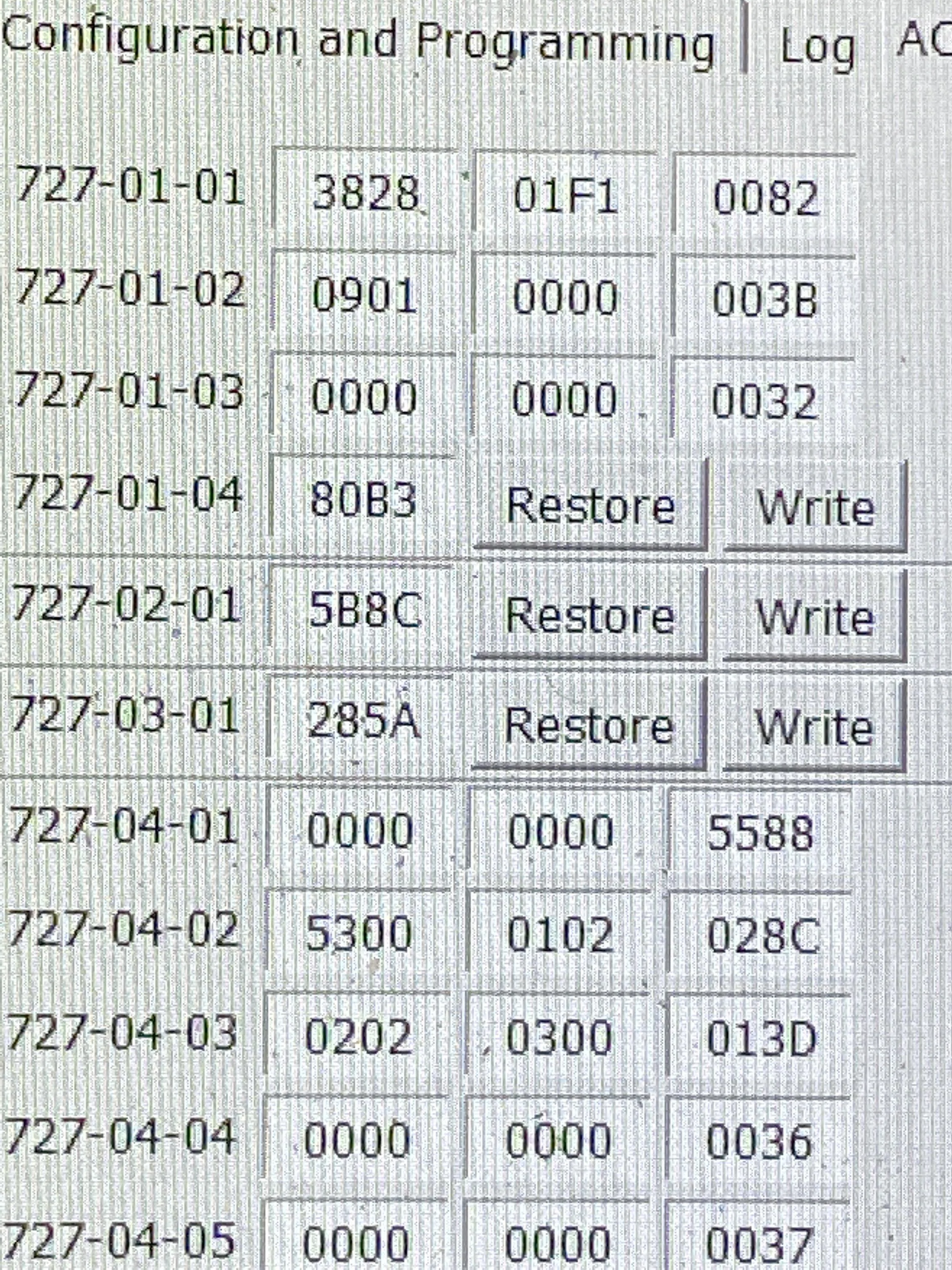

Did not have time till today to mess with it, a big thanks to XLT22 for your guidance. Changing the B to a 3 worked in my case. Being new with Forscan and not owning a ford since a 1998 Windstar has me moving with caution.

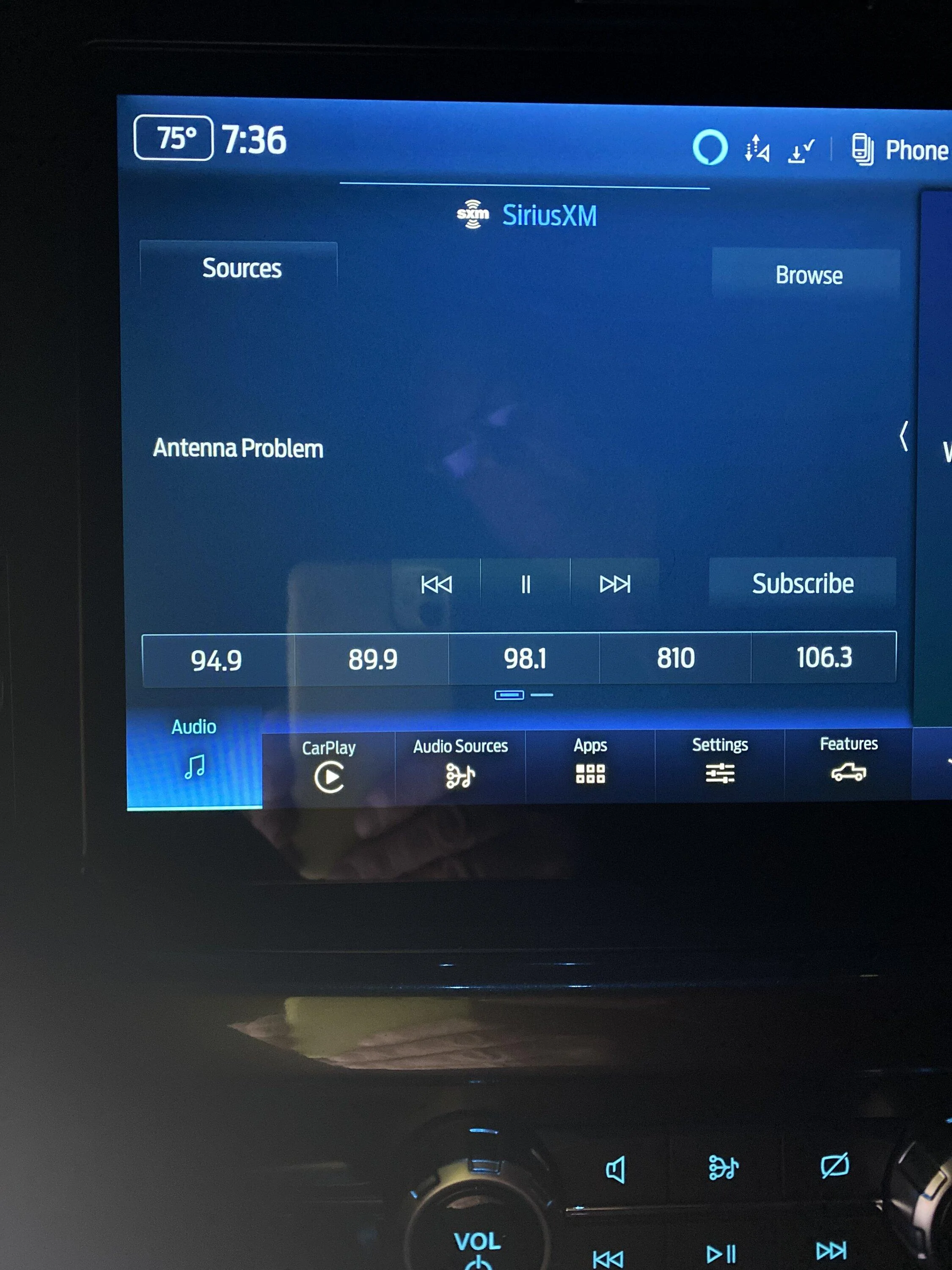

Not yet, no antenna so therefore the message "Antenna Problem".
Wanting to verify that by removing the blue plug from a non-XM antenna (with Blue and Burgundy Plugs) and going with a XM antenna (Burgundy and Blue Plugs) I won't loose any functions.
Saw the above.
While writing to the ACM I checked and had no issue getting into the TCU using version 2.3.5, I did not attempt to make any changes though.

Saw the above.
I can read mine. But when I write I get a service procedure interrupted and then a failure notice (something like that).
that is what i thought you were stating just was not 100% sure.
Beginning to think the issue was not the lack of ACMs, but a lack of Navigation units. The XM delete was just collateral damage.
This been covered. The onlything that happens is you’ll lose the GPS accuracy in FordPass and default to coarse cell based location. You can fix that by adding a navigation capable APIM but it’s not necessary. The new antenna will have curry/burgundy plugs.

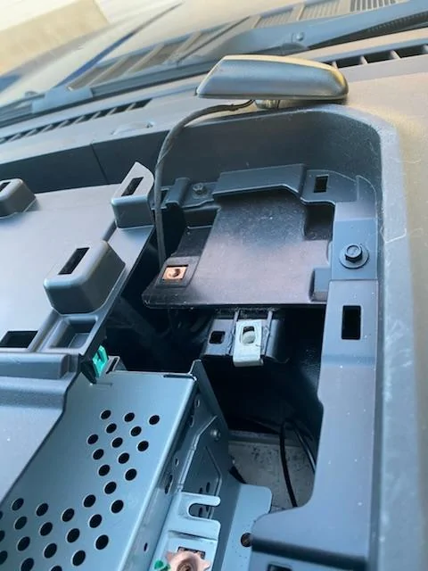

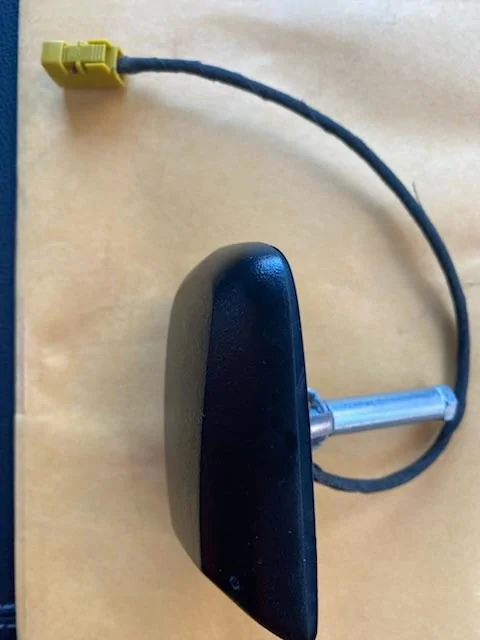

Ok up and running for now. Stopped at a pick and pull yard 3 minutes from my house
Yeah it is in a weird location it is now surrounded by high end homes and a country club golf course.
Pulled an xm antenna from a 2011 Grand Caravan this is fairly small, about 2”x3”, cost me 3$ including tax. It has a 8” lead so just long enough.
Plugged her in and up and running on preview!
I am going to test drive with it and see how it does, I know what areas of town gave me some issues from my old truck. So may still go with the ford roof top if this does worse

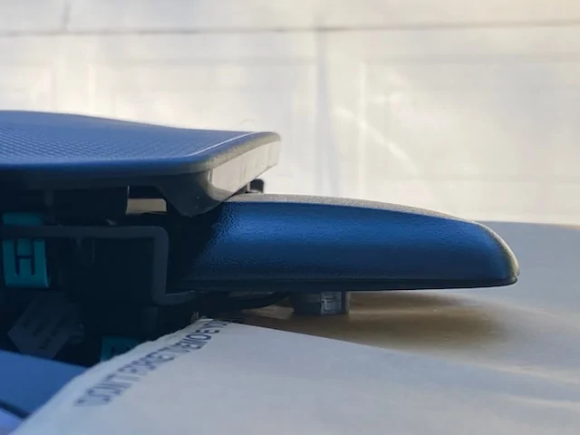

It is so small that It looks like it could live under the center speaker grill trim to the right of the speaker. Under the deck the center speaker is attached to, is a plastic bracket which leaves no room for a bolt. Drill a hole in the right spot for the base and some good double stick tape or command hook refills and adhere it there may just be enough room to work.
This will avoid dash clutter.
