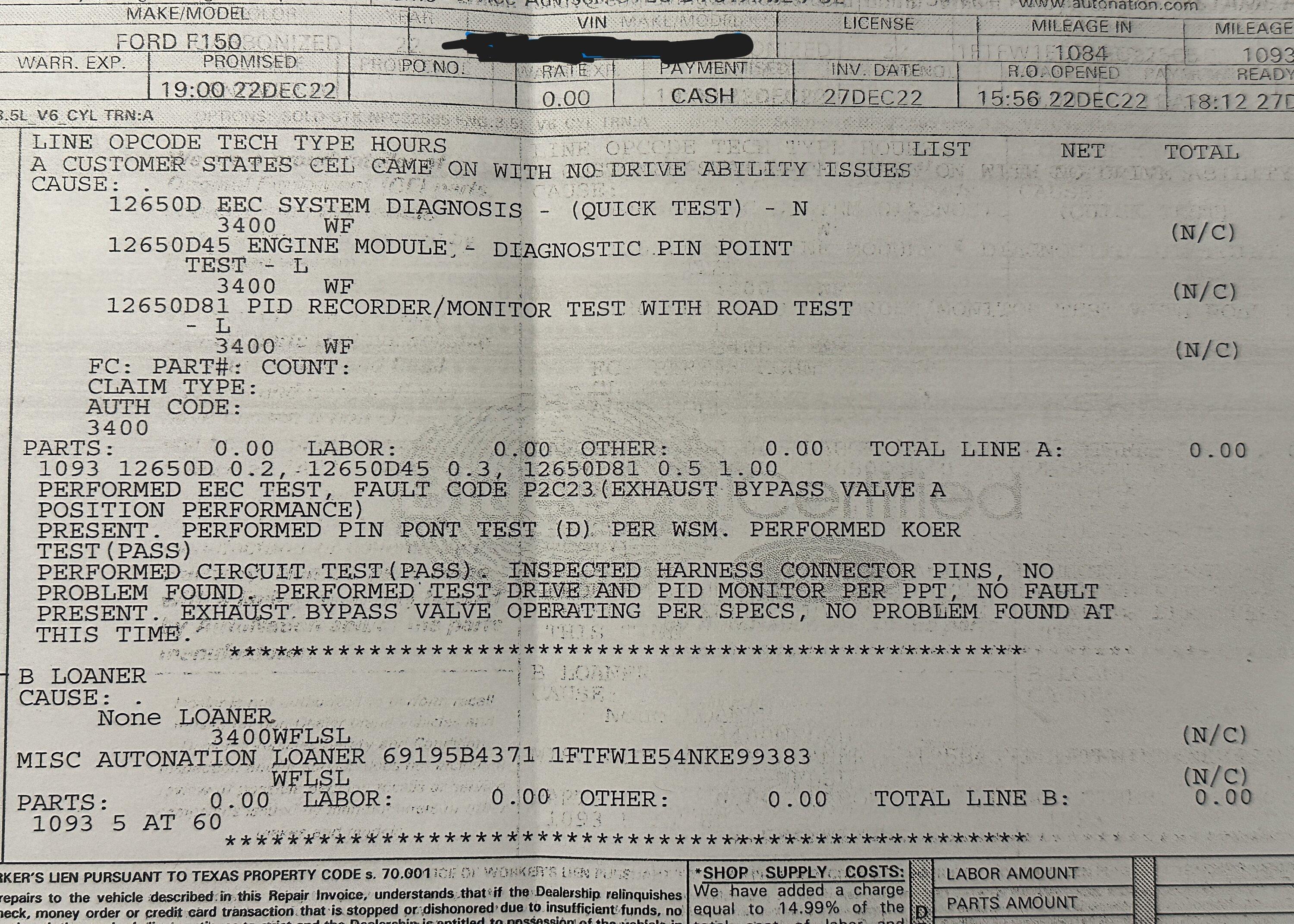

Ha, good question, I drove it up to the dealership and the sweet young lady hooked up a code reader while we were waiting for a loaner and the code back back inconclusive; or something like "CODE NOT DEFINED".
What was interesting was "it seemed the code was only coming up in ECO Mode" When she started the truck up in NORMAL Mode, we didn't see the code.

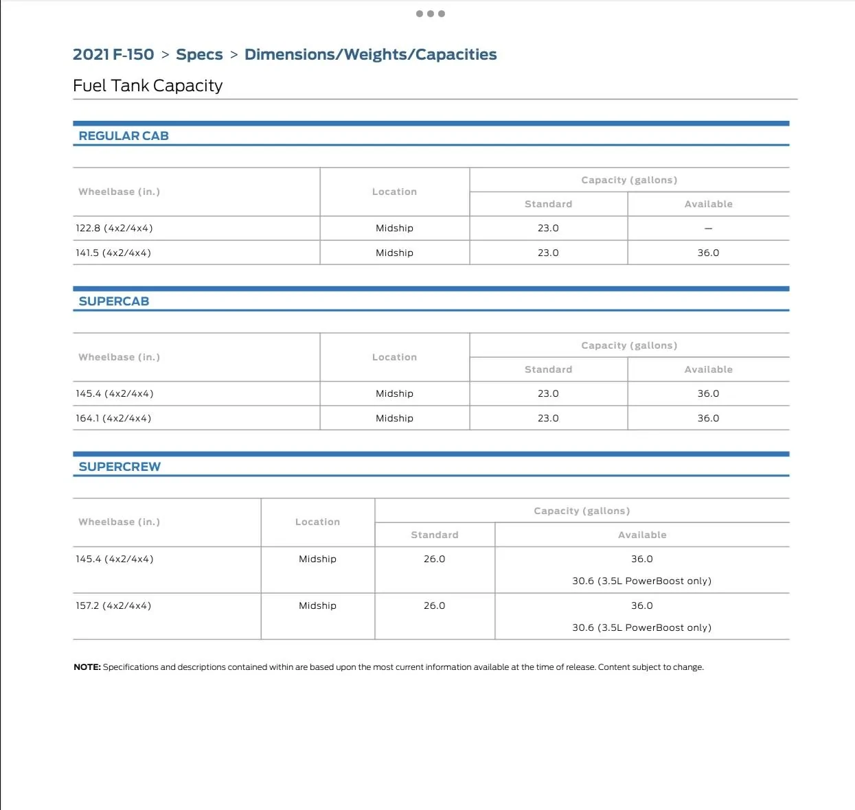

"Extended Range 36 Gallon Fuel Tank (NA 122” WB, or 3.5L PowerBoost Full Hybrid V6 Engine (99D))"
This quote is from the 2022 F150 Order Guide
I'm looking for other references. This is one of the reasons I did not Max Tow when I ordered my 2022 PB. There weren't enough goodies to justify another $1K.

This quote is from the 2021 F150 brochure which is little changed for 2022. I hate being the bearer of bad news.
One thing I have figured out over the years. I know more about the truck I want than the salesman does.
"Max. Trailer Tow Package1 (required for towing up to 14,000 lbs.; requires 5.0L, 3.5L EcoBoost, 3.0L Power Stroke® or 3.5L PowerBoost®): 3.55 electronic-locking rear axle (3.73 with Heavy-Duty Payload Package), Class IV trailer hitch receiver, 4-pin/7-pin wiring harness, Smart Trailer Tow Connector, trailer brake controller, 36-gallon fuel tank (not available with diesel or hybrid engines), upgraded rear bumper, and trailer hookup lamp; also includes Pro Trailer Backup Assist on XLT, LARIAT, KING RANCH and PLATINUM>

The max tow on the PB swaps out the rear axles for ones that break off their bolts. No benefit on the powerboost as it's already got pretty much all of the upgrades. You want the longer wheelbase if anything.
To be more correct, Max Tow swaps out the regular axle for the 3/4 Floating Axle, pn any truck, not just PB.

If it makes you feel any better, my 2018 3.5 KingRanch Ecoboost with a 36 gallon tank had almost exactly the same range as my 2022 KingRanch Powerboost with a 30 gallon tank.
So when someone asks me how much more efficient is my Powerboost, I tell them about 6 gallons worth. :)

Albeit late, as promised here's a picture of the ticket used to pull codes on the check engine light at 1041 miles.
Ford F-150 My mistake :( ...need help selling New Truck revisedf150a
