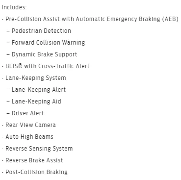

The 360 Assist package does not get front sensors. Only the 360 Active package gets the front sensors. If you have all these features, you do have the Assist package installed.
My 2021 has the Assist, no front sensors.
I've had the forward collision warning come up before, but never felt it brake...so not sure I'd ever rely on that...It does require you to connect the trailer harness, otherwise the system will see the tongue while backing up and slam on the brakes...FYI
