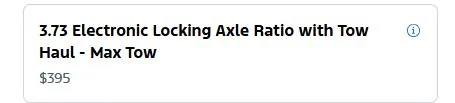

I am wondering what the "Max Tow" option for $395 really adds (screenshot below)?
The description from Ford is not very conclusive, and I haven't found a clear answer either using the search function of the forum.
Does it increase the GVWR/payload and/or towing capacity rating, especially for the powerboost?
Any other reason to pay or not pay for it?
Thanks much!
When this is highlighted and added your costs have just skyrocketed because it must have the 3.5EB, 5.0 or 3.5PB, 20" tires. The example is a XLT to show how much it can cost.
Ford F-150 Max Tow Option, $395 1741102426044-u1

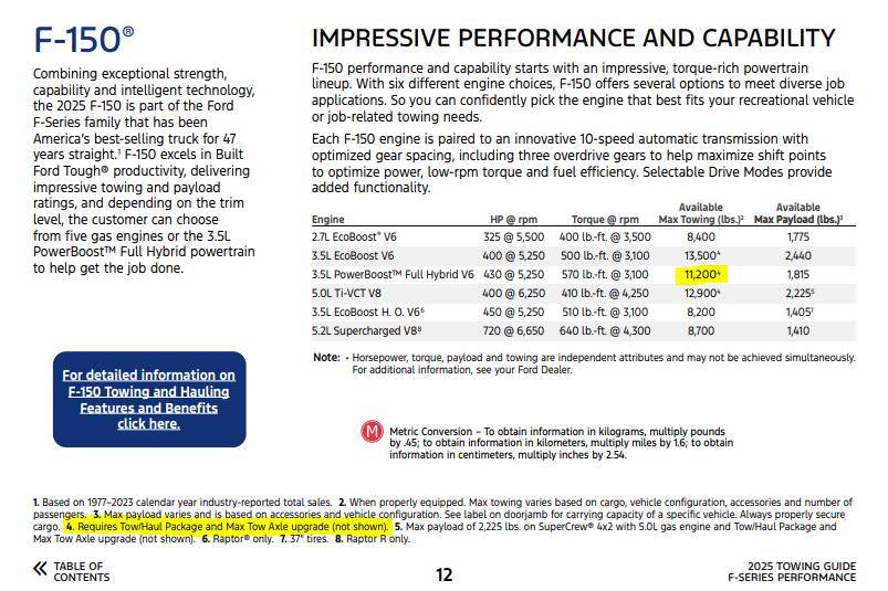

GODZILLA
Oct 30, 2024
54
WY
Previously 2024 F150 XLT 5.0 V8, went back to a Toyota
Thanks much!
According to Ford's towing guide the Max Tow axle is required for the full tow rating of 11,200 for the PowerBoost.
It doesn't specifically mention the payload for the PB, but it does state that the max tow axle is required for the max payload under the #5 note, so it would make sense that it boosts payload.
Ford F-150 Max Tow Option, $395 1741257690826-e7
Davexxxx
Mar 25, 2023
82
1,822
1,912
MO
Except it doesn't. Or didn't anyway. As I recall, it cost 20lbs. of payload. The heavier hitch and bumper brackets did increase towing capacity but at the expense of payload.
And for 25, for the PB, it only gets you an additional 400lbs. of trailer weight. 200 if a long bed.
Pg. 17.
