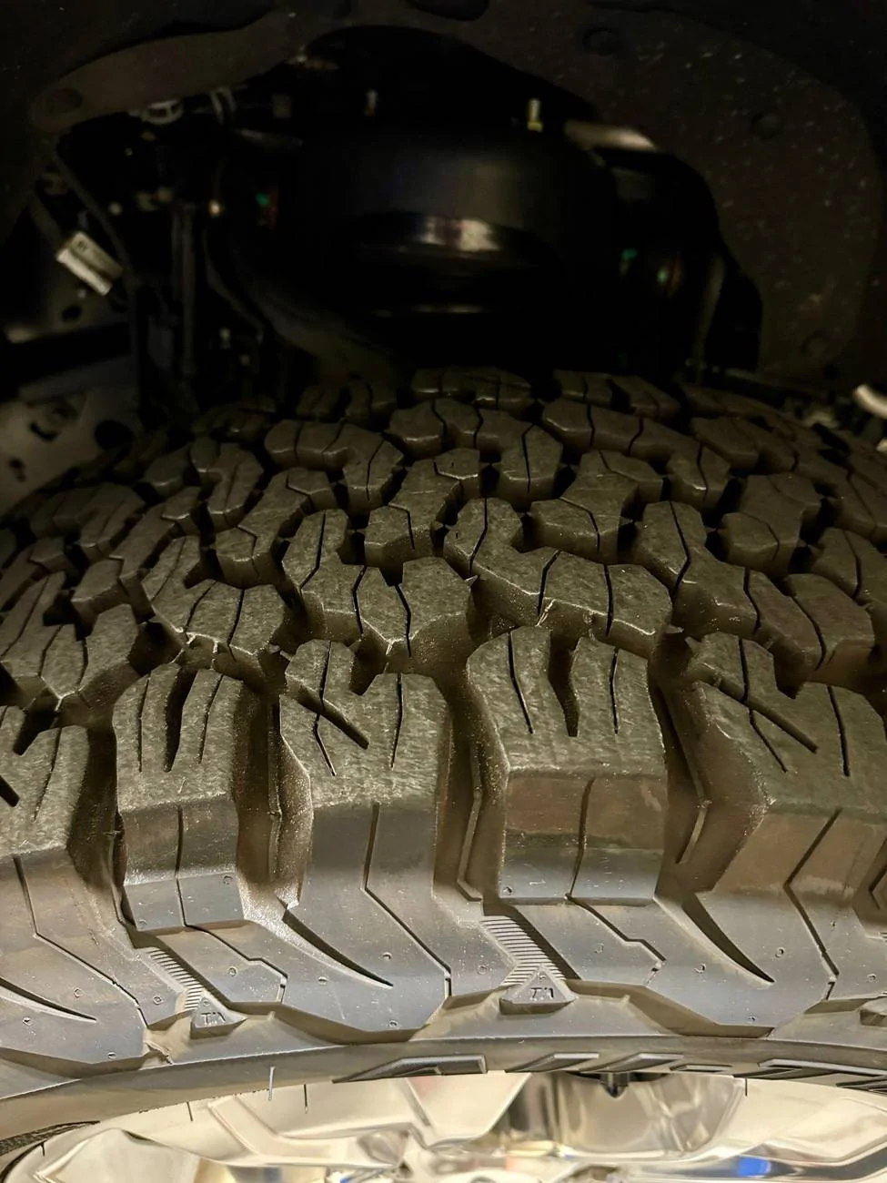

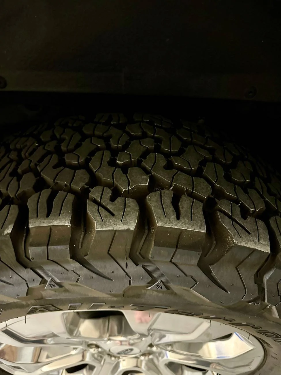

Here’s the chalk test, first picture is the front tire and it looks like I got that dialed in. The second picture is the rear and it’s close, but I may try a lower pressure on those. I don’t know if I want to deal with all that though so I may just leave it like this for a while.

Yeah, I would expect the rears to need less pressure (unloaded) than the front.
I run 41f 39r unloaded. PIggyboost is pretty heavy. If you compare other trucks w/ LT tires and their weights/pressures against the weight charts, you'll see much higher pressures with warnings about LT tires needing more air pressure. Given the number of lighter trucks / jeeps running even less pressure and no issues, appears okay. Another thing to look at is the witness marks on the front tires to see if they're rolling under in turns.

If I drop the rears I was thinking 2 psi like yours. I bought a measuring tool today and everywhere I measure is within 1/32” so no abnormal wear, and that has been at 38 psi for a few thousand miles. I’m going to try 36 for a while because the chalk test showed that may be better, but I’ll track the inside and outside wear with that tool and see how it goes.
