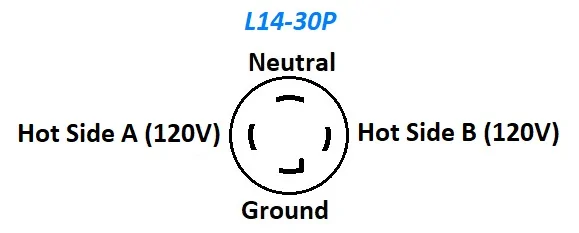

GENERAL
Ford F-150 Looking for Recommendations on 30amp 240v adapter L14-30P_Diagram
This is the L14-30P connector that plugs into the the ProPower 240V outlet, with the 4 pins identified.​
Notice there are 2 hot pins, with 120V on each (120V + 120V = 240V).​

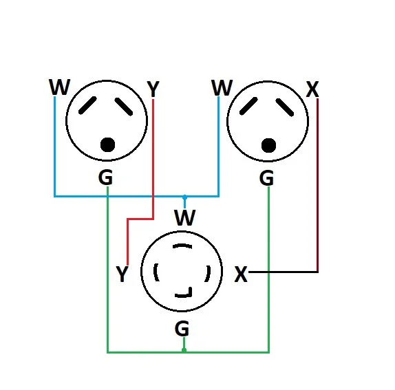

PARKWORLD 60646 SPECIFIC
Using a multimeter, I determined which pins of the L14-30P connector are wired to which sockets of the two TT-30Rs. This is what I found:
Ford F-150 Looking for Recommendations on 30amp 240v adapter L14-30P_to_TT-30R_Diagram_Hack
G - Ground wire (green)​
W - Neutral wire (blue)​
X - HOT wire 120V - Side A (dark red)​
Y - HOT wire 120V - Side B (red)​
The ground wire (G) connects to ground on both of the TT-30Rs.​
The neutral wire (W) connects to neutral on both of the TT-30Rs.​
The hot wire 120V - Side A (X) only connects to the TT-30R on the right.​
The hot wire 120V - Side B (Y) only connects to the TT-30R on the left.​
The above diagram shows how my Parkworld 60646 will use both sides from the ProPower (A & B) - with the A side powering one TT-30R and the B side powering the other TT-30R.
No need to connect to the truck to know, as the power has to follow the wires.
However, I will gladly double-check it works this way the next time I go out to storage for a well-being visit of our trailer. Assuming I remember the splitter. ?
Lastly, if I am missing something or have something wrong, correction is always appreciated.
-Eric
-Eric
I do know all of this. I am only sharing with you my personal experience. I read the same specs you did. I purchased the same adapter from the same manufacturer. It did not function the way I expected it to, the specs notwithstanding. Maybe I got a bad one. Maybe Parkworld redesigned it in the year between when I purchased mine and you purchased yours. Maybe Parkworld actually meant what they said when they called it a “splitter” (one source split between two destinations). All I’m saying is that it didn’t tap both circuits, and I was able to verify it by monitoring circuit loads and found that “A” was never loaded
An easier way to test this if you don’t feel like going to the storage locker is to get a 30A to 15A adapter and plug that into the 30A ends. They’re relatively easy to come by. I’ve even seen them on the rack at Walmart. Then you can use any household current device, like a blow dryer or a power drill, to put a load on each end and test which circuit is supplying the power.
EDIT: The one scenario not in your schematic is the one I experienced. The adapter was actually a pure splitter. One of the hot pins on the generator plug (“X”) was dead and served only as a place holder to orient the plug. The live one (the ”Y”) was split and ran to both female ends. If you were able to verify continuity that Y ran to Y and X ran to X then you actually managed to find one of the few adapters on the market that does this and Parkworld may have noted their earlier error and redesigned it. Most of the ones I tested, including the Parkworld, had Y on the generator plug (I pick “Y” somewhat arbitrarily because almost all of the adapters I tested, including the Parkworld, tapped the “B” circuit not the “A” circuit) running to X and Y on the female ends and are essentially useless. But I would love to know for sure if Parkworld did fix this. If they did, I’ll buy one and dump the more elaborate two-adapter set up I currently use to tap both circuits.
