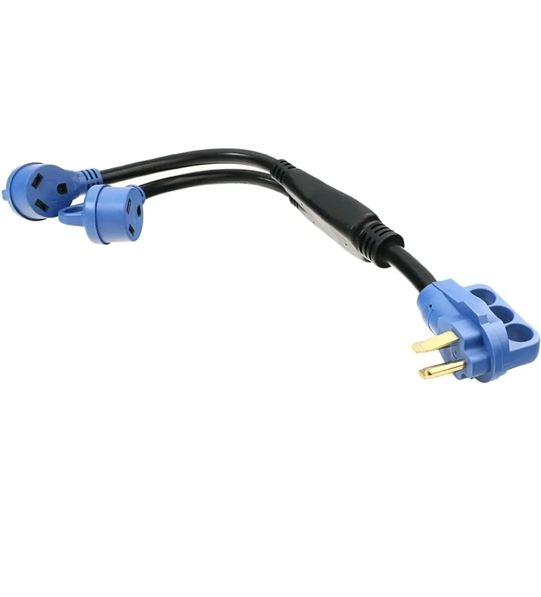

I purchased this back in 2021 from Amazon
Ford F-150 Looking for Recommendations on 30amp 240v adapter Screenshot_20230928_152210_Amazon Shopping
I use it to either run my brother's 50Amp RV, as well as verified I can charge my EV at as much as 28Amps 240V (level 2 charging)
To run my 30Amp RV, I use this connected to the one above: (Ebay)
Ford F-150 Looking for Recommendations on 30amp 240v adapter Screenshot_20230928_152430_eBay
It definitely taps both banks, so I could run 2 30Amp RV's simultaneously.
I guess I am at full circle now. That is exactly the same set up I use that I posted above. Only the color of the 50a to 30a splitter is different. The first adapter is the only one I’ve found that converts the generator outlet into some other format while preserving access to both phases.
