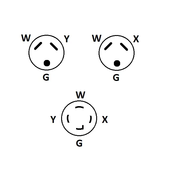

Today I remembered to test the pinout of my Parkworld 60646 with a multimeter and it seems correct to me:
Ford F-150 Looking for Recommendations on 30amp 240v adapter Parkworld_60646_Pinout
Parkworld 60646 on Amazon

I’d be curious to see the results of your testing. I bought this exact adapter two years ago and it tapped only one of the two phases, essentially splitting 3600 watts. So, I sent it back.
Your link shows that the adapter is rated for only 3750 watts. I suspect the problem might still be there.
From the Amazon listing:
  • AC power Splitter cord L14-30P to RV (2)TT-30R 125V/3750W Y Adapter cord, 3 Feet
So as I read this, the splitter gives you two TT-30R connections of 125V & 3750W each.
