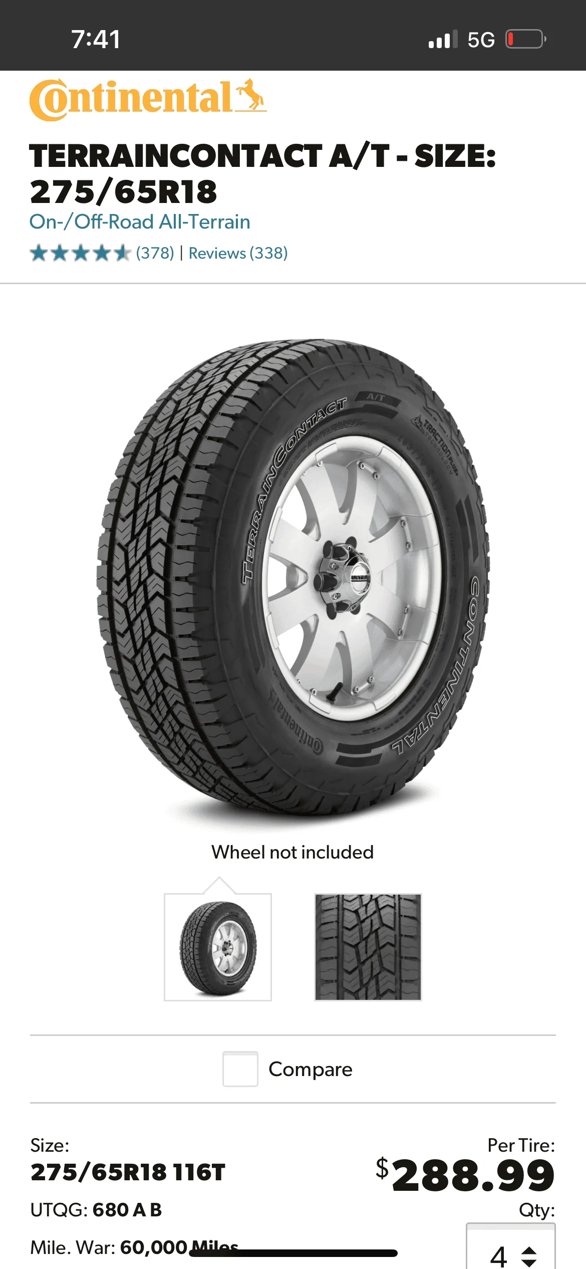

On my wife's 4Runner I've had the Falken Wildpeak AT3Ws and they became extremely loud after some mileage. Ended up getting rid of them and putting on the Continental TerrainContacts. They've been fantastic and super quiet. They're just not very aggressive. I plan on replacing my stock Hankooks with the Cooper AT3 4S here soon. They've got good reviews everywhere.
