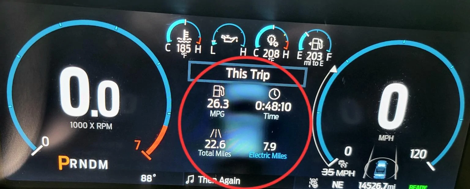

I lock out 9,10 every day on my commute. (46 mile round trip)
I do it to keep the truck from cruising at low RPM. (pretending what gear I would be in if it was a manual transmission and it was ME shifting)
In Normal mode the factory shift strategy will literally attempt to cruise at an RPM as low as 1200? Like riding a 10-speed bicycle at low speed but a tall gear.
There's a long stretch on my commute where the cruising speed is 55-60. I will unlock 9th if traffic is light. But not letting the truck have it's 3rd overdrive at that pace.
I monitor a lot of what is going on in the combustion chamber. If you have a digital Boost gauge and you change the range from 0-20psi to -5<>20 psi, you now have a vacuum gauge. :)
So when in cruise control, you can experiment with which gear is getting you the best fuel economy and least strain, so to speak. A vacuum gauge is an old school Normally Aspirated tool for things like that.
Notice below that at only 50mph, I have to lock out 10th. It's crazy. It's already cruising at only 1300 rpms, but it WILL try to use 10th in Normal mode.
And 8th gear IS already Overdrive.
Yesterday's trip from South Houston back to rural home. Summer temps, of course
How did you get the temps to show up in your guage cluster, specifically the transmission?
That's a Forscan edit if you have the higher trim IPC.
The Forscan gurus still haven't cracked the same on the XLT instrument cluster. Which is very disappointing. Why Ford would not include the possibility is strange considering they dropped the digital transmission temperature display from the Gen13.

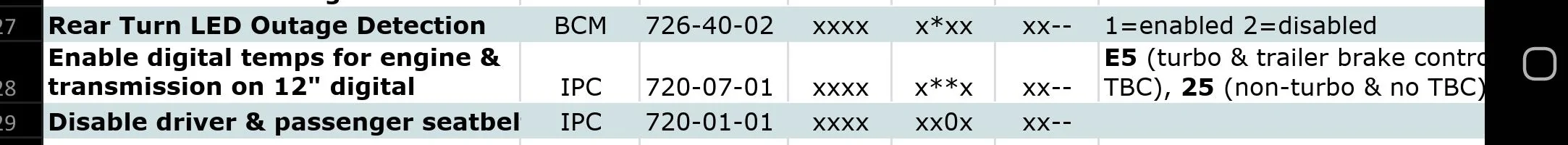

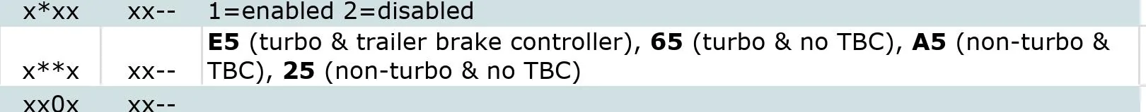

Anyone in SoCal with forscan to help me add the temp reading on my Lariat? I don't even have a windows based PC :(
"glass" might be an Aviation term. Sorry. I've worked for an Aviation company for 25 years. It rubs off. ?
Yes, I meant all digital.
Forscan edit to enable digital temps:
