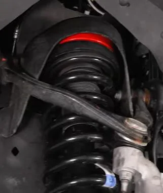

I believe pucks for the 14 gen are placed on top of the strut tower and previous gen’s were placed on top inside the strut tower. When placed inside the shock is compressed by the thickness of the puck. That means less movement and always under more load. When placed on top of the strut tower in Gen 14, you still have all the factory movement. At least this is the way I understand it but could be very wrong.
They mount inside the strut tower. If it were on top of the strut tower you would not gain any height.

I think he meant on top of the strut.
