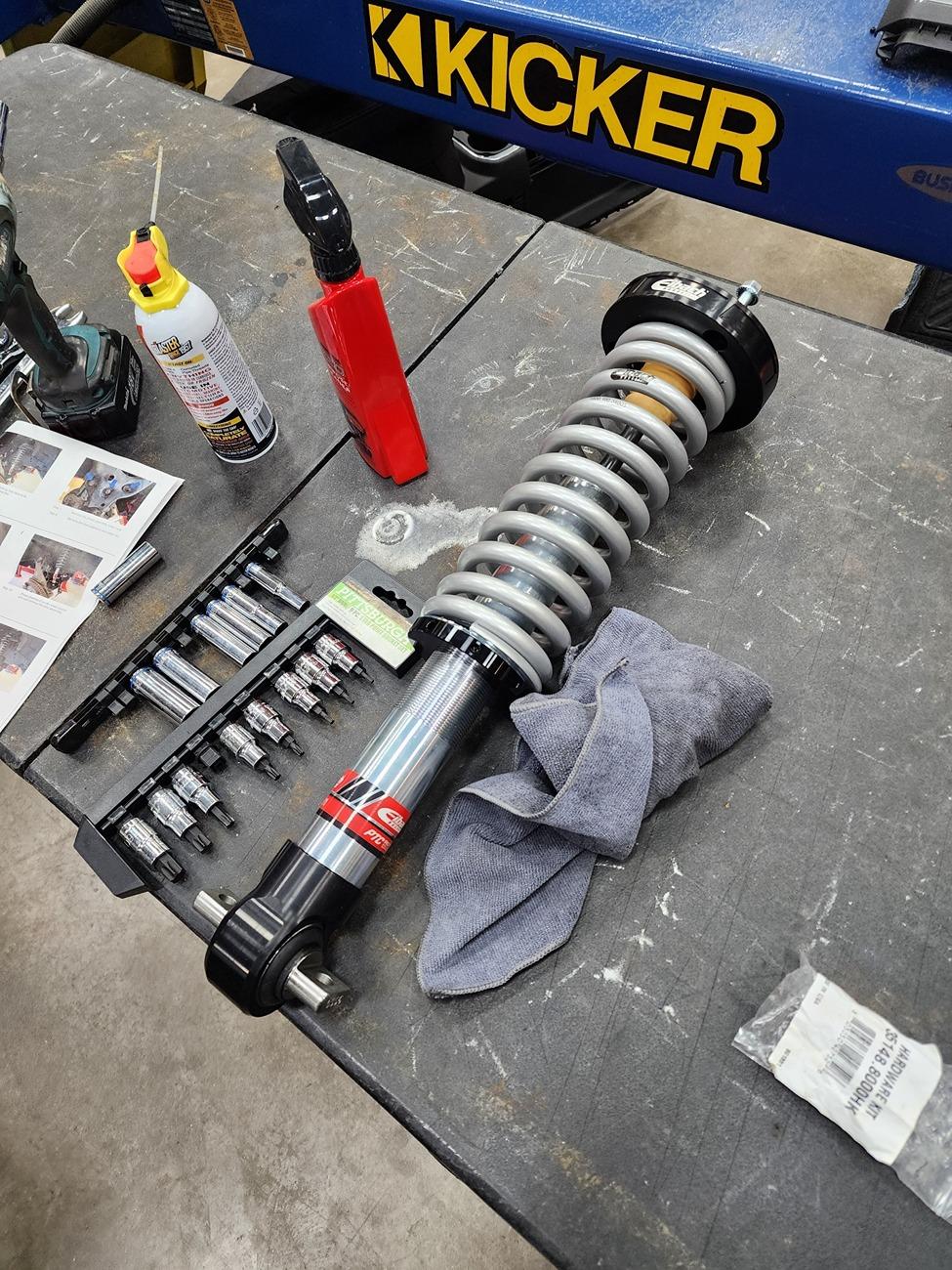

Ya, I want to stop the bouncing. We just came back from a 700 some mile (one way) to Yellowstone pulling our 19ft camper. I currently have the stock setup on a Stage 3 Motorsports 2.3" leveling kit. I have the long bed too which probably makes it worse.
The eibachs are calling your name, both the bilstien and eibach are good kits. I just prefer the eibachs due to adjustability on the truck and it’s a full coilover so it’s an easy install!!

For 5.0 and ecos they can be adjusted all the way to 3” in the front. So max I’d expect 2.5”-2.75”, it varies truck to truck. You can dial in the height on the truck with a spanner wrench!!

I did Eibach coil overs in the front (adjustable but set it to raise 2") and just replaced the shocks in the rear with Eibachs as well. Took away the bouncy ride and replaced it with a harsh ride. I'm sure the heavier tires (35x11.5) also contributed to the change. Loved the look, hated the ride. After much research and personal experimentation I have settled on the following conclusion:
If you want a lifted F150 that also rides like a dream on the road, you can spend many thousands on a custom adjustable suspension turned by a pro that MIGHT ride like you want... or just buy a Raptor.

Absolutely! Rides great, had the Fox 2.0's on the rear before, very solid when going over big bumps. I mean like a 2x4 was there instead of a shock. Ive had 2.0's before and were great. Maybe just this one. But the Eibach looks and rides amazing. Boss just got the complete set for his Tundra.
