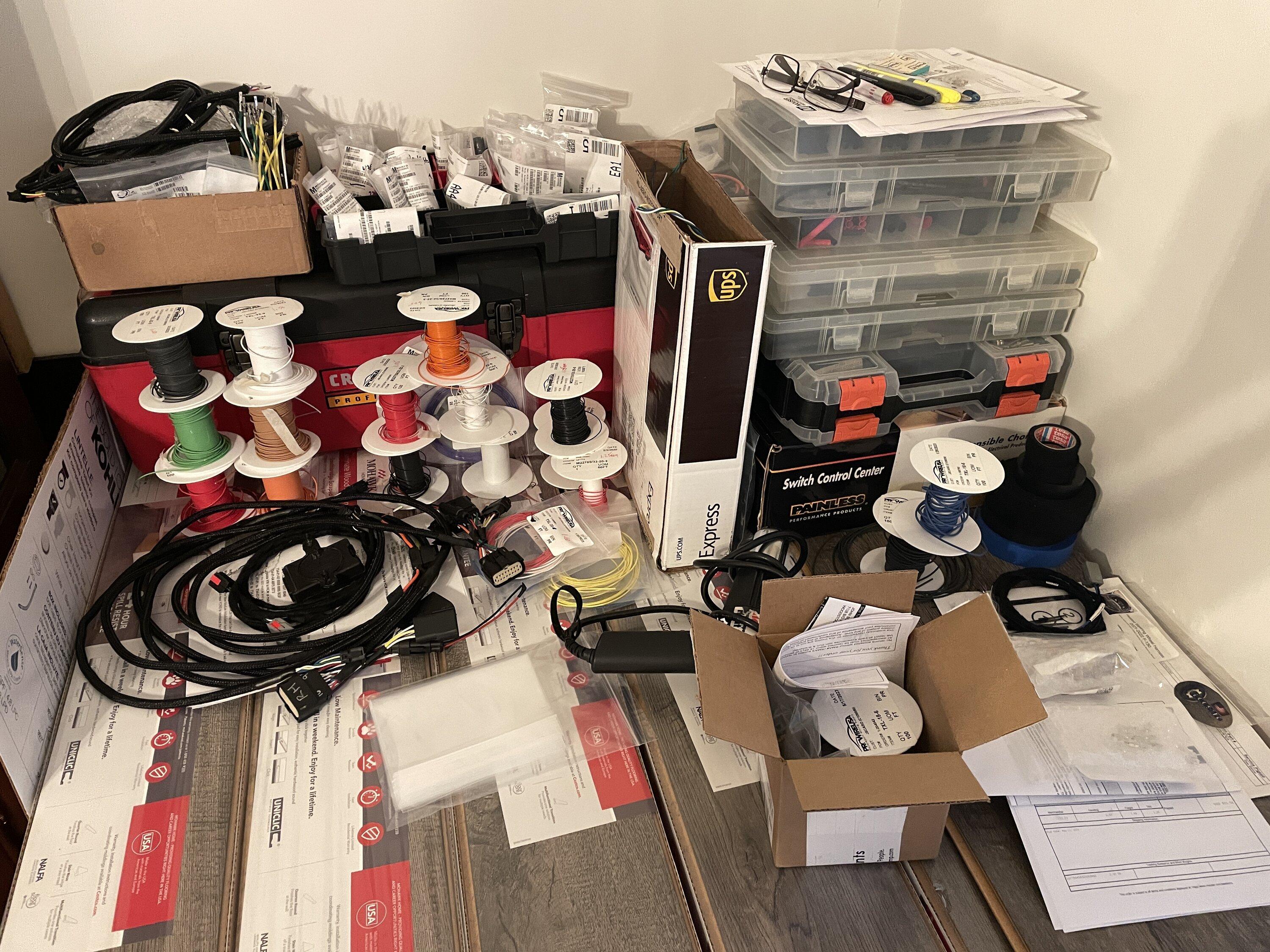

Much appreciated! Got everything in from Mouser today. Wire and HCM come tomorrow, so hopefully done this weekend.
No problem. I was hesitant to share since I wanted to make my own harness but I don’t have the time.
I have the parts and tools to make them so I might just sell kits for people that want to tackle it themselves. I’ll tell you thou, right tools, parts and wire make all the difference.

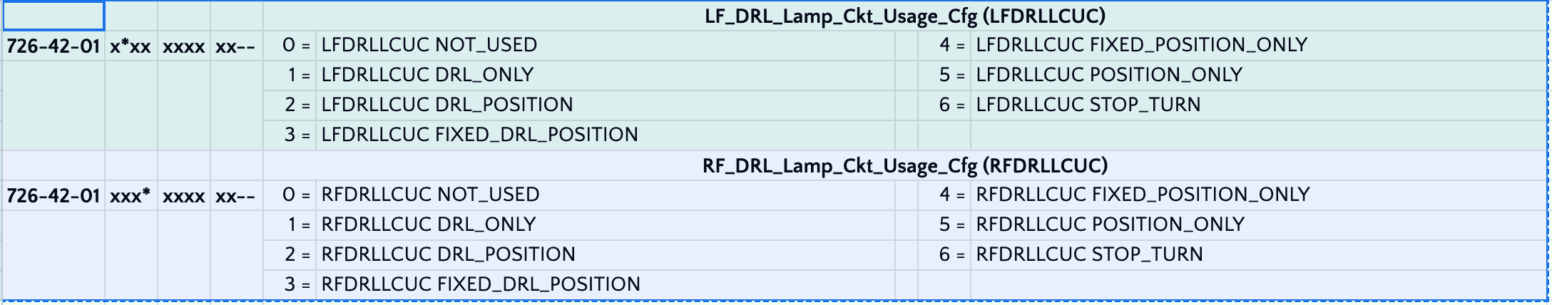

Sorry. Dumb Mac correcting my grammar by changing brake to break. lol. Here is the Forscan programming that has to do with the DRL and the turn signal:
Ford F-150 LED projector upgrades 1686067613004
Ford F-150 LED projector upgrades 1686067580110
Ford F-150 LED projector upgrades 1686067678145
Like John, I'm pretty well convinced you have a forscan setting funny. Would you share a backup of your truck's current settings with me? If you PM me the file, I can compare it to the changes I had to make for my raptor headlights to see where you're off
